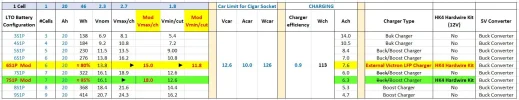

The LTO Battery pack can be built as little as in 3S1P configuration (just 3 cells, for 138Wh capacity) and up to your imagination.
I choose 7S1P configuration pack (322Wh total capacity) for the one main reason,
- To be able to support 12V system directly from the battery, without additional converters, to use unmodified original Dash Cam Hardwire cables, including original Viofo HK4 cable.
7S configuration minimum cut-off voltage is right within HK4 voltage regulator’s 11.8V-12.6V cut off range.
7S max charging voltage is about 19V, however HK4 voltage regulator is programmed to treat anything above 18V as 24V Battery and will cut off power at above 18V thinking “it is too low for 24V battery”.
For this reason, I limited max charging voltage to 18.06V (2.58V per cell), nevertheless, the Battery pack at 18V charges to 99% of rated capacity, when discharged by Dashcam's trickle power consumption!
6S1P configuration also can be used for 12V system, but with deeper voltage limitations, if standard LFP charger like "Victron" is used, or it will require combined Buck/Boost CV-CC converter, which I was unable to find at the time.

Here are the possible configurations I was evaluation:
