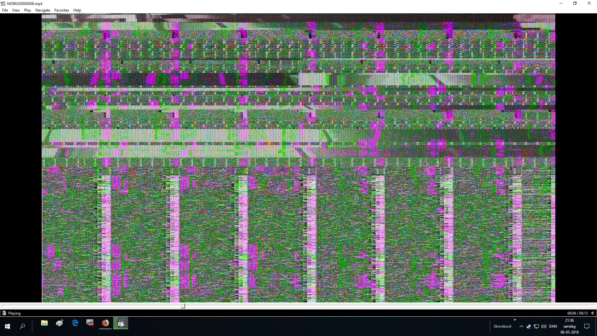

Footage now look like this.

Could be CMOS sensor fault.
yes. today it only recorded 60 seconds or so okay footage, then it change to this, for a few first seconds in every segment movement in the "picture" but then it change to static with this same look to it.

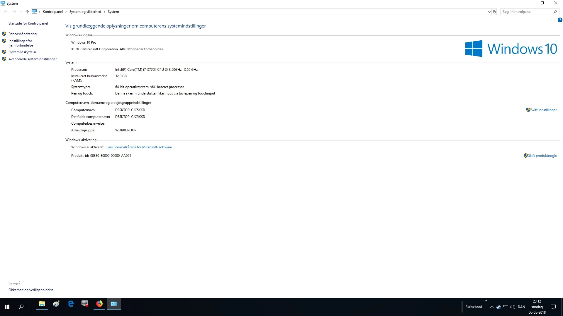

That frame gram was from a file on my desktop, on my PC it have never been a problem playing back from the M2 memory card in my card reader, not even H.265 files
And this should still suffice, though it is on a update path that will result in all but my DVD burner - case - keybord - pump - fans - radiator - mouse - headset - OS will change.
New comp = ryzen 2 - 2800x / 16 Gb ram ( to start with ) RX580 GFX card ( 8GB ) that is if my bank still want to play ball with me ;)

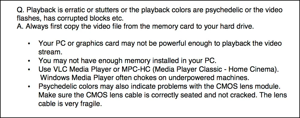

It's unlikely to be your pc. I have however, had experience of playback failure trying to stream from usb as usb is not always fast enough to handle HD vid streams depending on the data rate. Usually though, it manifests itself as lots of buffering or a refusal to play more than a corrupted stream although I suppose the difference might be the actual size of the bottleneck. The solution is to copy the file locally as mentioned above.
That said, this doesn't look like a streaming issue to me. Dashmallows suggestion of trying to re-seat the ribbon cable is a good one. Also, if there's any way to perform a factory reset on the camera either through a biro operated push button or though the connected software, then that might be worth a try.
