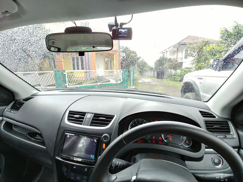

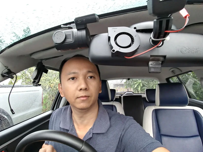

This is the followup regarding installing blower fan to cool down Mini 0906 dash cam.
Condition:
- Dash cam installed on windshield without dotted shade. The windshield has 3M Crystaline 20% film on it.
- Outside temp 31C (89F).
- Air conditioner set to 24.5C (76F) automatic climate control.
- Weather was cloudy.
- Using FIRMWARE_20171220_nolog from here.
- Video resolution 1080p30 + 720p30.
- Samsung EVO Plus 128gb.
The small blower fan is rated at 12V 0.06A. Without the fan the dash cam can reach 70C (158F). With the fan it only reach 60C (140F). The fan make a little noise when active, but it doesn't picked up by dash cam microphone.
p.s. the pic was taken during light rain, not during the test.
