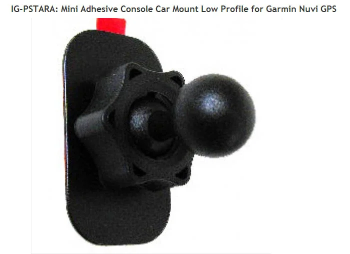

GARMIN MINI BALL MOUNT
The dashcam comes with a humongous suction-cup mount.
I live in a climate where 43C temperatures and 90% humidity are the norm.
Thus suction cups do not seem to hold.
Secondly, the standard suction cup is almost bigger than the camera!
I purchased a mini, permanently self-sticking Garmin mount.
The ball opening is slightly smaller but it is such a tight fit that you do not need the screw to secure the ball.
These mounts sell for approx. $4 on eBay

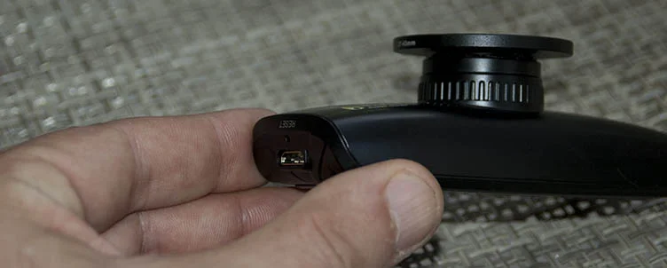

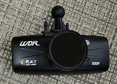

POLARIZER FILTER MOD
I have a very light dashboard which causes quite some reflection.
A Polarizer filter would take care of this issue but there is no way to mount it on the dascam.
The lens diameter (outer diameter of the lens housing) is approx. 29mm
Thus in theory we could try to mount a 29mm polarizer filter, BUT...
The lens has an extreme wide angle, what this means is that it would show the edges of the filter, also know as vignetting.
What do we need:
a 43mm Polarizing filer (approx, $19 for a good one)
a 27mm to 43mm adapter ring (less than $4)

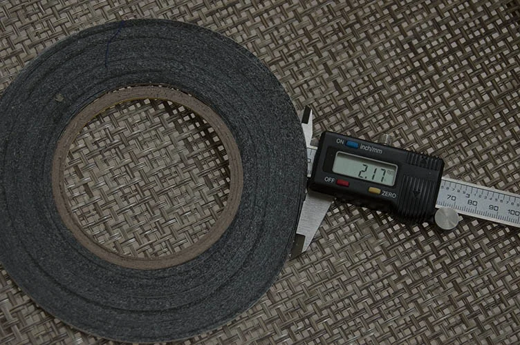

2mm wide double sided tape (3M or similar brand) (this type of tape is used to glue phone LCD's)
Fixate the ring with the double sided tape to the lens
Voila DONE

The are good and bad Polarizing filters (don't buy junk)
A Polarizing filter is made out of 2 lenses, the outer lens rotates.
Before mounting the filter, sit in your car and rotate the filter until the glare is gone.
Mark the position.
Mount (screw) the filter on the dash cam and make sure the outer ring of the polarizer filter is at the same position as tested above. (you might need some fine tuning)
Depending on the quality of the polarizing filter, the picture might be slightly darker.
In this case, you can adjust the settings on the dashcam.
ENJOY

Anyway, to thread starter Belga, how did you apply the 3M tape to the adapter ring? I have the ring, polarizer filter, and a roll of 3M 2mm doudle-sided tape as you described. (All obtained from Amazon and e-bay sellers btw.) Did you wrap tape around the small threaded part of the ring, letting it hang over the edge, then press onto the camera? That's what I did. If it doesn't gradually come un-stuck from the weight of the polarizing filter and fall off I guess I am in business.
