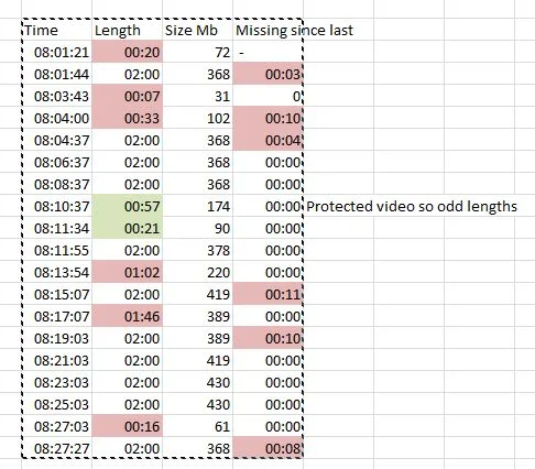

I purchased a 422GW with the rear camera module a few weeks back. I have had this running in my car set on 2 minute videos but when I went back to look at an incident on the road I noticed that it had fallen into a gap between the videos.
It seems periodically the camera is taking shortened videos and when it does this, it takes around 10 seconds for the video to restart. I went through a portion of my commute one day and it was missing 46 seconds in total from a 26 minute drive. Not loads (~3%) but enough to miss an incident the other day and not really what I want a dashcam for. Currently speaking to the technical support but all they seem to say is "faulty memory card" which I am struggling to believe, it is a brand new card which is capable of saving 2 minute videos and starting a new video for chunks of time as the table shows.
