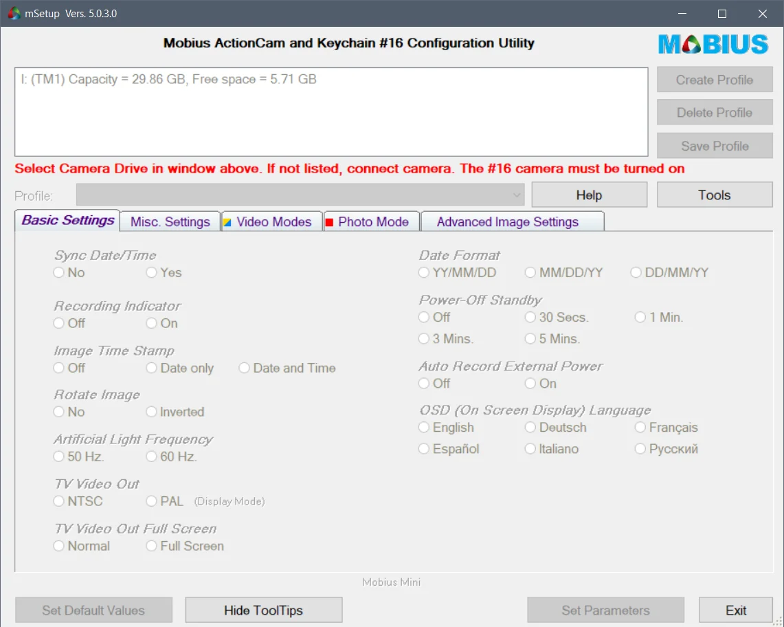

The "big" question about this whole idea is whether or not the firmware for the Mini can be programed for a super-capacitor via mSetup to allow for proper shutdown.
I can't see why not. You can set any Mobius to shut down immediately, weather or not it has a supercapacitor...?
Not owning one, I wasn't sure if that setting was actually available for the Mini in mSetup. Assuming it has that it makes super-caps doable.
I don't have a Mini, but the mSetup page for the Mini does not have the same shutdown options that we have seen with the Mobius 1, 2 & Maxi.
