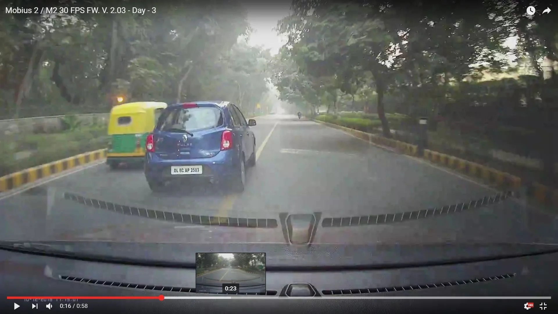

That's quite interesting then when you consider the Mobius 1 was around 15mbs (?) or similar from memory and the GoPro Hero 2 around 25mbs (non pro tune). 42mbs certainly isn't low although not the highest of any camera out there.
Looks like it could be some encoding issue therefore.
The M2 does appear to have hot pixel issues at night, but not so much that I'd say it affects
For the daytime one with macro blocking - it looks very unclear for the resolution. Your windscreen looks very reflective in those shots so the light may have had some effect. So far as the blocking is concerned, it seems to happen with overhanging trees but not always until you're under them which to my mind rules out light issues. If I had to point the finger, it's clearly back at encoding / bit rate issues due to the levels of detail in the picture. It would be interesting to know what the bit rate is on those setting because it looks low. If it's high, then it's got to be codec issues to my mind.
Are you looking at the youtube version, or the re-encoded dropbox download? I see a lot of noise but not so much blocking in the dropbox version.
I've only looked at the Youtube version on here at 1080P. Maybe Youtube's to blame then, although Harsh was also commentating he'd seen the blocking. I presumed he meant in the original. :rolleyes:
The original files are a whole lot better but there's certainly a little bit blockiness when tree cover is lost momentarily.
Youtube (blocky) vs Dropbox (noisy):
When the M2 adjusts to compensate for the momentary loss of tree cover, I do see a bit of blocking on my laptop screen. For most part, it's exactly as compared above.

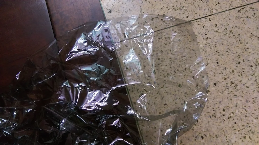

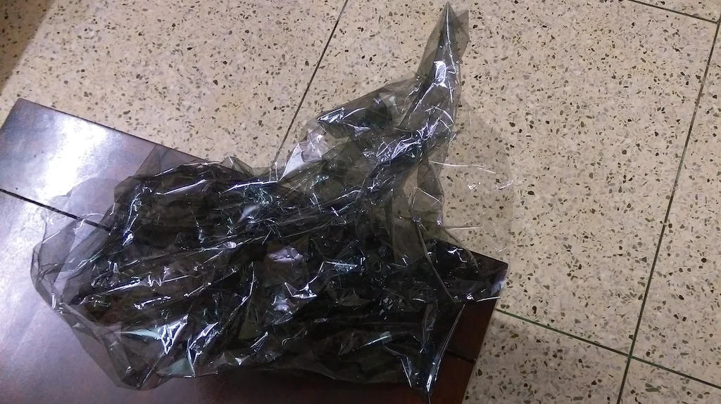

Post cleaning the front windshield from the inside and the GC's CPL using a Lenspen, the next day I noticed the VTL70 clear film was peeling off the glass from one of the top corners. The 3M SP70 had always appeared to have a very milky haze to it under white LED or white T5 street lighting, the slight peeling gave me a strong urge to go park under a streetlight and check if I could compare the difference through the inch of (now) exposed glass. Wasn't really surprised as I did expect a cleaner/clearer view but never expected the difference to be as drastic as it turned out to be. Guess what happened next?
Didn't look as dark as can be seen in the pictures above when I'd gotten it installed. The samples stuck to the dealer's office glass door (that sold me) also looked like a non-tinted clear film. Seriously confused about the shade of the film that's come off.
Not too bummed as this was their inexpensive version. would it have been the CR70, that would've hurt.
