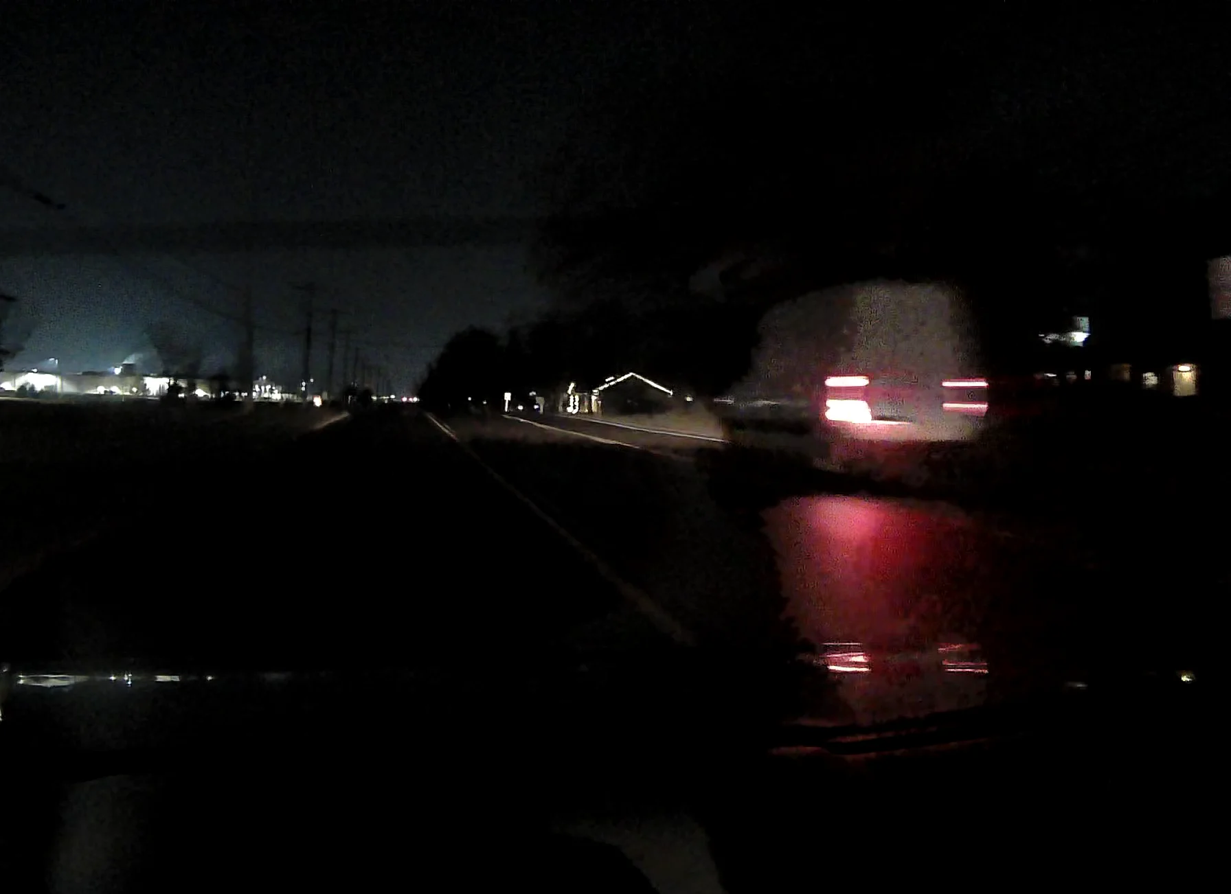

So I swapped out the N4 Pro S on my windshield for the N4S real quick to collect some sample footage, and I plugged the N4 Pro S' rear cam into the N4S. It looked to be working fine, but I'm noticing some really weird stuff including a lot of artifacting from some of the night footage I'm watching from this morning, plus the videos sometimes play back at 10fps instead of 30fps, even though the metadata shows 30fps. Daytime footage is playing smoothly at 30fps. HDR and PlatePix are both enabled. Is the N4 Pro S' rear cam the same as the N4S' rear cam? It's possible they're not and not compatible, so I wanted to doublecheck before I attach the other rear cam. @Jeff_Vantrue

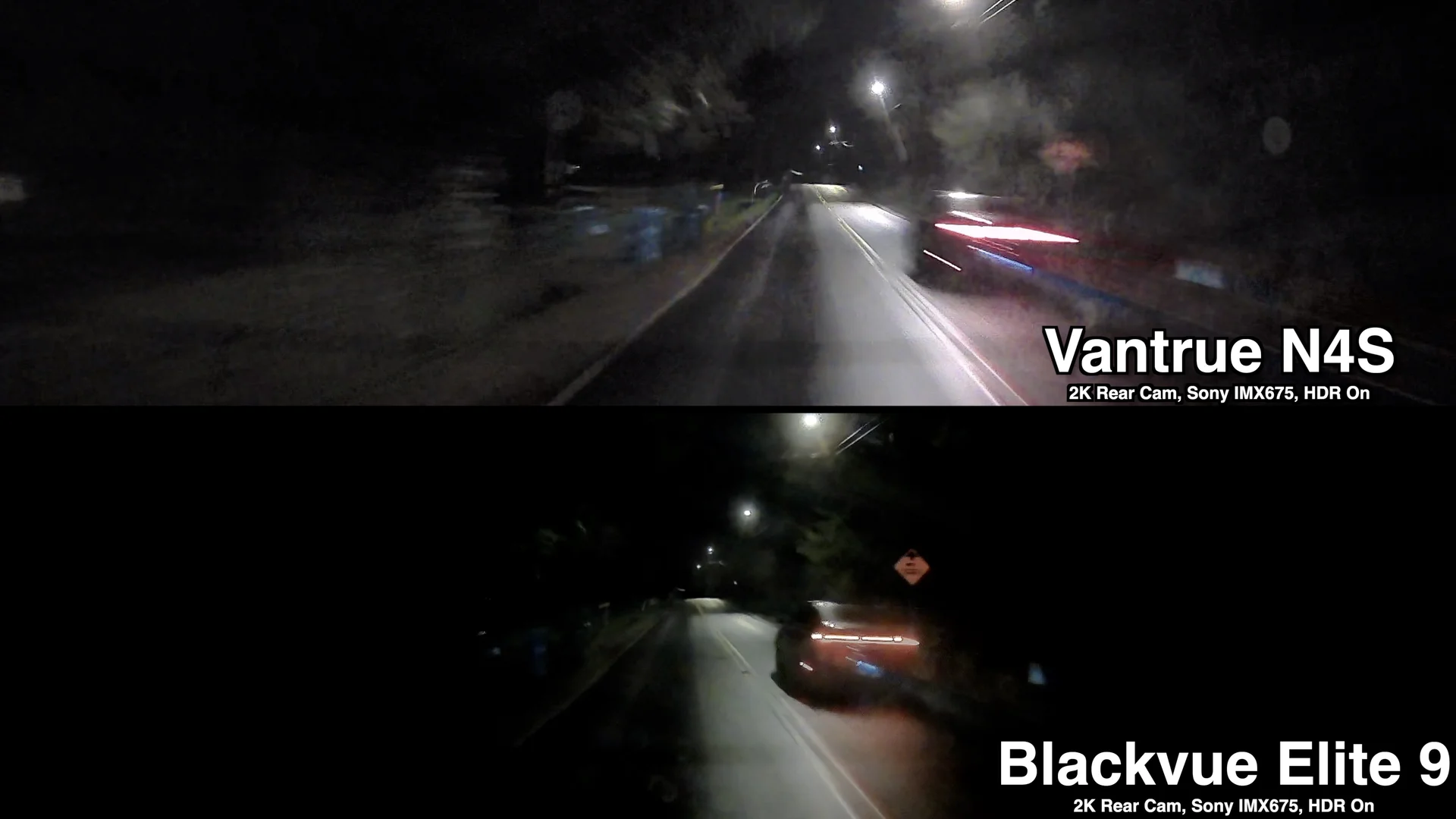

Okay, yeah it looks intentional. I'm seeing it dynamically switch back and forth between 10fps, 15fps, and 30fps based on ambient light levels. It seems the idea is to give it longer shutter speeds (sacrificing fps) to ultimately give us brighter individual frames. Here's a comparison with the Elite 9 which also has the same IMX675 back behind, but different image processing.
That's an interesting approach that I don't think I've seen before.

Tested the N4S Rear Camera today at night. Zero issue with the motion blur highlighted in your video. Disabled HDR and PlatePix. I presume these are the issue. I noticed HDR caused lots of motion blur at night when I tested in the past.
I'll try to grab a sample to upload here ASAP.
@Vortex Radar

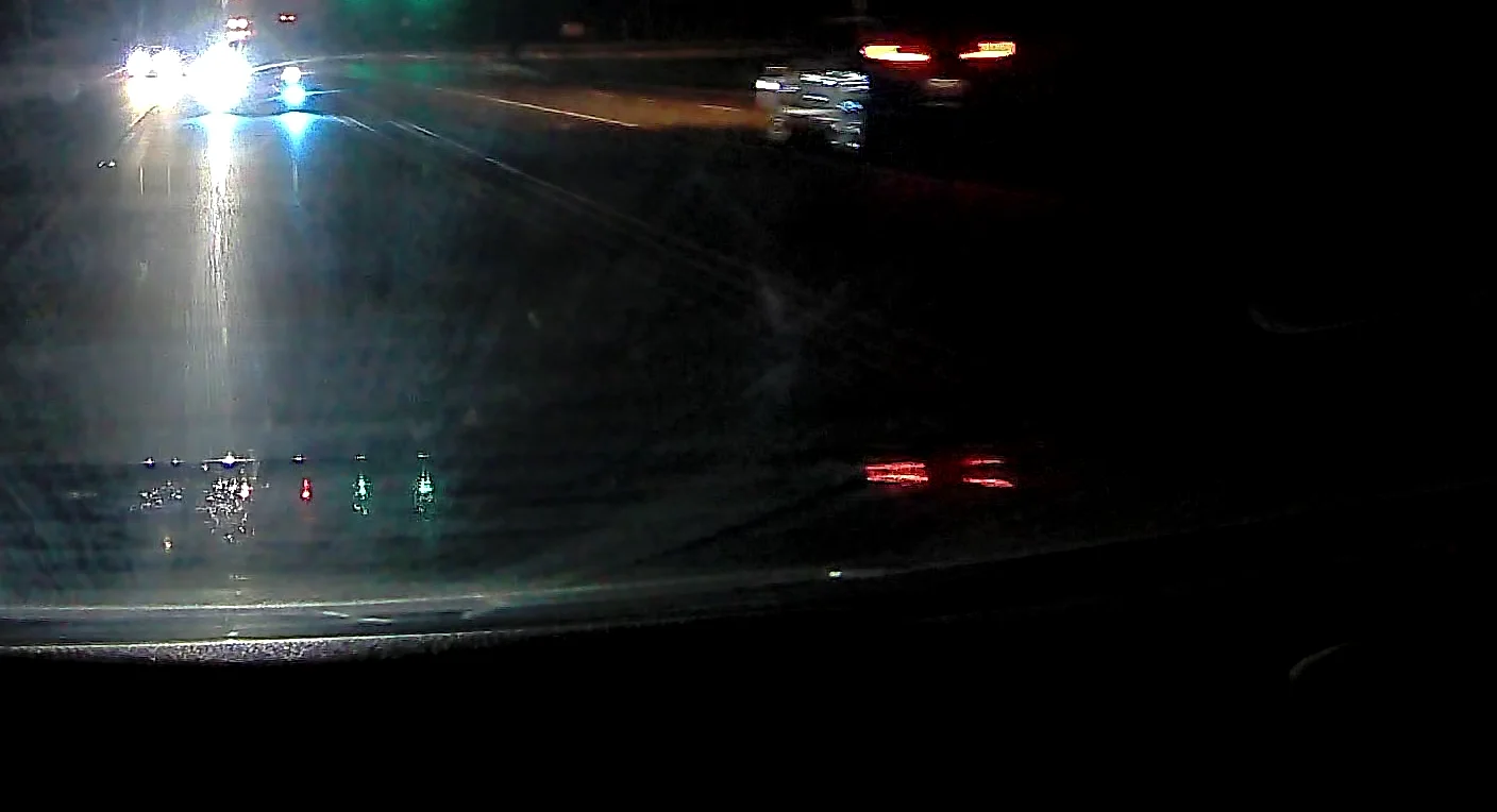

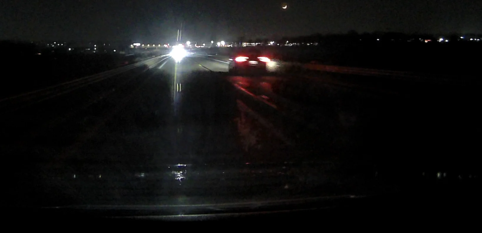

I was trying to find similar screenshots to post that matched your low light settings. Anyway, the issue is HDR + PlatePix Enabled. Here are 3 screenshots from cars passing me at a high rate of speed (73 KM/H and/or 45MPH). Low Light Rear camera images aren't going to win any awards....HDR and Plate Pix DISABLED:
Images taken with proper lighting are far more clearer. Installing a Viofo CPL-300 Helps a lot. This camera doesn't have a CPL so it gets far more glare than the N4 Pro S or N5S. I should order one, as this camera is in a family member's vehicle and could seriously benefit from glare reduction.
