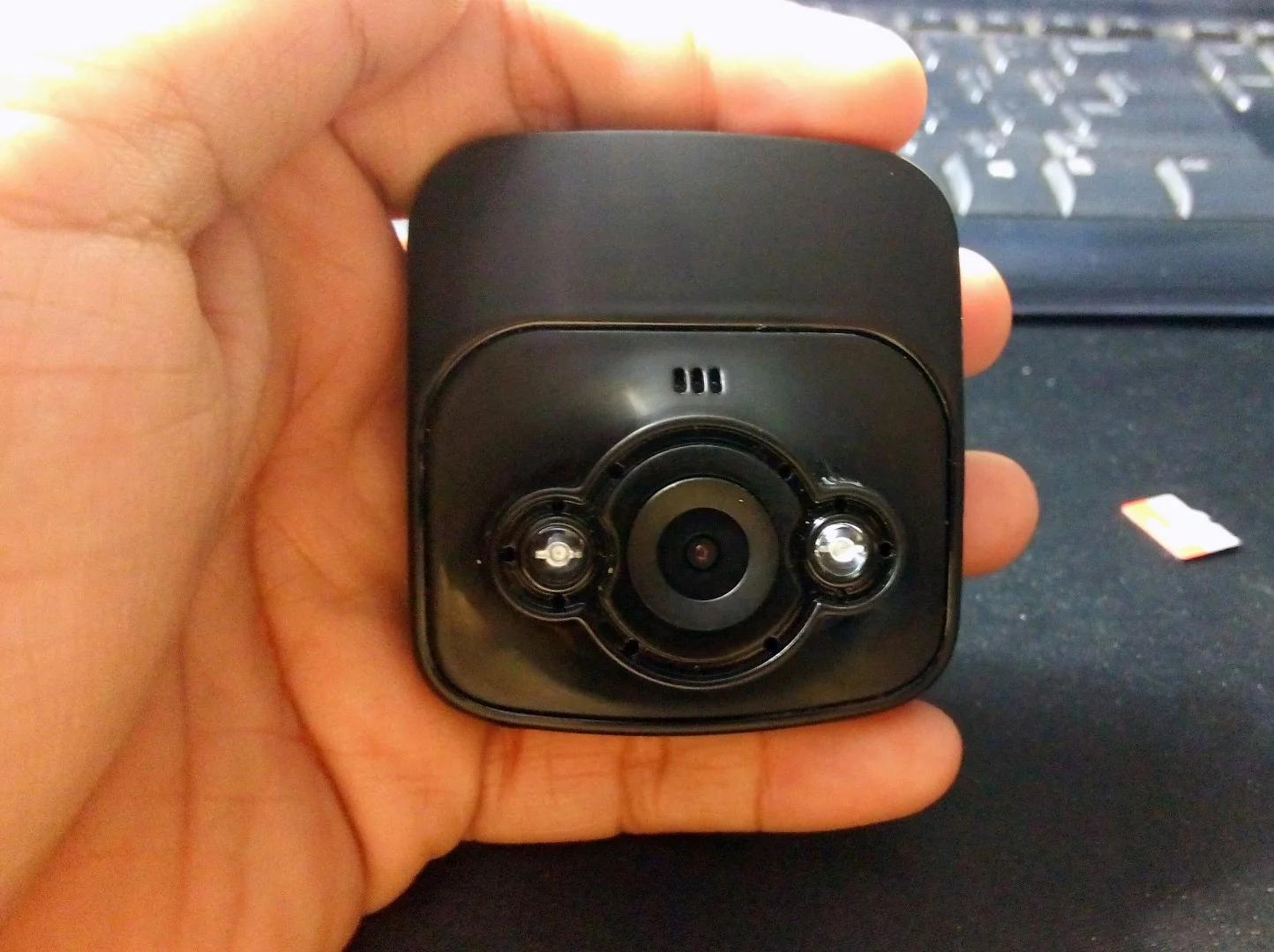

The cam arrived and made no sound. Because of a video review I had seen, I knew something was wrong. I factory reset it, but still nothing. I cracked it open and found the very thin wires to the speaker were not attached. I soldered them on and I was back in business. I also didn't like the chrome ring, nor the lettering above the camera and the high gloss of the plastic so I removed the ring and used some 3000 grit sandpaper to remove the lettering to knock off the gloss. I like it better this way, but still might put some black tape over the IR LED's since I've read they won't help much at night and I won't be using the motion sensing functions.

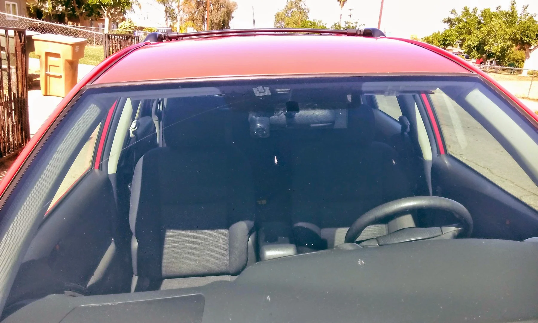

Anyway, here are pics of the cam as well as how it looks installed behind my rear view mirror.![Smile :) :)](https://cdn.jsdelivr.net/joypixels/assets/8.0/png/unicode/64/1f642.png)
