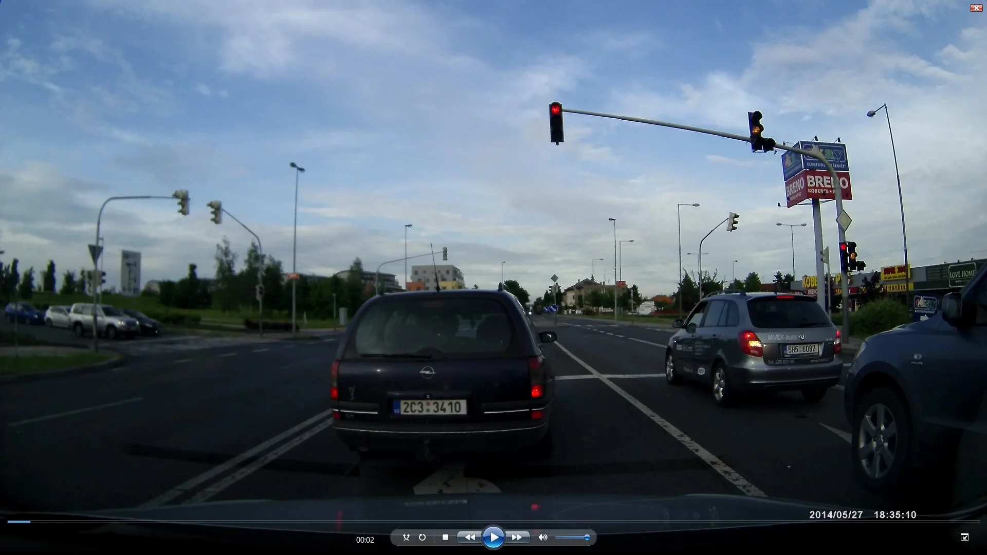

new mini 0803 test video with 20140510V1 firmware
Image of my cam with 20140510 is still not sharp.
Interesting is, that image is sharp on right side, but blurry on left side.
It also observed someone?
It's manufacturing defect of my piece, or fw problem?

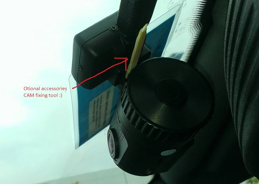

Nice DIY fixing 😀
What is the paper behind ? Used to hide the cam ?
Blurry on the left is not normal... I think something is bad assembled on the lens.
Parking card. Also used for cam hiding.

Image is blurry with every settings, and every fw.
Open a private conversation will @billknow on the forum too.
But don't get a headache... it is a hardware issue, not software.
The lens is not adjusted or mounted correctly.
