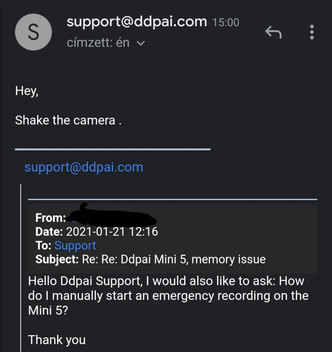

Here is the answer from ddpai support, that make me so sad...
Hardware 10pts, App and Support -10
