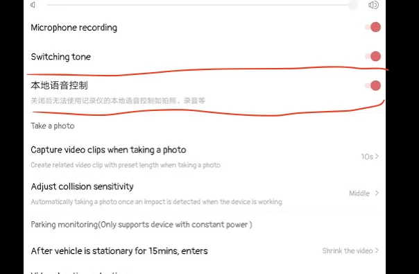

Btw it's possible to trigger video/photo capture event by voice. Simply use the Chinese ddpai app and enable voice control, (it's in Chinese, immediately after switching tone).

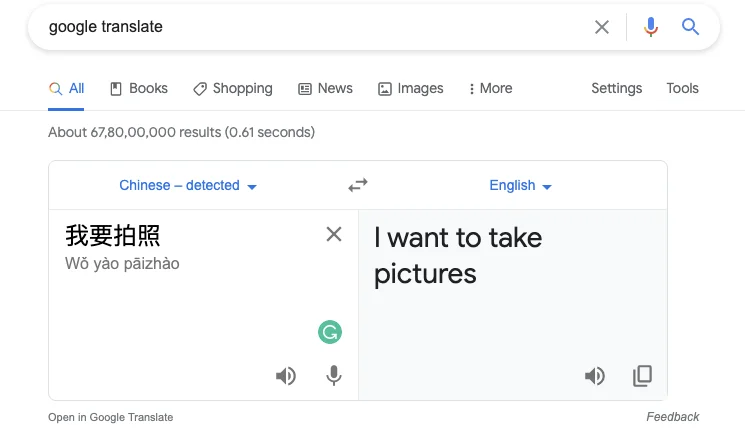

After this, simply say this Chinese phrase "我要拍照". I copied this to google translate and pressed the speak button.
It worked on my mini cam every time but not on mini 5. Haven't been able to trigger it with my voice also yet, but I think should be possible.
