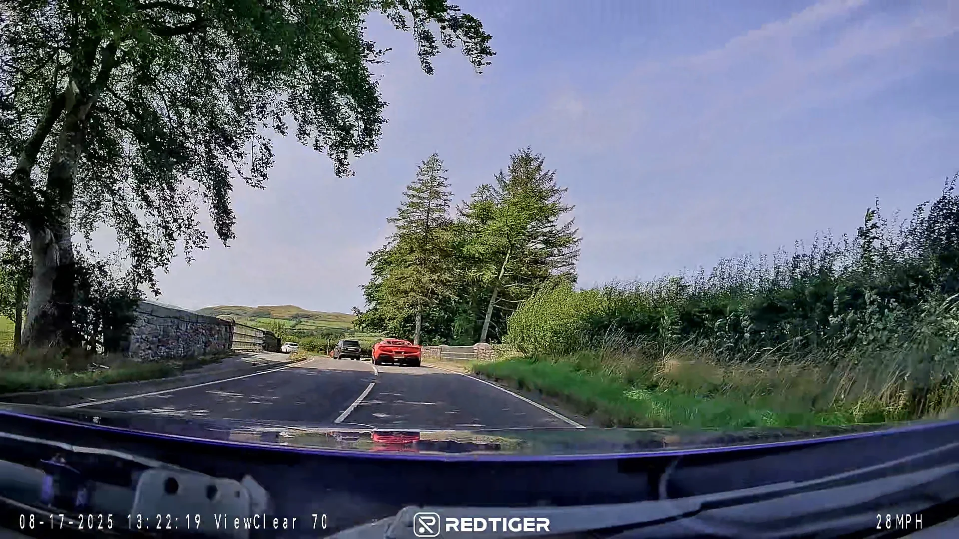

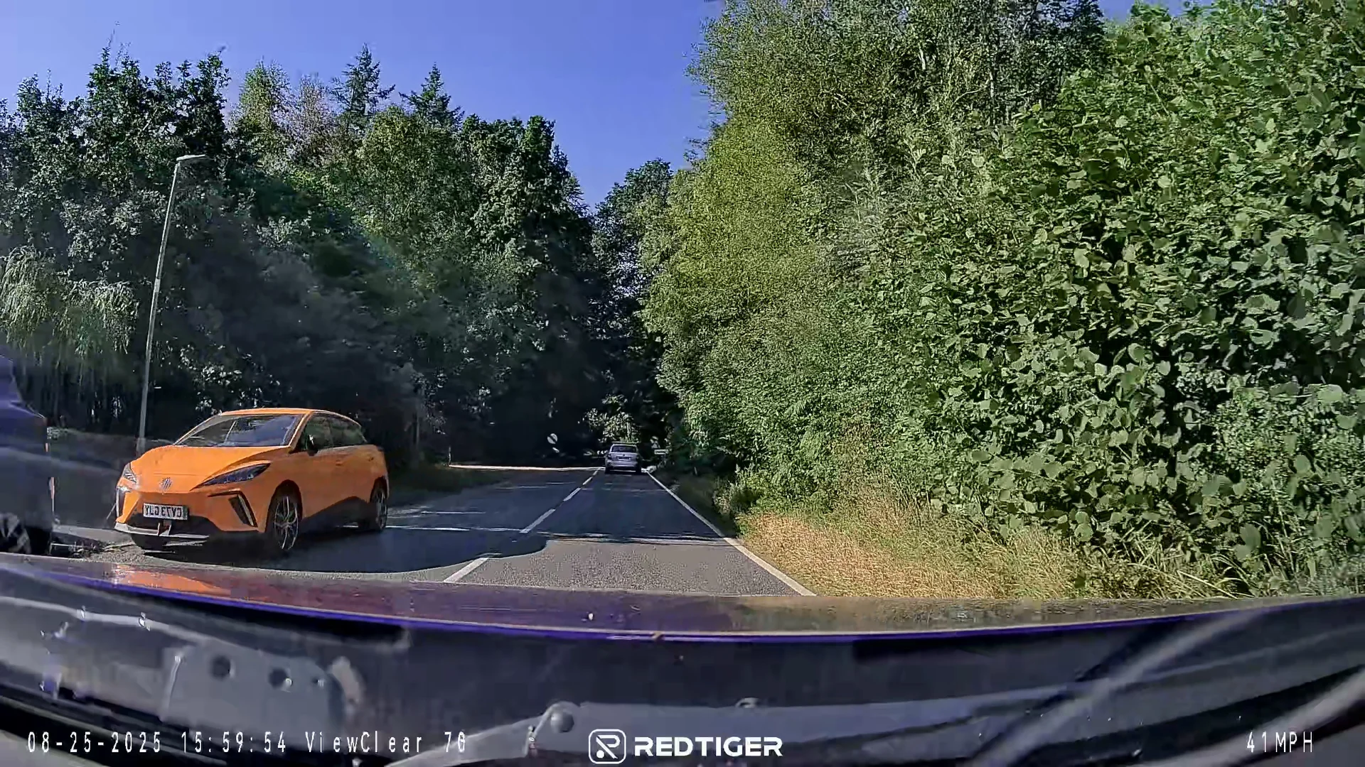

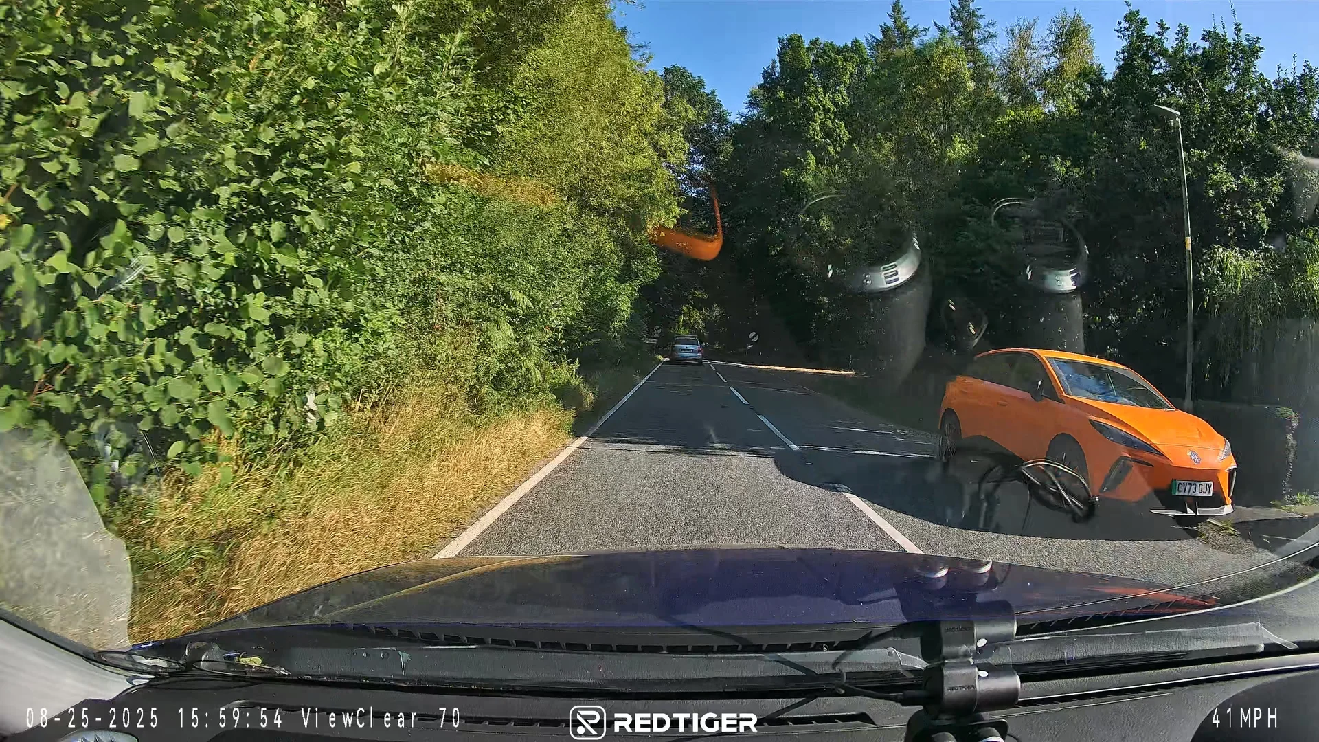

Here are some preview images, front Sony camera followed by rear Omnivision camera (visible at the bottom of the front camera image), with one of the VC70 issues rather obvious - the rear camera is mirrored, I can un-mirror it in the setup, but I need a rotate 180°, it only gives me a flip, which mirrors, and there is no rotate option! Also the lack of a CPL is causing reflection issues on the second example, but the HDR is working really well in daylight on both cameras, nice sky and full shadow under the trees, and it does read plates.
My trees are giving it a hard time on bitrate, but it is doing quite well, and using H265, which is the only option:

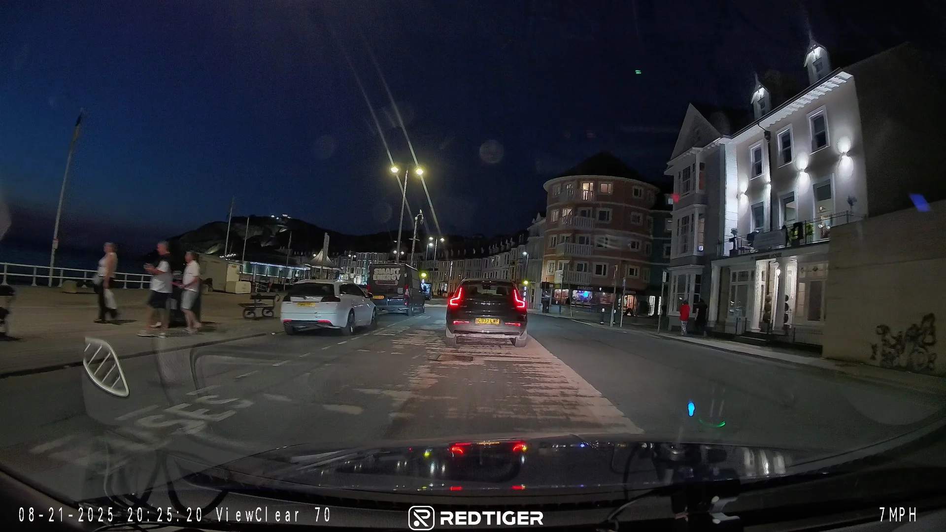

Front, Sony IMX678:
Rear, Omnivision OS04J10:

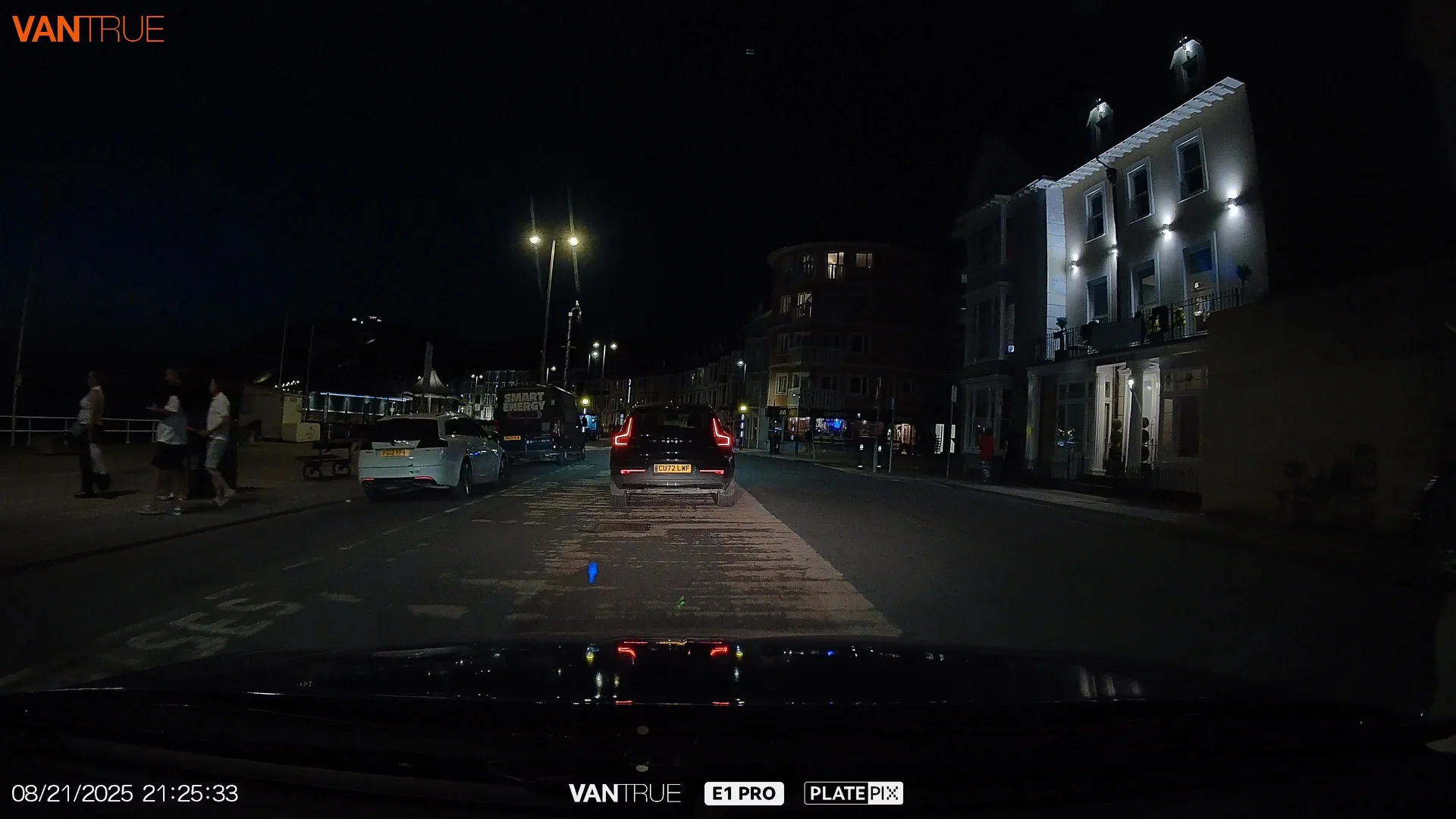

Vantrue E1 Pro (Sony IMX678):
The amount of motion blur tends to be identical, the only consistent difference is that the Omnivision is 2K, not 4K (Or 2.5K as RedTiger call it), with the result that the digital sharpening is more obvious on the Omnivision, it looks sharper but doesn't have more detail. The E1 Pro is always darker, a result of the PlatePix TM feature.
