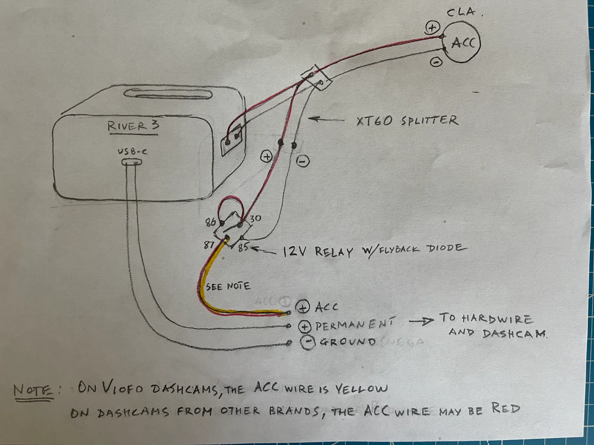

Here is a video demonstrating how to resolve the "phantom voltage" issue on the XT60 input port of the EcoFlow River— that prevents dashcams (such as BlackVue, Thinkware, and Red Tiger) from entering parking mode.
Also attached is the wiring diagram for this solution.
The solution is fully localized, using a 4-pin normally open automotive Relay.
There is no need to search for an ACC power source or a ground connection elsewhere in the vehicle.
I tested this with a multimeter, however, testing with actual dashcams is needed to ensure it works.
Bench tested both BlackVue and Redriger. Both entering and existing parking mode as intended. Zero reading after installing the relay to the ecoflow. Many thanks. I will add the setup to my truck once I get some time.
Added the setup to my truck. Working flawlessly. Have you experimented with the ecoflow automation stuff? I am thinking of using it to shut off the dashcam during specific times of the day when I am at work because the vehicle is in a secured parking lot but its very busy. I dont need a notification ever minute or having the sd card being written to that many times. I think I can just use the automation to turn off and on the 12v port. Have to test that out but any drawbacks with this?
