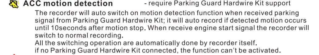

So this is how the parking guard ACC motion detection should work according to the manual:
I have a hardwire kit so I tried this out today and the result is:
  • Parking guard recordings work fine at 2fps - Good
  • No recordings when the engine is running - Bad
Anyone else tried this setting?

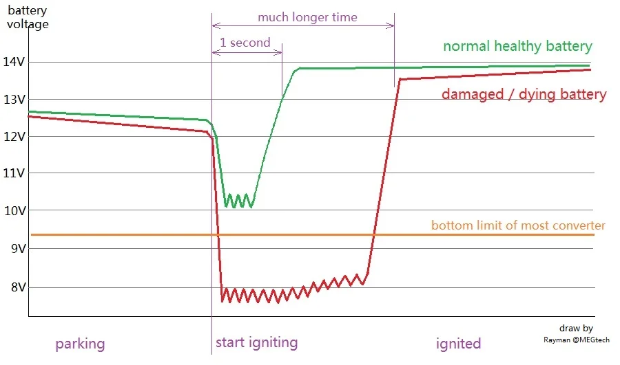

This figture will help to explain how the voltage drops on a old battery when igniting.
when igniting the voltage drop to lower than the bottom limit of converter so the power is cut off.
If the power recovers just when the camera is powering off then the camera will not identify the power issue and keep sleeping.
