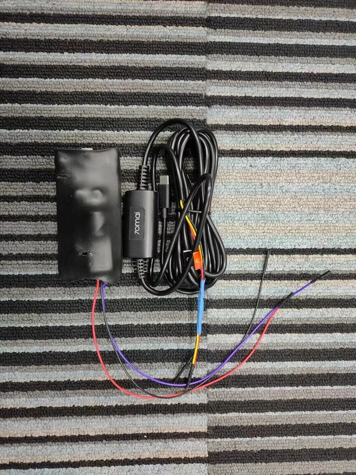

I have same idea too, But only implemented in 70mai 1s(Modify Micro USB cable)
refreance from Taiwanes guy`s idea:
