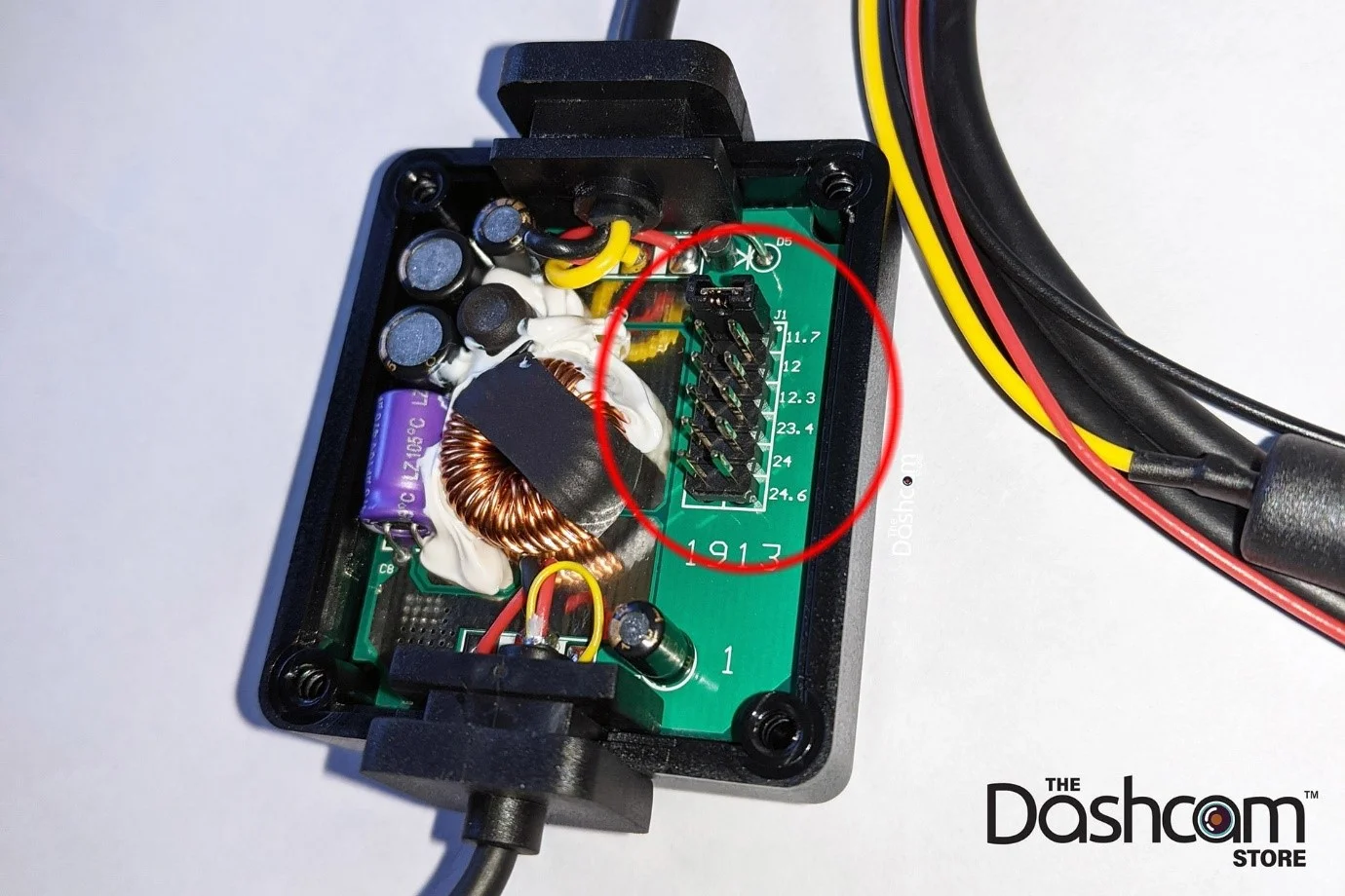

If you want to air of the side of caution, just move the bridging bar inside the little box on the Garmin harness to increase the cut off voltage, no fuss, no bother....
