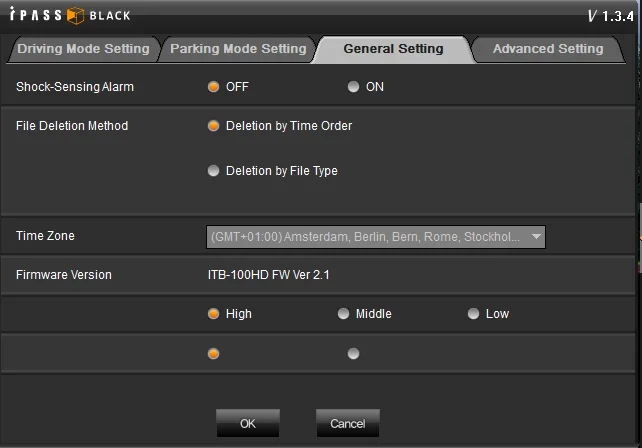

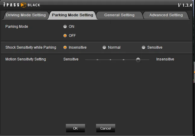

I installed the ITB and with upc about a week ago and it runs continuously only stopping after the 12 hour time restriction that I selected (note the car is parked facing a wall (nothing moving).
Below are two screen shot from the tools section of the player. I have moved everything to 'insensitive and it makes no difference.
Is there something in the settings that has it set up to run continuously?

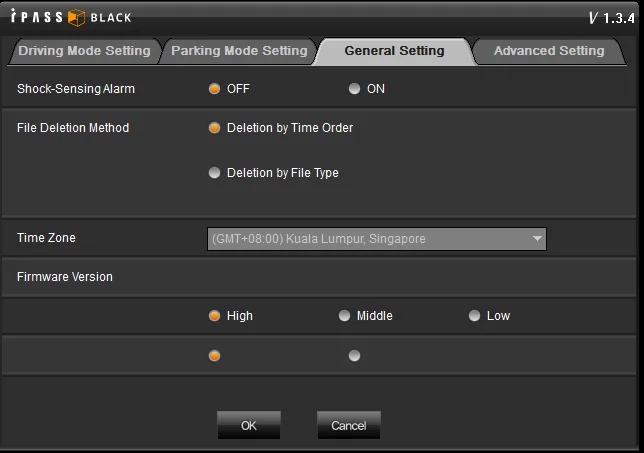

The cam runs continuously until it's timed out (12 hours) even when parked and even after I have set the park settings to off.
See here pics of my settings.
What am I doing wrong?

Anyway, is the program saving the Setup folder and setup.bin file to your sd card? Are you putting that SD card into the device? Sorry if I'm being too basic.
What do you want to do? Turn parking mode off completely?
As above, are you saving the settings to SD card?
I want the parking mode but I want it coming on when something happens, at the moment it stays on, running continuosly no matter what I put the settings on (the settings changes do seem to be saved on the SD card).
I've been mailing Apple and its like walking through treacle! I am not sure if gthey understnad the problem but the last mail they sent me showed a screen clip of their V.1.3.4 viewer and it's different than mine? It's in Korean of course but you can clearly see there are more options on theirs.

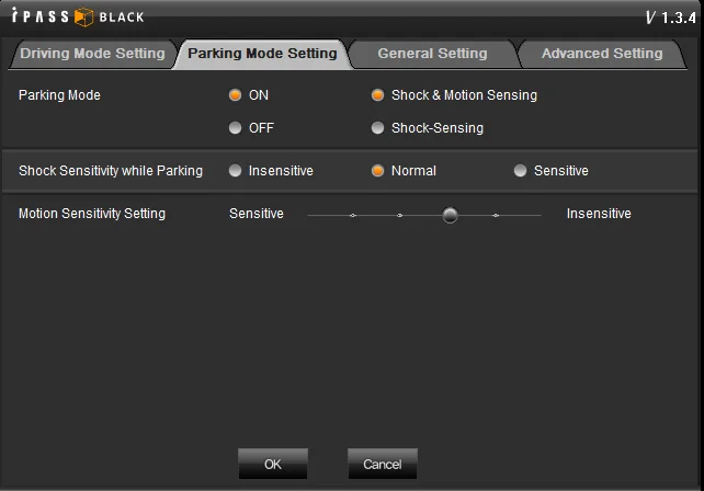

I have mine set to parking mode on and shock sensing only. It only records when the car moves, for example me opening and closing the car door etc.

I want parking mode to be off yet come on when something happens; I thought that was how this function was supposed to run. It didn't go off, it stayed on for 12 hours so I changed the setting to OFF, OFF, OFF to see what happened and . . . . . . same thing, it runs continuously for 12 hours when it's parked facing a wall all night! I've sent half a dozen mails to Apple and their replies are gibberish (I wish they'd get someone who can speak / read Englsh) The last reply did include a screen shot of the Korean PC Player which did show a different set of options.
Surely there is somebody here with the same cam that can tell me whether (a) I am doing something wrong or (b) the cam is deffective.
Turn Parking Mode to ON and then set whether you want motion and/or vibration sensitivity.
If you don't turn Parking Mode ON, it will record constantly.
Even in parking mode, the unit is always on... it just won't record to the card unless there's movement or vibration. Cheers!
as above really
parking mode set to off will result in your cam recording constantly
parking mode set to on will only record if motion is detected or by shock
