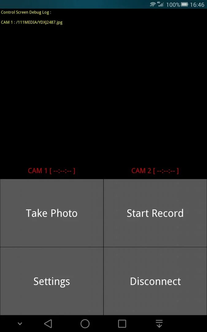

Hi Guys ! I final build a very simple apk for XiaoYi Sports Camera. I call it #Ponerine#, meaning of a kind of gaint ants.
debug 0.1.4 updated

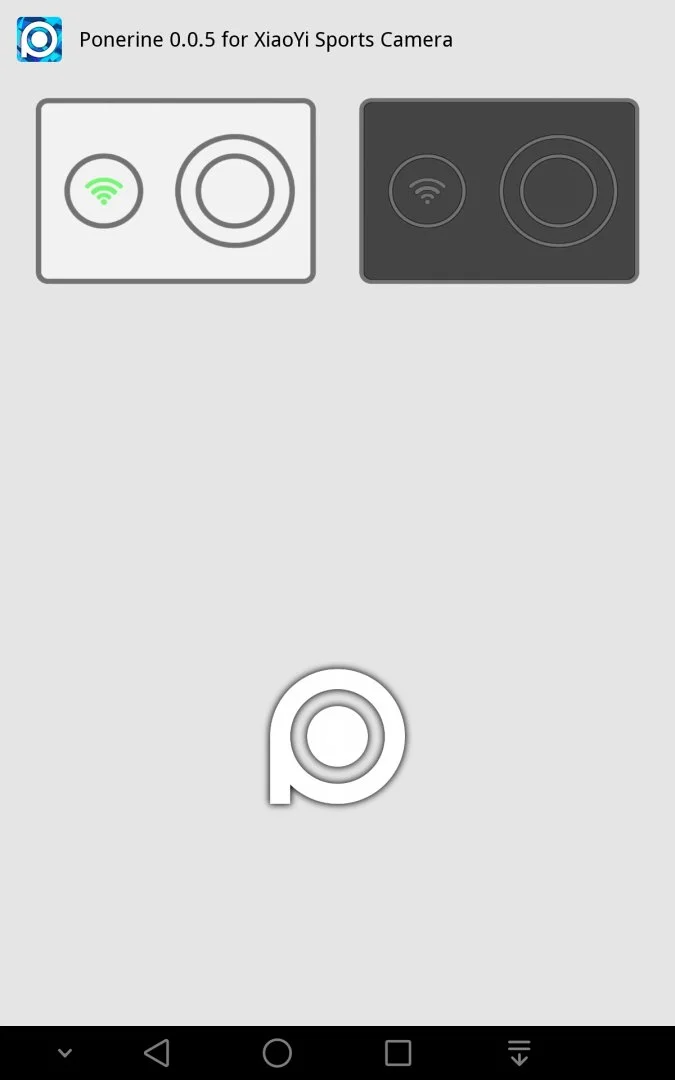

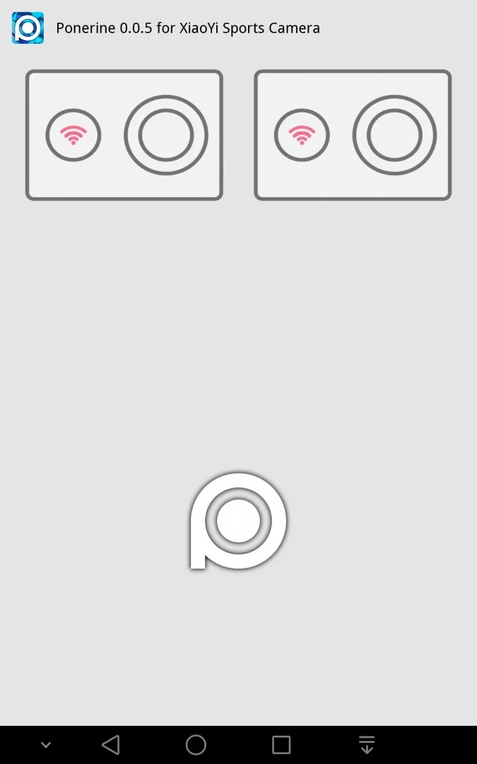

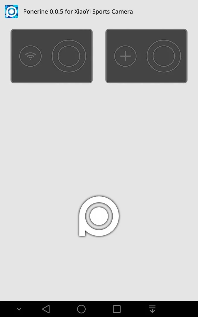

debug 0.0.5 features released:

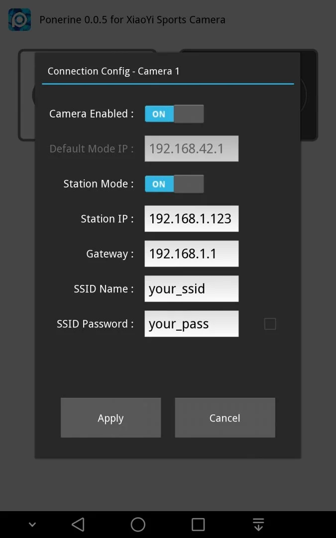

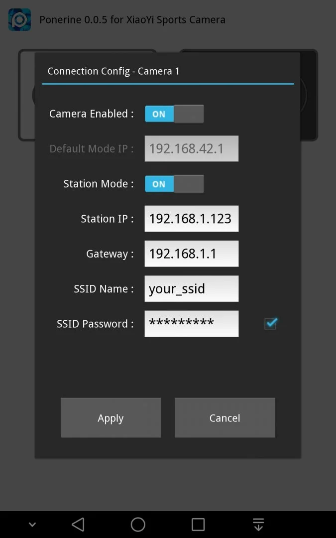

1. Simplified the main screen, remove the "colorful" background;

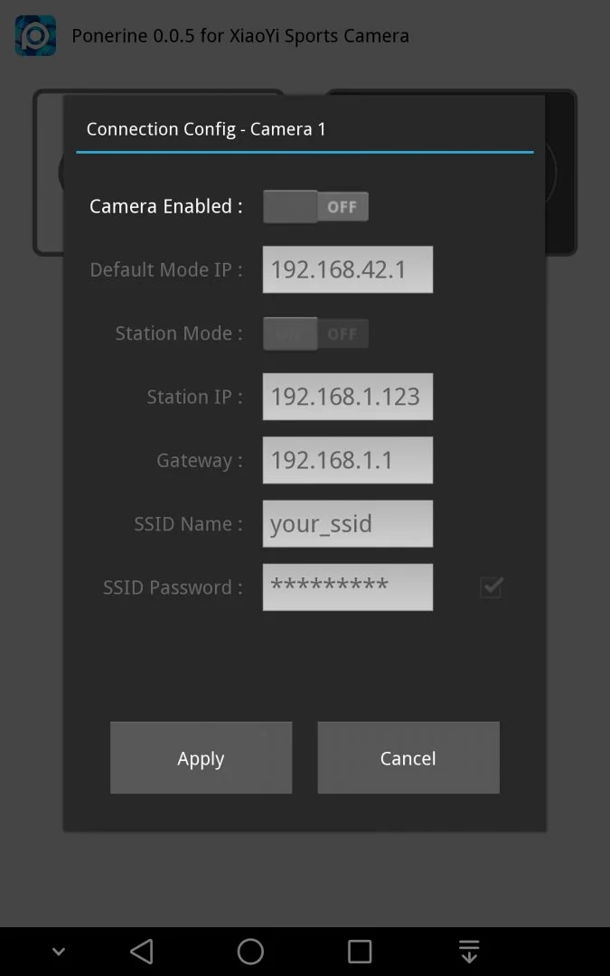

2. Automatically detect camera status, green is ready, red is not available;
3. Click the camera logos to config the ip address (2 cameras config can be saved);
4. Camera can be enabled or disabled;
5. Settings of AP mode & Station mode can be saved;
6. Show or hide password of SSID.

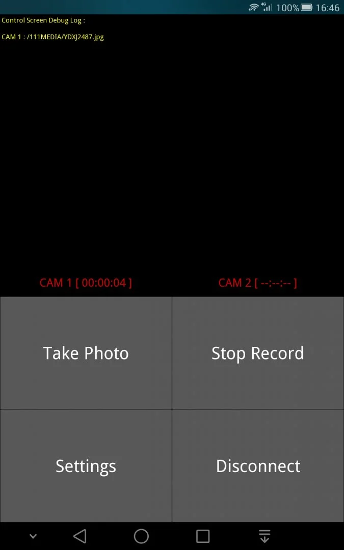

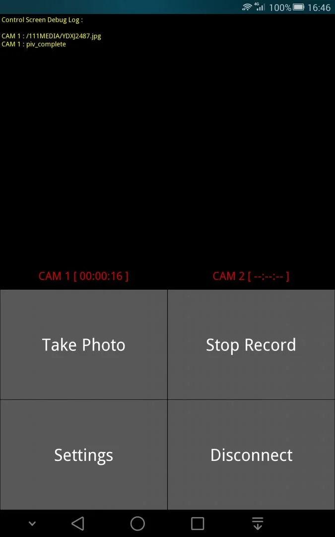

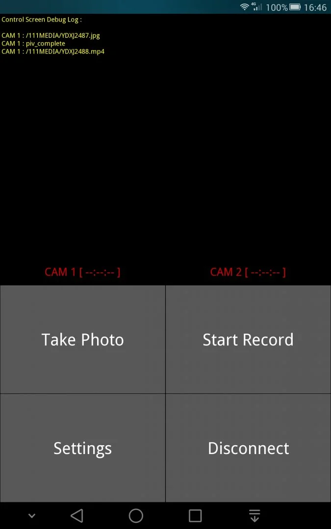

Screenshot:
View attachment 15596 View attachment 15668 View attachment 15669 View attachment 15670 View attachment 15671
View attachment 15598 View attachment 15599 View attachment 15601 View attachment 15602 View attachment 15603

Ponerine [debug 0.0.5] features added:
2. Click the camera logos to config the ip address (2 cameras config can be saved);
3. Automatically detect camera status, green is ready, red is not available.
update some screenshots:
Screenshot_2015-08-01-02-53-07.jpg Screenshot_2015-08-01-02-53-39.jpg Screenshot_2015-08-01-02-53-30.jpg Screenshot_2015-08-01-03-02-03.jpg
Screenshot_2015-08-01-02-59-02.jpg Screenshot_2015-08-01-03-01-18.jpg Screenshot_2015-08-01-02-59-49.jpg Screenshot_2015-08-01-03-01-31.jpg

Ponerine [debug 0.0.5] features released:
Download Url: ponerine-debug-0.0.5.apk (7.66MB)
