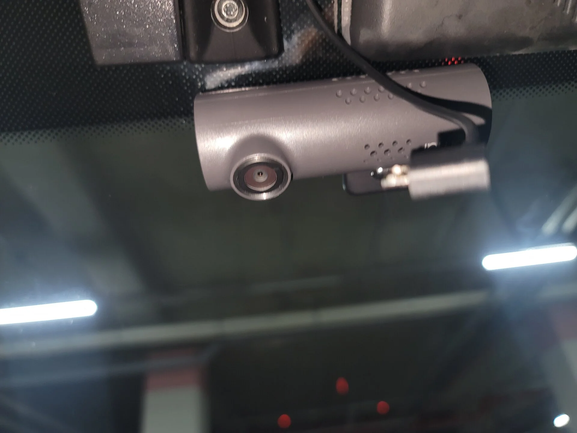

I've received my 70mai pro few days ago and I need opinion from you guys is this kind of footage normal for this dashcam?
In the daylight it kinda looks ok but you really cannot read any licence plates if you don't come really close to the cars.
On the night footage you can't see much from the headlights. Also look at the lights on the streets and on the gas pump signs. Looks like camera cannot focus very well.
I've received my camera like this
but after few minutes condensation has dried off. Could it be that the condensation from inside the lense has stained the glass and camera cannot focus because of that?
After I saw the night footage I though maybe there is plastic protection on the lense and that I maybe forgot to peel it off but there is nothing there..
Camera is running on the latest firmware.

After I saw first few videos I was trying to clean windshield multiple times. It looked squeaky clean from the outside and the inside but problem is still there. Windshield is little bit scratched from the wipers but those scratches are really far from the lense.
I will try to clean it up a few more times, maybe it got gunk up when I used some products from AliExpress as a Anti-Fog solution. That was a year ago and it worked really good, but even after drying the glass and buffing it off windshield and other glass inside the car felt slick and little bit greasy.
As for cleaning the lense. I've cleaned it up with microfiber cloths (the ones you get when you buy the protective glass for your phone) and it looks really clean. I can't really see any water or condensation spots inside the glass on the lense.
It's really weird but I will post an update if I figure out what is cousing this problem.
To see whether your windshield is having an effect, take the cam off the mount and do a short recording with the cam held outside (no glass) and then the same shot with the cam installed normally and compare the two recordings on your computer. You do have some issues with the windshield- I'm seeing some pretty strong dash reflections and I'm seeing 'flares' from streetlamps. When those 'flares' don't change angle as you drive past the lights, it's usually a dirty or sand-blasted windshield. When they move across in an arc when you pass the light it's a wiper-scratched windshield. Dash reflections can usually be solved with a CPL filter.
Still the video looks out of focus to me so do the unmounted no-glass cam check, and if that video isn't clear and sharp then you've got a focus problem. At that point you'll need to return the cam under warranty for repair or replacement. Lenses can be refocused at home but it can be a tricky job so it is not recommended if your warranty is still in effect.
I've figured it out. Few days ago while preparing my car for the long trip I've saw same glares looking at the garage light through the windshield. You can see them only looking at certain angle but looking at the light through the windshield looks the same as the glare from the video. I don't know how but a lot of scratches and bad wipers from last owner probably caused that. I doubt polishing the glass can help, but I will certainly give it a go.
