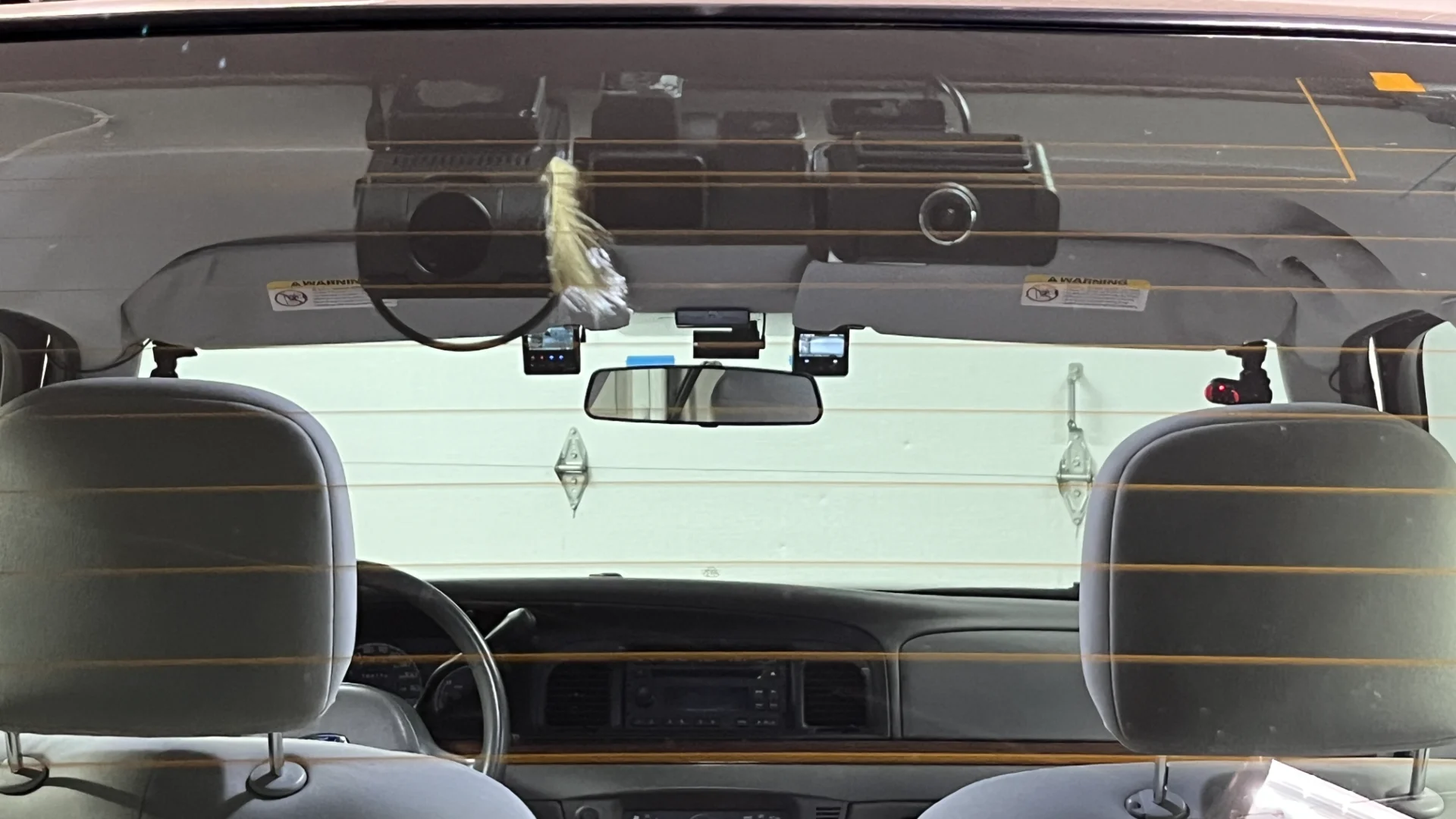

I first discovered horrible wind noise in my car when I roll all four windows down when I put the original A119 Mini (IMX335) 2022 on my rear window.
Even at 15-25MPH on city streets it was bad.
I don’t get any wind noise from dash cams on the front windshield.
I made a dead cat for my gopro in 2015, and it worked out.
After listening to wind noise in my dash cam test footage for a few years I finally decided to stop being lazy, and fix it.
Now I can drive on the highway up to 80MPH with almost no wind noise.

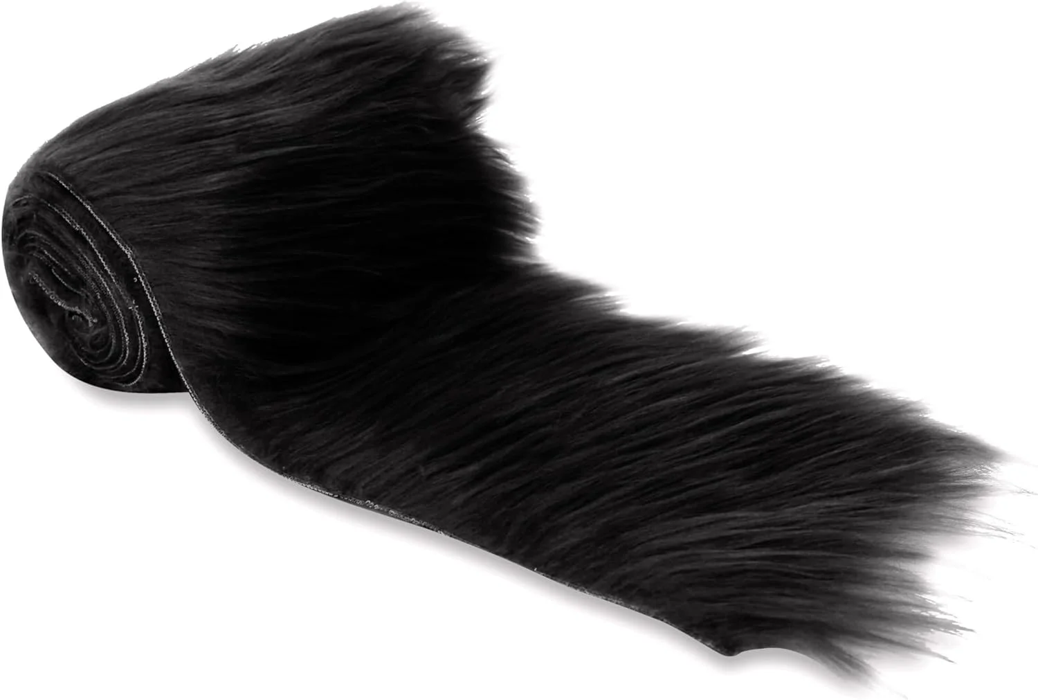

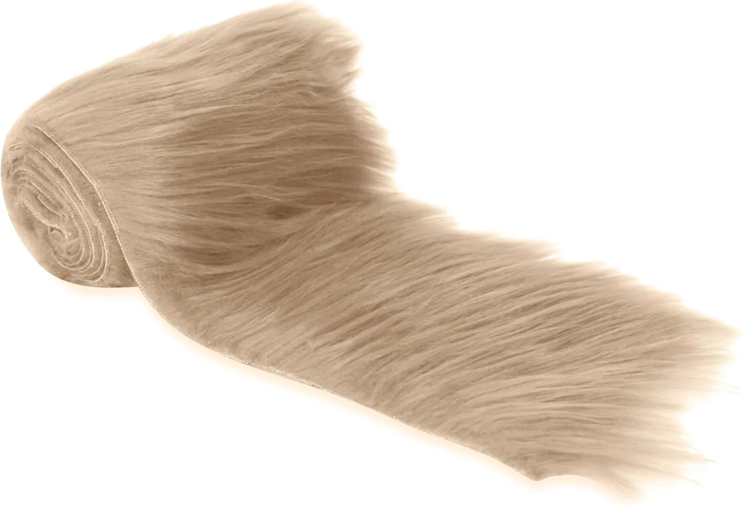

I don’t have a fabric store in my town so I went to Walmart, and they sell fabric by the yard.
They were out of black so I bought this brown stuff for $1.
This looks exactly like the stuff I bought; https://www.amazon.com/gp/B08NFHHTFL

You can attach the faux fur to the dash cam a bunch of different ways.
I had some Gorilla Glue Epoxy that was going bad so I used up the last of it before it went completely hard.
