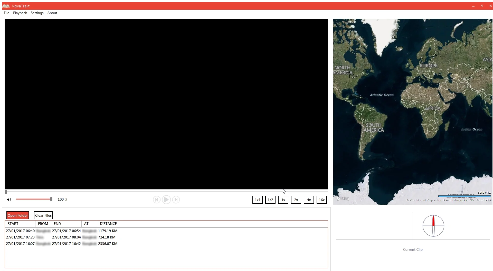

Downside: Journeys now in the bottom part of screen shows random distance, while in the previous version they showed the correct distance.
Every time I open the software and load the folder, it shows every time a different distance (I attach 3 different sessions with same journeys).

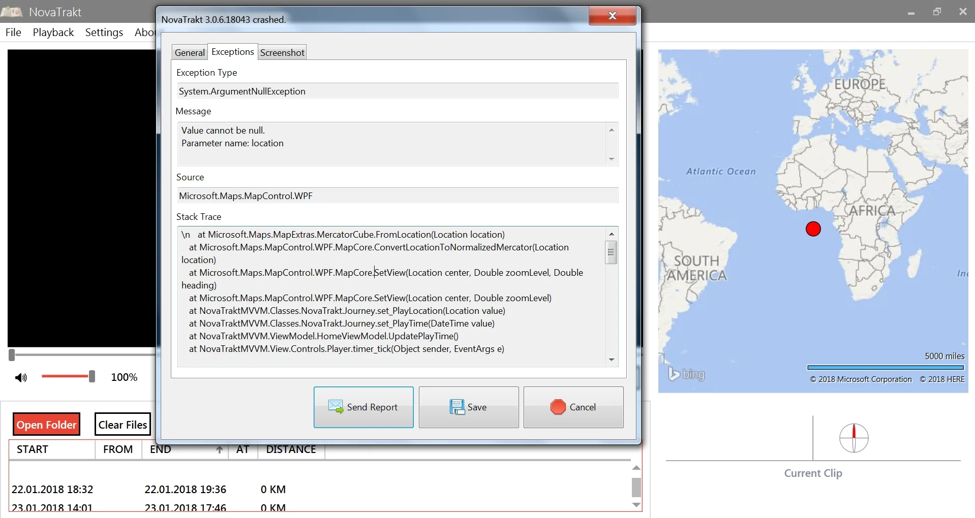

I think the application is freezing at load time if on card there are any other files except MP4 files.
I loaded a 64GB card with A119 recordings but because the videos does not contain any GPS data the application just crashed when I was tryng to play at least one video file from the 3 shown in player playlist. The Send error feature is not working so I am posting here the crash log:
Value cannot be null.
Parameter name: location
System.ArgumentNullException
Microsoft.Maps.MapControl.WPF
\n at Microsoft.Maps.MapExtras.MercatorCube.FromLocation(Location location)
at Microsoft.Maps.MapControl.WPF.MapCore.ConvertLocationToNormalizedMercator(Location location)
at Microsoft.Maps.MapControl.WPF.MapCore.SetView(Location center, Double zoomLevel, Double heading)
at Microsoft.Maps.MapControl.WPF.MapCore.SetView(Location center, Double zoomLevel)
at NovaTraktMVVM.Classes.NovaTrakt.Journey.set_PlayLocation(Location value)
at NovaTraktMVVM.Classes.NovaTrakt.Journey.set_PlayTime(DateTime value)
at NovaTraktMVVM.ViewModel.HomeViewModel.UpdatePlayTime()
at NovaTraktMVVM.View.Controls.Player.timer_tick(Object sender, EventArgs e)
at System.Windows.Threading.DispatcherTimer.FireTick(Object unused)
at System.Windows.Threading.ExceptionWrapper.InternalRealCall(Delegate callback, Object args, Int32 numArgs)
at System.Windows.Threading.ExceptionWrapper.TryCatchWhen(Object source, Delegate callback, Object args, Int32 numArgs, Delegate catchHandler)
at System.Windows.Threading.DispatcherOperation.InvokeImpl()
at System.Windows.Threading.DispatcherOperation.InvokeInSecurityContext(Object state)
at System.Threading.ExecutionContext.RunInternal(ExecutionContext executionContext, ContextCallback callback, Object state, Boolean preserveSyncCtx)
at System.Threading.ExecutionContext.Run(ExecutionContext executionContext, ContextCallback callback, Object state, Boolean preserveSyncCtx)
at System.Threading.ExecutionContext.Run(ExecutionContext executionContext, ContextCallback callback, Object state)
at MS.Internal.CulturePreservingExecutionContext.Run(CulturePreservingExecutionContext executionContext, ContextCallback callback, Object state)
at System.Windows.Threading.DispatcherOperation.Invoke()
at System.Windows.Threading.Dispatcher.ProcessQueue()
at System.Windows.Threading.Dispatcher.WndProcHook(IntPtr hwnd, Int32 msg, IntPtr wParam, IntPtr lParam, Boolean& handled)
at MS.Win32.HwndWrapper.WndProc(IntPtr hwnd, Int32 msg, IntPtr wParam, IntPtr lParam, Boolean& handled)
at MS.Win32.HwndSubclass.DispatcherCallbackOperation(Object o)
at System.Windows.Threading.Dispatcher.LegacyInvokeImpl(DispatcherPriority priority, TimeSpan timeout, Delegate method, Object args, Int32 numArgs)
at MS.Win32.HwndSubclass.SubclassWndProc(IntPtr hwnd, Int32 msg, IntPtr wParam, IntPtr lParam)
at MS.Win32.UnsafeNativeMethods.DispatchMessage(MSG& msg)
at System.Windows.Threading.Dispatcher.PushFrameImpl(DispatcherFrame frame)
at System.Windows.Threading.Dispatcher.PushFrame(DispatcherFrame frame)
at System.Windows.Application.RunDispatcher(Object ignore)
at System.Windows.Application.RunInternal(Window window)
at System.Windows.Application.Run(Window window)
at NovaTraktMVVM.App.Main()

The GPS data from H:\DCIM\MOVIE\RO\2018_0118_125130_198.MP4 was not read.

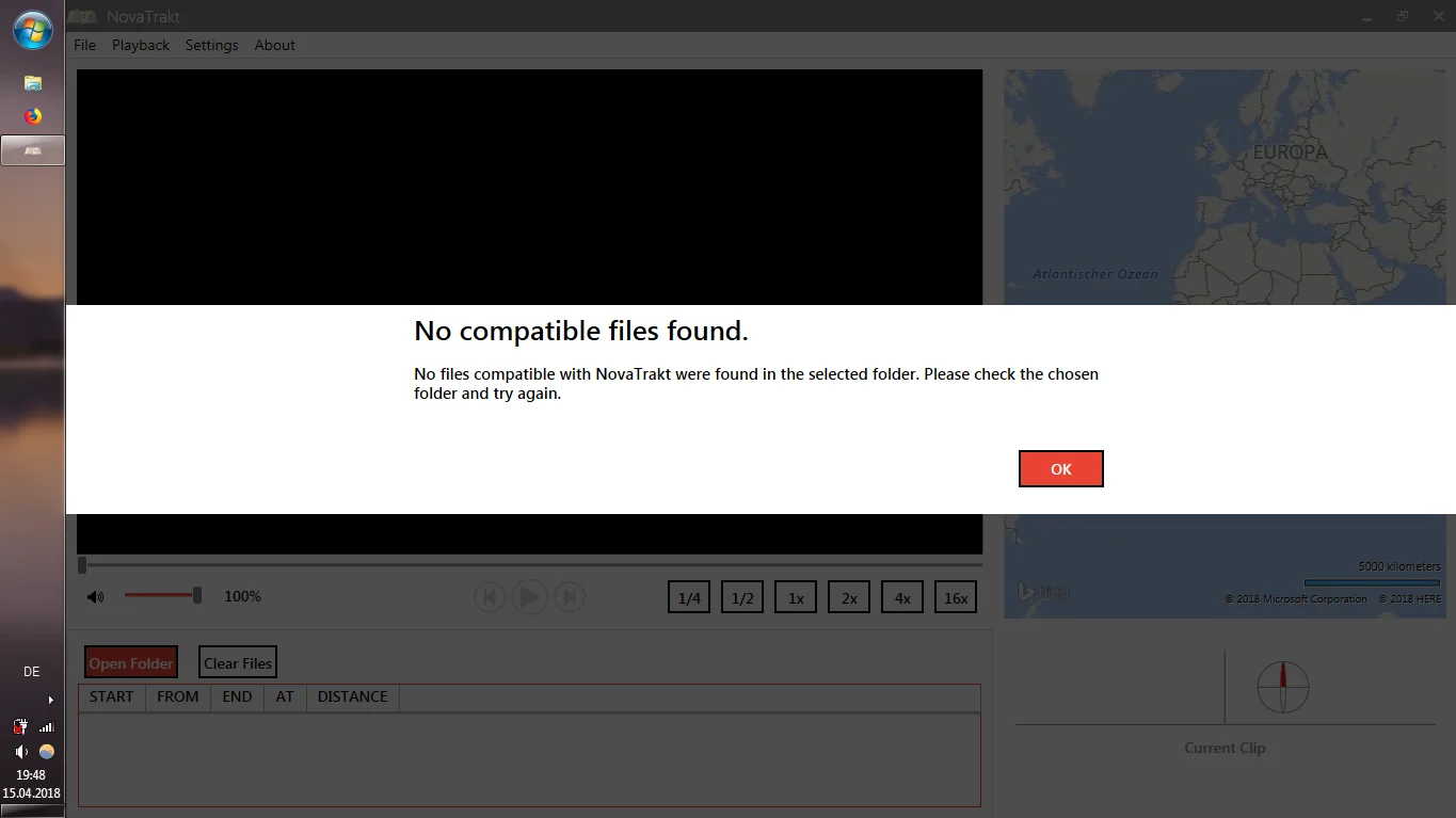

NovaTrakt does not open >2GB .mp4 files
Today I recorded 20 files in 10 minute sequences, 1440p 30fps.
17 of them could be opened and the .gpx extracted, but there is a problem with three other files.
The error popup tells me: "No files compatible with NovaTrakt were found in the selected folder. Please check the chosen folder and try again."
the logfile:
2018-04-15 17:51:40.955 2 ERROR: File at C:\Users\ikarus\Desktop\15.04.18-119\05-traktfehler\2018_0415_113428_005.MP4 does not seem to be a valid video file. File will be ignored.
It seems that files > 2,0GB are not recognized as compatible.
There are no problems with <2,0GB files.
Viofo A119 Firmware A119_170221_V2.02
NovaTrakt 3.06.18043
I hope this can be fixed. Thanks
