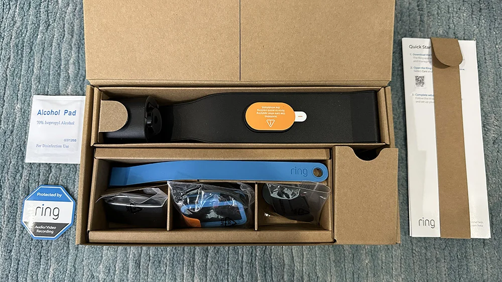

My preordered unit just arrived yesterday.
It's gonna be a little bit before I get to testing and the review since I'm still backlogged some other dashcams to review, lol, but at least they're starting to arrive.

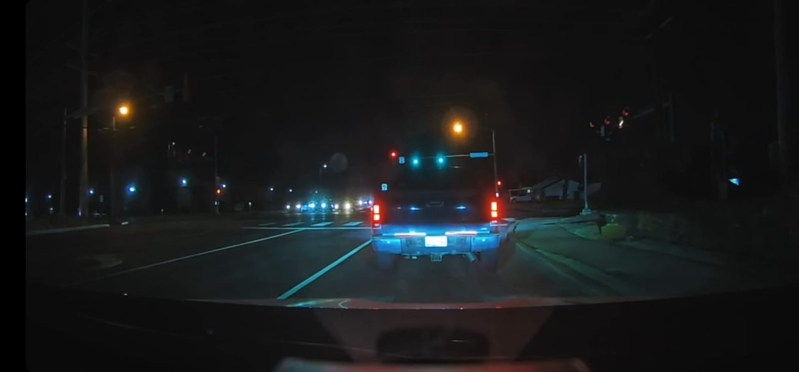

Video quality is pretty poor. It's 1080p30 for the front and rear cams. I still gotta pull more video samples (which is an incredible PITA via the app. It's also unavailable via the web browser, unlike their home security cams, which is surprising), but it only records at 7.49 Mb/s for the front cam and a comically low 1.7 Mb/s for the interior cam.
Due to the low placement, installation is easy, but you get more hood in the front cam's footage. The interior cam gets more of the dash in the frame and it also makes it harder to record any rear passengers.

Footage dont look impressive, or even standard ?
its pretty bad. Its like 4mbps really low bitrate. I was comparing it to some of my old g1w footage and although the ring car cam probably has better dynamic range, I could read plates on the g1w easier I think. the fact that its even close shows how low quality the video is though.

4 mbit are fine for a stationary camera, or even parking guard, but when things start to move at speed with a 1080p sensor you at least want 20 mbit, ideally 28 - 30 mbit. ( H.264 )
