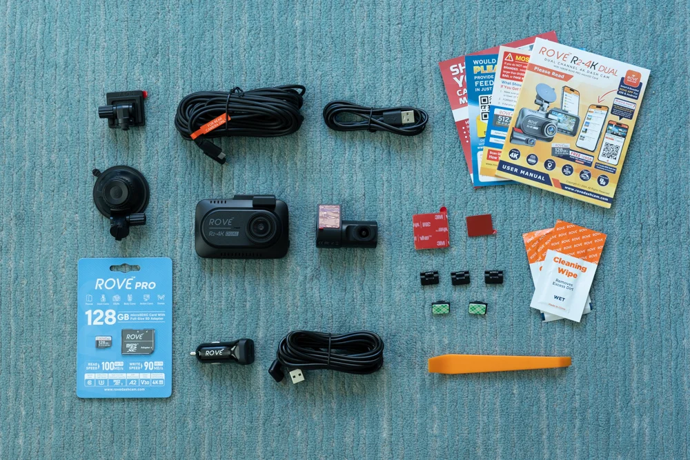

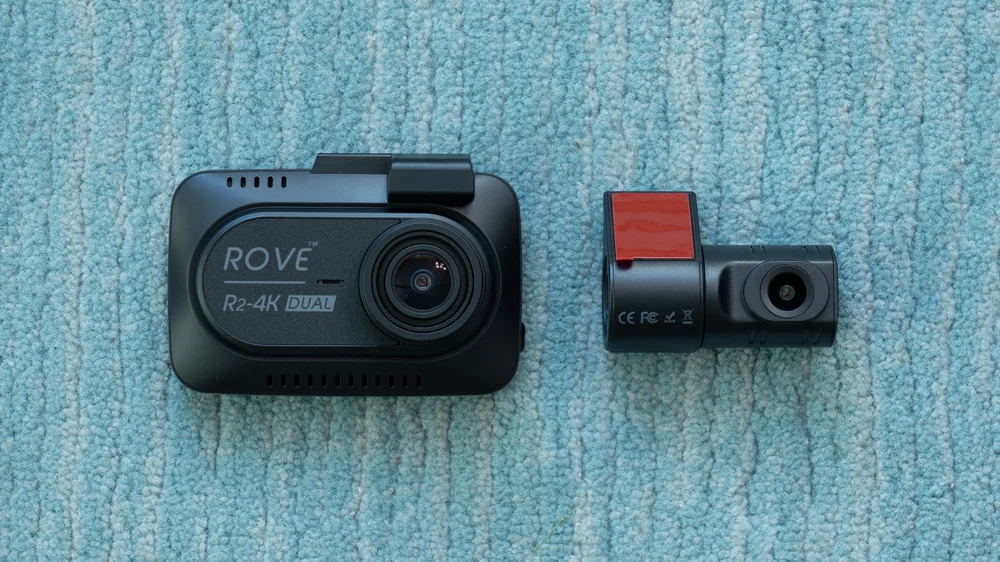

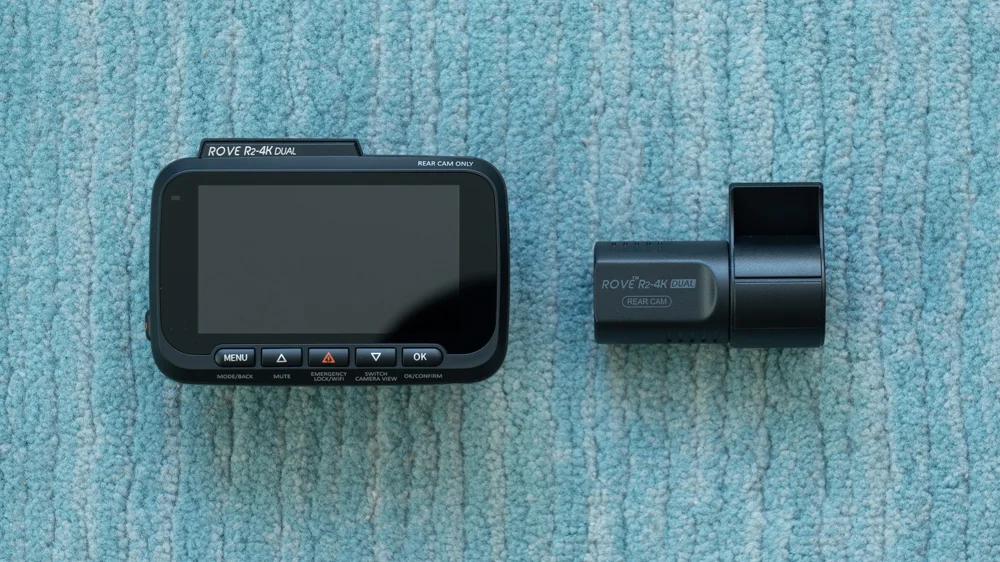

So Rove makes some popular fake 4K dashcams, the R2-4K and R2-4K Pro that use the 2K Sony Starvis IMX335. They just released a new 2CH version, the R2-4K Dual ($199) that uses a 2K Starvis 2 IMX675 up front and a Galaxy Core GC2053 1080p rear sensor. Unfortunately they're marketing this one as a 4K dashcam too.

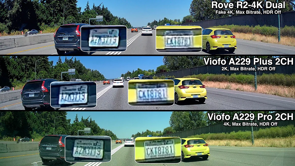

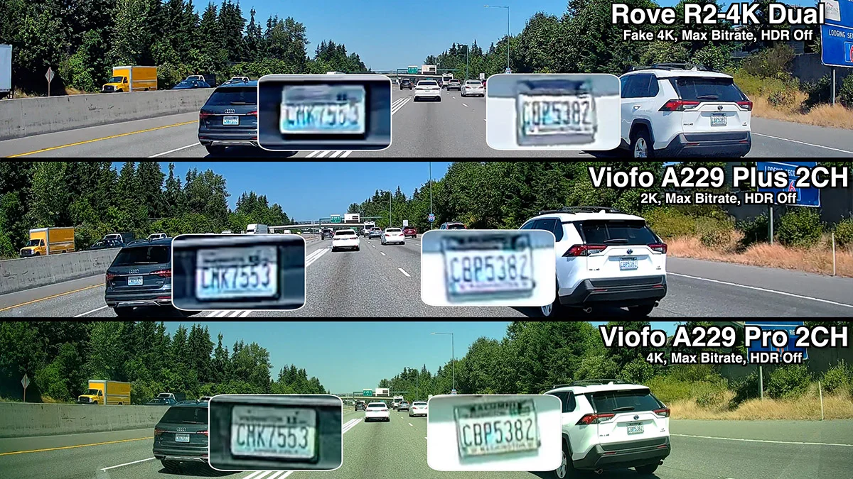

I haven't done any nighttime testing yet, but looking at some daytime license plate comparisons, it starts to fall apart compared to the A229 Plus that also uses the same IMX675 and gets pretty decisively beat out in clarity by the A229 Pro which is a real 4K dashcam.

Oh boy, same image sensors front and back as the 70mai A510 I'm having a look at now (*cough, no capacitor*). Ridiculous they're marketing it as 4k too. You're doing god's work here Ariel.
I think it should be compared to the A229 Plus, but even then that's a better overall package by a country mile. Seems to me they've just taken the parts off the shelf, slapped them together without any regard for image processing and just see if it sticks.
