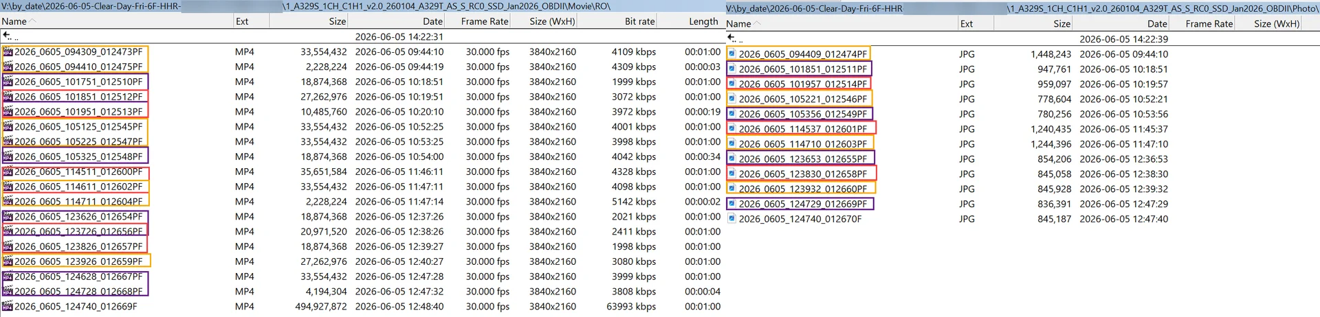

Those photos are created when an impact event is detected in parking mode [buffered parking modes - not low power impact detection]. If you look at the filename sequence numbers for the photo files ["Movie\Photos" directory], they should be similar to parking mode video files for that impact event ["Movie\RO" directory].
Here are some examples from my A329S configured for low bitrate parking mode. This was a 1-channel configuration
