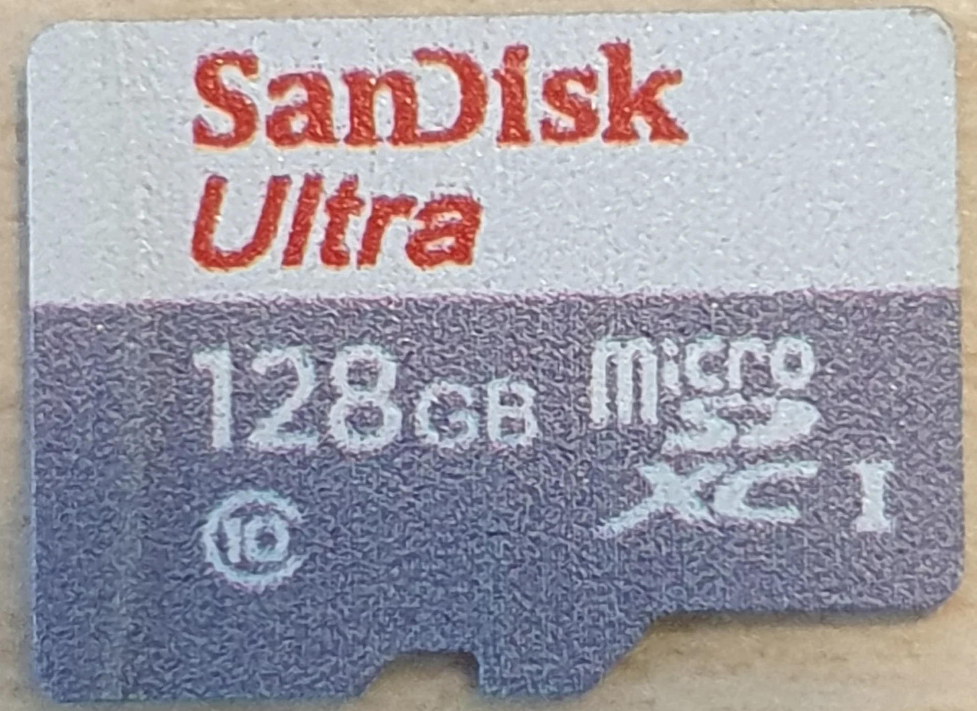

I have a 128Gb SD card

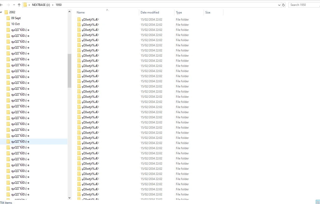

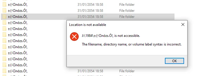

As a test, I have been writing files from my pc to the sd card
I had previously formatted the sd-card in my nextbase 212 and did not format it again when it put it into the computer
It looks like that the files are also being corrupted when written to the flash card by the pc
so far I am up to 45Gb used of the 128Gb on the flash card
when looking through the folders now on the sd card - some are readable, with clear names copied from the pc with files in the folder I can still open
however the majority now look like the screen shot below and the computer cannot open any of them - reports incorrect format

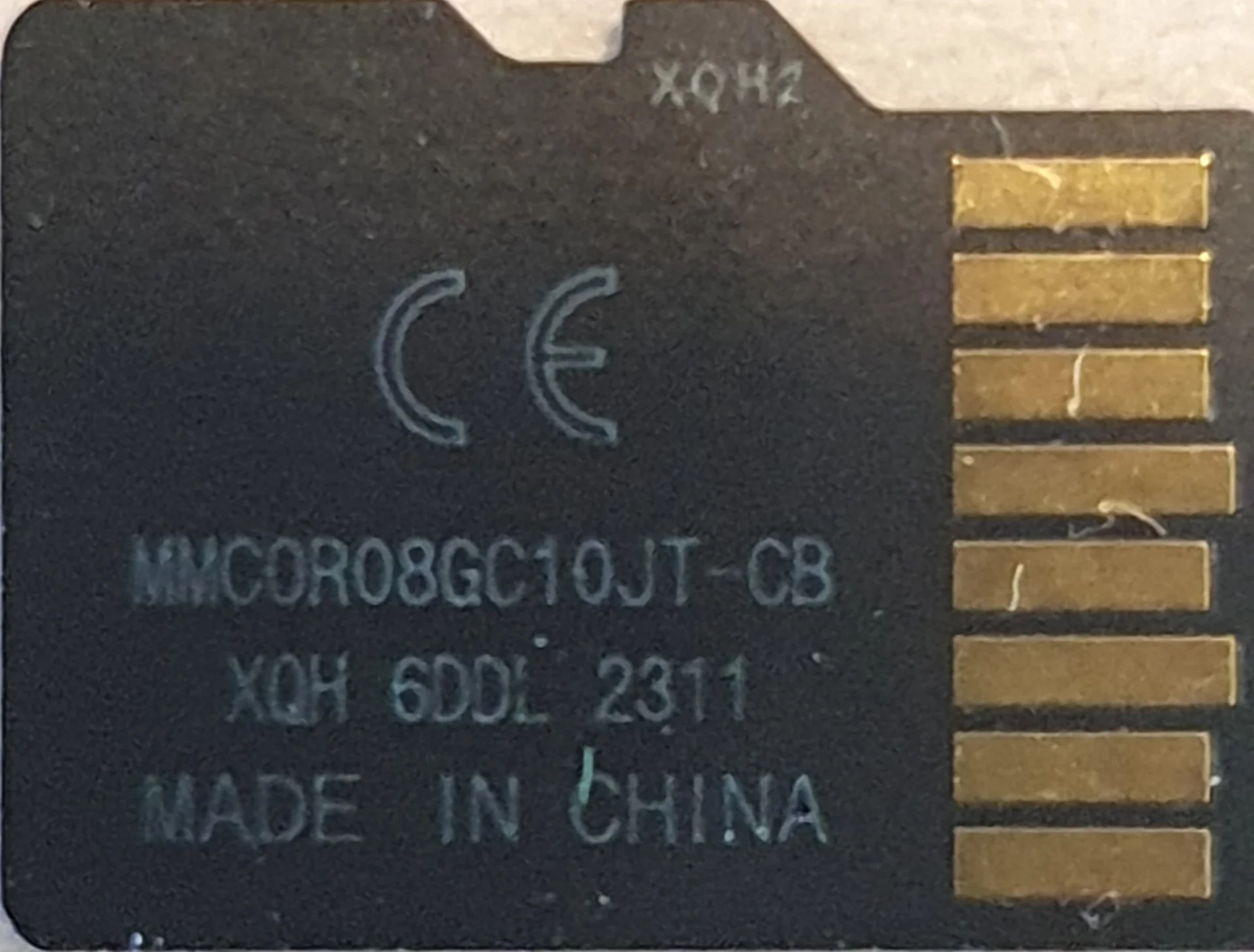

this is the card - the poor quality of the printing on the front of the card is my phone camera not the actual print quality on the card

The last time I saw those hieroglyphics was indeed a fake SDCard where the device was trying to write to an area that didn't exist but the fake SDCard header info said it did
