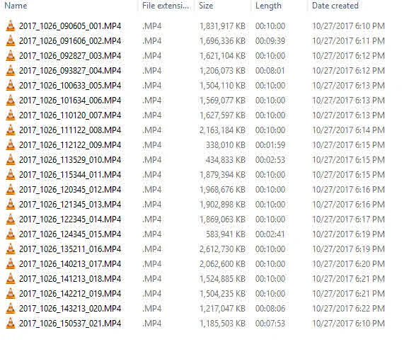

I'm attaching an image of one of my video folders. I have just verified that all the files in this folder are 1080p60 files. Please note the filesizes.
If you see something wrong with this, please let me know so I can fix it.
A 1920 x 1080 video recorded for 10 minutes at 60 frames per second results in a file size of from about 16 GB to 26 GB depending upon what is recorded.
from the provided image of your video folder all I can see the file sizes only up to 2.6gb, not 26gb.
everything else looks OK. 🙂
Oops. How embarrassing! I don't know why I posted 26GB. Thanks to both of you for correcting me!
