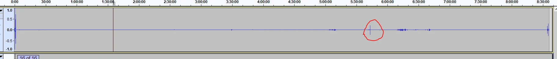

I couldn't figure out the sound finder, it wasn't really needed, I just checked the waveform.
The bit circled above was just an odd tapping noise. I then zoomed into around the 6:30 mark.
Most of it is just rain. The bit circled is the impact noise.
My heart rate has just stepped up a bit. Definitely sounds like a door hitting mine as there is a bounce sound and then a softer thud like a door closing. It's actually painful to listen to.
