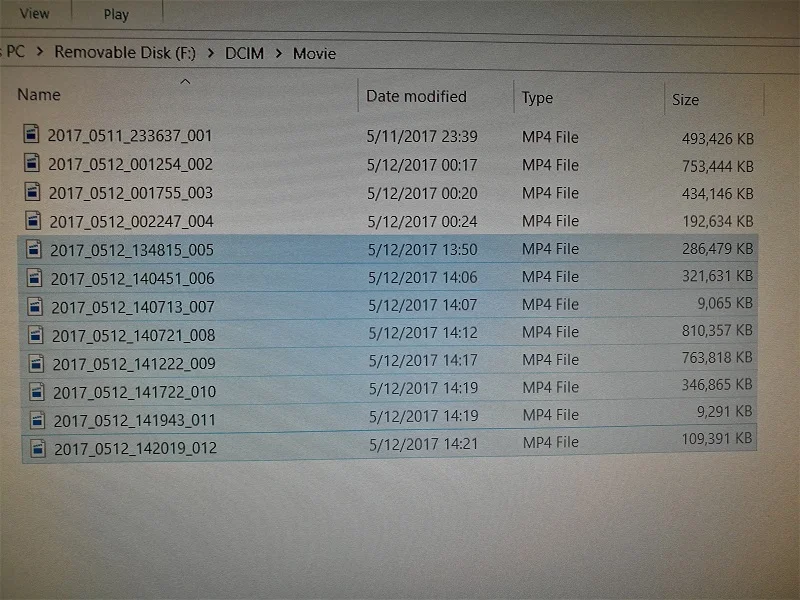

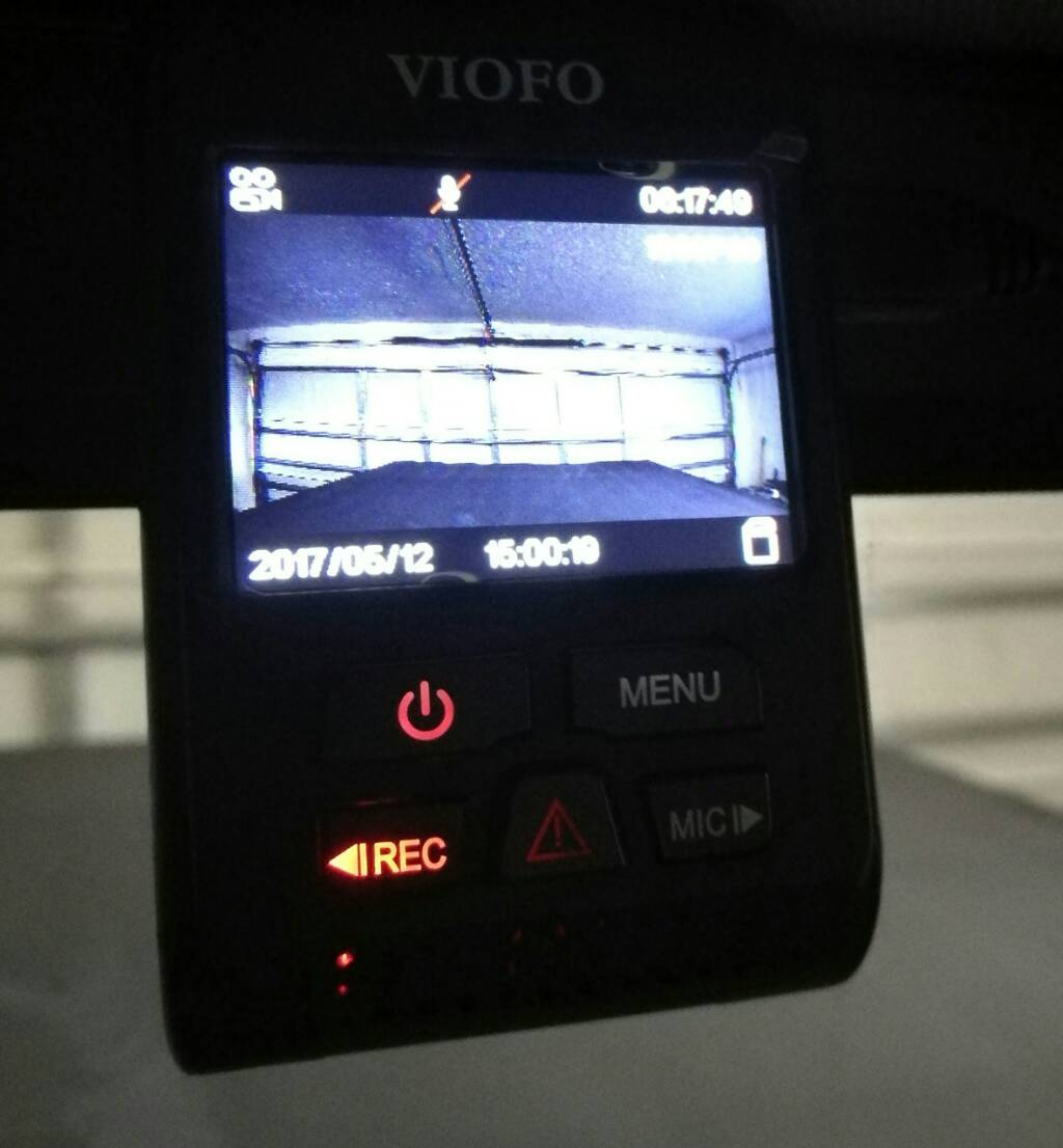

Something doesnt seem right, probable mem card?
Guess what? They both come on at same time.
definitely a progress!
The car adapter that comes with the A119/A119S is known to not fit well in certain cars 12V ports. I believe the adapter is a bit short in some ports, causing the tip to not make full contact with the base of the socket. Sounds like this could be your issue.
This appears to be the problem, however it had worked fine for 4 months. Would it be possible for the cigarette adapter to have become defective prematurely? As I previously mentioned, after fidgeting with the adapter in the socket, it restored power, however after yesterday no matter how I position it, it's no longer sending power to the A119S. I plugged it directly into the USB and it's been working flawlessly to lead me to suspect the cigarette adapter is the culprit.
Possible. I have replaced a couple. Are you using your cars USB port? If so, it's not recommended.
