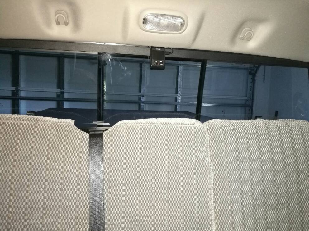

I just noticed this occurring on my A119S as well starting this weekend. This morning, noticed the red recording LED was not on while stopped at a light. Re-adjusted my cig power cable to ensure it was connected properly. Seemed to resume right after. I had already re-formatted the microSD card the night before. My recording duration is set to 5 minutes.

I dont see how this can be a connection issue, since im not losing power or going into a loop cycle. Like i said earlier, the device powers up all the time, just on a couple of occasions so far it wont record and screen stays on but the red blinking indicating recording is not operational until i either A: press record or B: turn vehicle off then back on again.
My front camera is hardwired as will be the rear one in question, after im happy it works correctly.
I cant be 100% sure but the times it behaved this way was - not recording but with screen staying ON, was when vehicle accessory power was ON but engine OFF then turning vehcile engine ON. Something perhaps causes the A119s and not the A119 to cease recording. Obviously a fluctuation of voltage occurs when turning key from position 2 accessory to RUN engine position 3. That's my hunch.

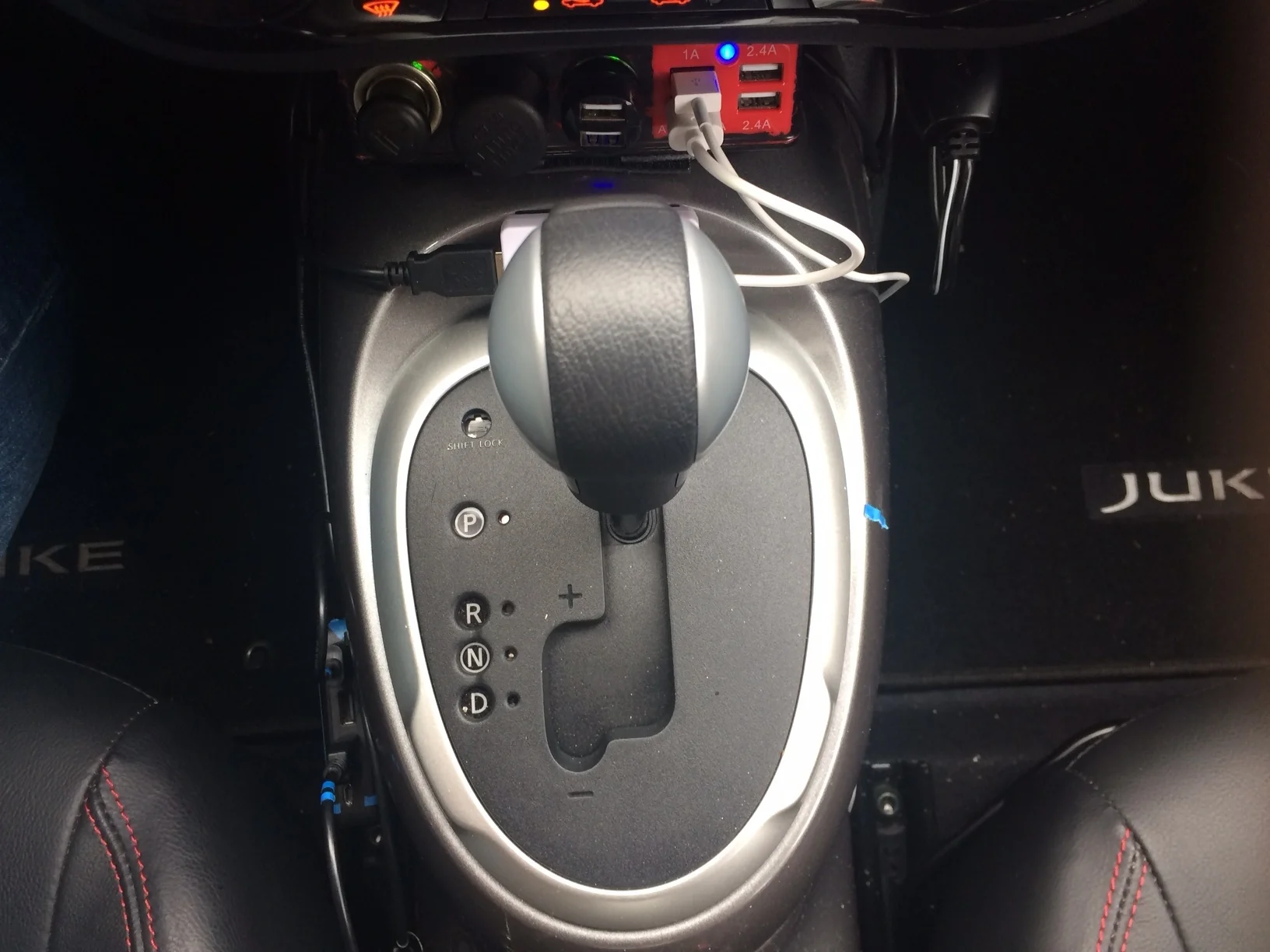

My front camera is not connected to a 4 port USB hub located within under my center console, I had originally soldered the connections inside there to the 12v vehicle supply. I remember when I installed my A119 from 8 months ago, I used the dual cigar port USB plug it came with, I stripped it down and wrapped it in insulating tape, then soldered it to the 12 v vehicle supply, the front camera goes directly to the orginal modified dual cigar usb adaptor which in turn is soldered to vehicle 12 v supply, 12 v is supplied when key is on position 2 Accessory or when engine on. So far no issues with this setup. Although originally I wanted to just plug the A119 straight to the 4 port usb hub , but didnt. I was advised not to do it this way. Otherwise I would not have bothered using the supplied dual usb plug which I soldered to vehicles 12v system.
Basically think of the supplied cigar dual usb plug that comes with the camera. but torn apart and hard connected to the 12 v instead of being pushed into the vehicles socket . My intention was to feed the usb power wire from the rear camera to the 2nd spare usb slot that my existing camera is fed on.

I couldn't wait any longer and just finished hardwiring the rear cam. Guess what? They both come on at same time.
I used my moddified dual usb cigar plug the viofo a119 came with merely connected it to the spare 2nd usb socket.
