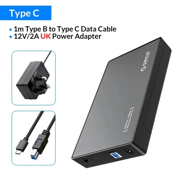

I have been using the following setup for two months:
Londisk SSD 480GB on the SM2258G controller, purchased in 2019.
Placed in an Orico case for an external hard drive, purchased in 2022 without additional power supply.
I use a VIOFO cable to transfer data from the SSD hard drive, 2.5 meters, via a Type-C female to USB 3.0 female adapter
No problems have been noticed since installation.

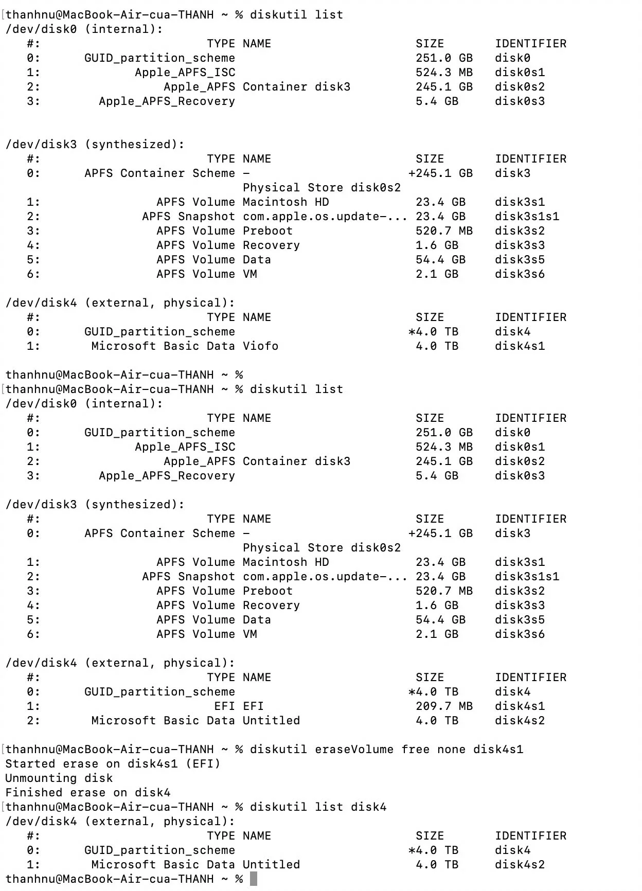

I tried to format with mac and the same problem happen. Only work for first time using, the second time a329 can’t recognize ssd

Hello! In your combination, does the power to the SSD drive come only from the cable that is connected to the camera or also from the power supply unit that is shown in your photo?

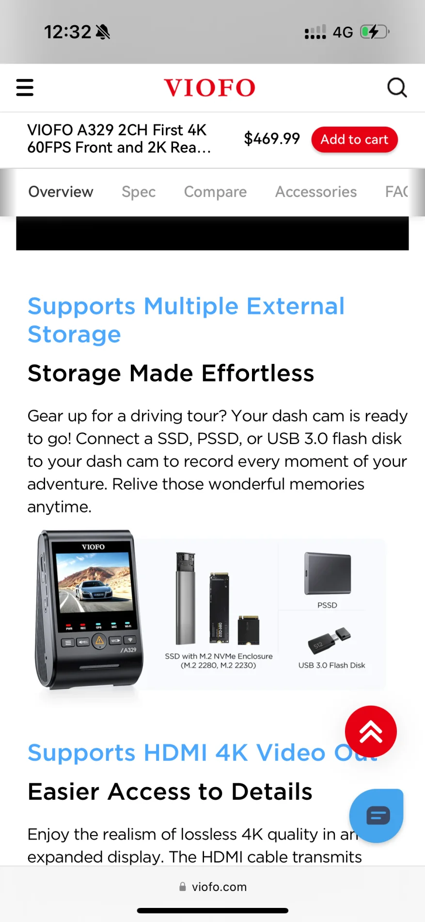

Updated and solved : after back and forth with Viofo team, they really can’t help my case much and suggest me change to portable SSD and remove the info that A329 support Enclosure on thier homepage.
Key take away to get thing done
1/ A329 have very picky with usb cable, you should buy from Viofo due to normal usb cable will high chance make signal gps noise, I have test 6 non-viofo cable from high reputation brand but only 1 xiaomi c to c cable work well, and i am not sure model ( apple iPhone 15pro c-c, belkin 100w c-c, belkin playa, belkin 60w, orico usb c, xiaomi c to c cable )
2/ A329 has low compatibility with SSD, especially SSD enclosures , should buy SSD with Viofo tested product, better just buy Samsung T7 shield.

Very nice post, tag @viofo in this
We also have tested many different SSD enclosures, I don't think it is a camera-compatible issue, some enclosures' quality is not good, so now we removed this option on viofo.com.
We found after some months testing, some SSD enclosures didn't work, even we connected it to the computer, finally, we found it is the SSD contact issue.
After we changed the SSD enclosures, it worked again.
