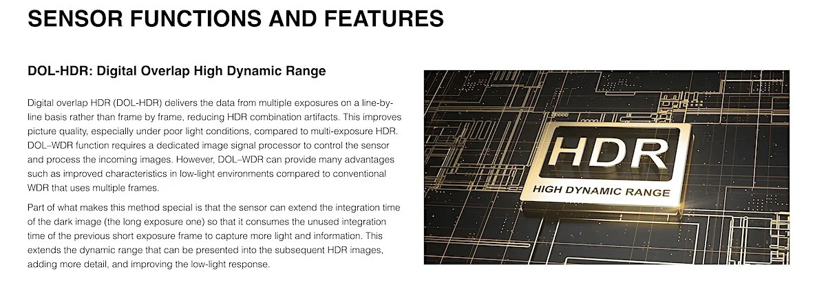

If I understand correctly, Starvis 2 uses DOL HDR - Digital Overlap HDR which uses the camera's rolling shutter to generate a line by line HDR image with as many as 3 exposures per image rather than two simultaneous or sequential frames at different exposures.
This is the sort of thing I mean!
In another thread, Viofo say the DOL-HDR is basically the normal type of HDR, but your reference post implies it shouldn't use multiple frames at different exposures as you say.
That is a very different explanation of DOL-HDR than the one on the Sony site that Cyker linked to earlier! But why does it switch to "DOL-WDR" half way through the paragraph? Pretty sure it means DOL-HDR all the way through.
I think this explanation is far more accurate than the other one, and although in the other one they say that "Clear HDR" is best for dashcams, it seems to be DOL-HDR that gives the better results.

@Nigel, you have a good point about the "DOL-WDR" language. I don't know the explanation but it may have to do with what modes are being implemented.
The Starvis 2 sensor has various capabilities. It is not clear to me which modes have been enabled yet in dash cams. For example, DOL-HDR requires a dedicated signal processor which I know has been incorporated into certain recent CCTV cameras but I don't know that dash cam SoC chips yet have this functionality or if they ever will.
This is why I used the phrase, "If I understand correctly" in my earlier post.
Time will tell about how the Starvis 2 HDR functions in dash cams. I don't yet own a Starvis 2 camera.
Maybe Sony use WDR for when the multiple HDR exposures have been combined into a single WDR image, to separate the input and output of the signal processing. (Even though modern TV's refer to that output image as an HDR image!)
