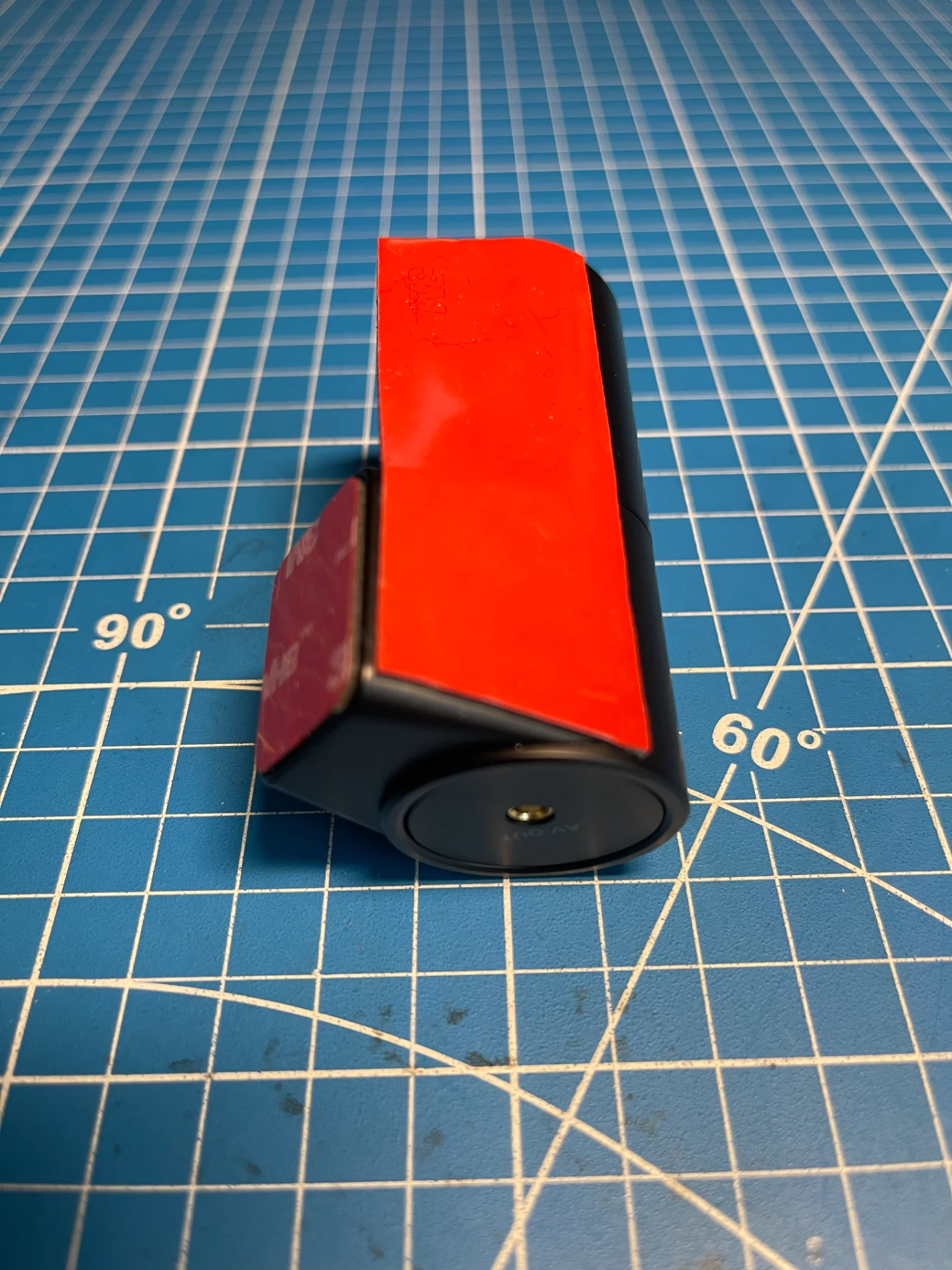

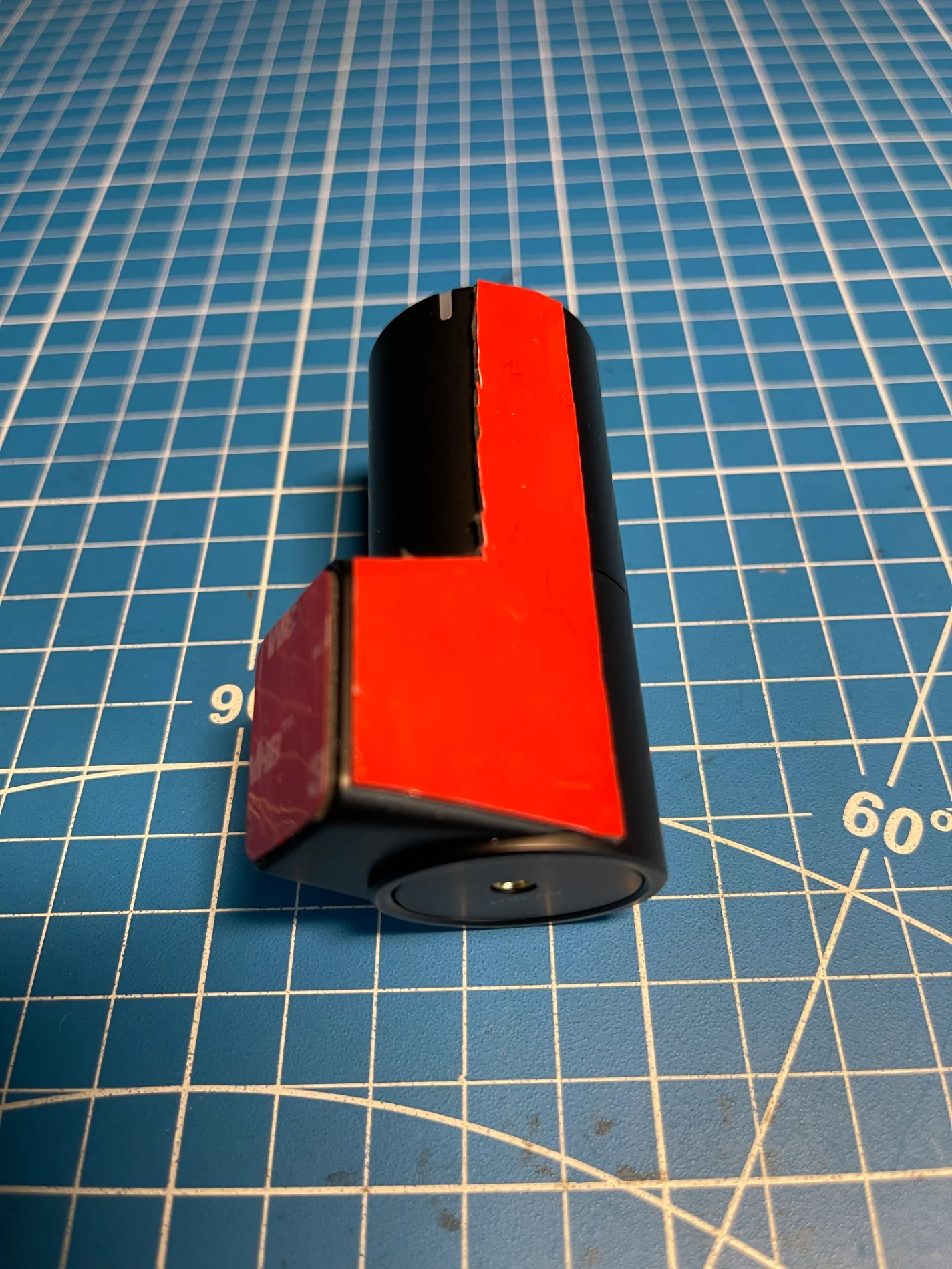

So just a quick followup.. I've been running that tape for a little while and it worked initially, but it lost its grip after maybe 2 weeks or so and I've been constantly trying to restick it. Time to remove and try 3M dual lock instead. 🤷‍♂️
For a bit of silver lining, at one point while fussing around with interior cams, I knocked the S1 4K's interior cam off the mount, accidentally discovering that has a built in quick release mount, lol.
I had some issues with the 3M tape initially, but was able to fix them. Don't stick tape to tape. I didn't remove the tape that came with the interior camera, I stuck additional tape to it and it kept falling off. Removing the original tape and cleaning the surface with an alcohol wipe fixed it.
The 3m dual lock fell off too. Not sure what else to do short of super glue, lol. I’ve used 3 different types of tape so far besides that and added extra tape around to reinforce.

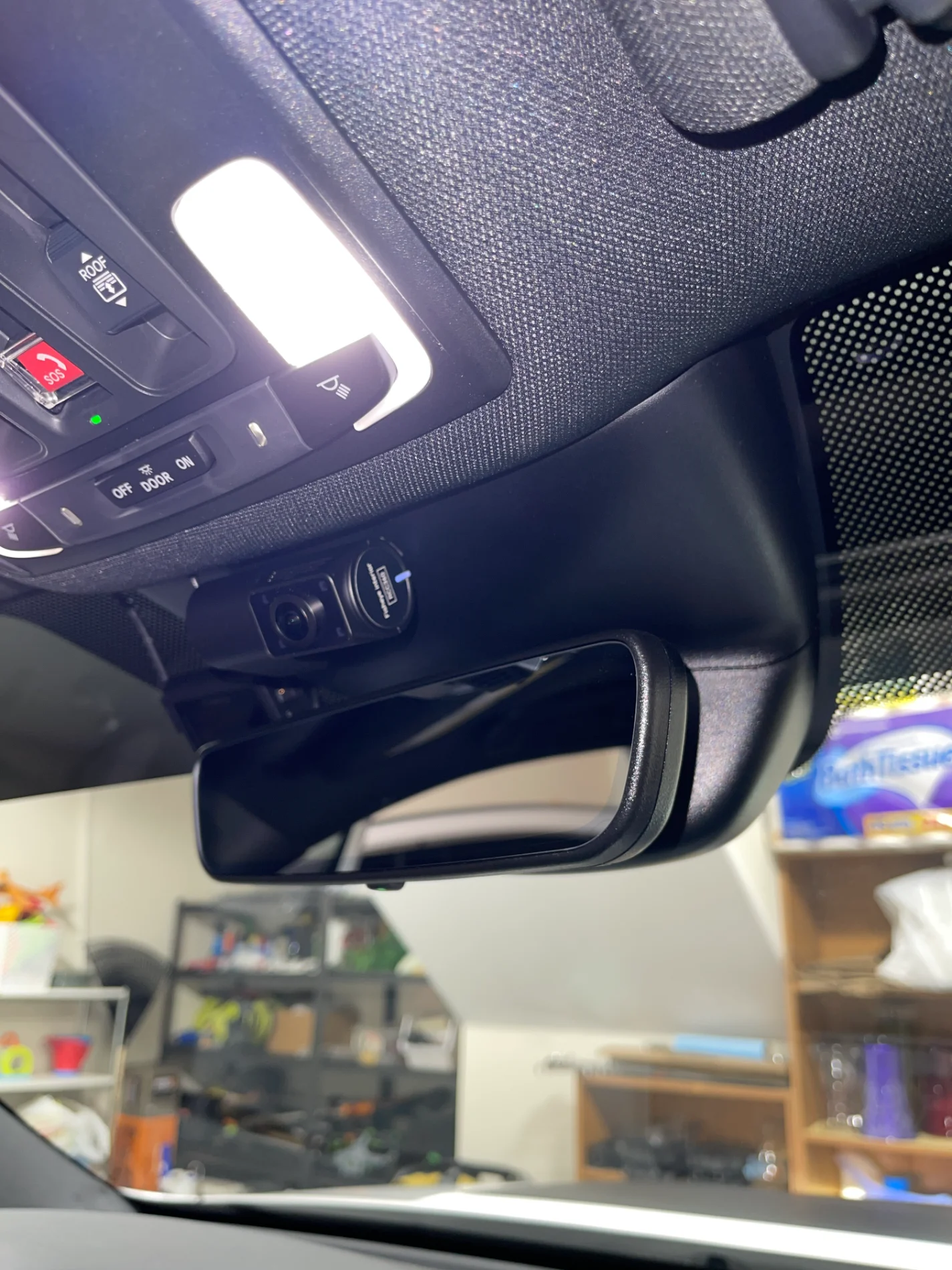

I have only once stuck a camera to the plastic trim ) back side of B pillar, but the Innovv C3 camera stayed in place just fine even in spite of it getting accidental bumped now and then, and that was with the factory sticky pad.
I remind of the magnet solution which for me have worked excellent with smaller rear cameras but even newer more beefy rear cameras.
In your case Vortex, as i assume it is a place you still use going forward, i would put a couple of Neodymium magnets on the back side of plastic trim ( held in place with glue or 2 side tape ) and then a small 3 X 4 " or so 1 mm plate to which you can mount a system.
And then changing you can easy pull plate of magnets to clean tape residue before mounting new system. ( might want to add a thin rubber to the front of the plate so it increase the friction that otherwise between clean metal / painted metal and plastic trim might be lower that ideal )
That's what I used, and it's been fine. Did you properly clean the surfaces before applying it? Alcohol wipes are good.
Yep, with alcohol prep pads. I wonder if it's just the rough texture that's preventing a good bond.
A slight texture can help, in fact if it is too smooth it can help to roughen it with sandpaper. Mine is slightly textured plastic.
One other thing I would say is make sure you secure the cable so that it's not putting weight on the camera and sticky pad.
... I wonder if it's just the rough texture that's preventing a good bond.
Very likely. I've run into that a couple of times. My solution(s) have been to either use foam tape versus rubber (as it conforms to the plastic better) or sand the area where you're going to attach to remove some of the texture. Other issues can also affect adhesion such as outgassing from the plastic for which the only solution for that is time to let the plastic 'age'. I linked to another thread on the subject in post #6 of this thread.

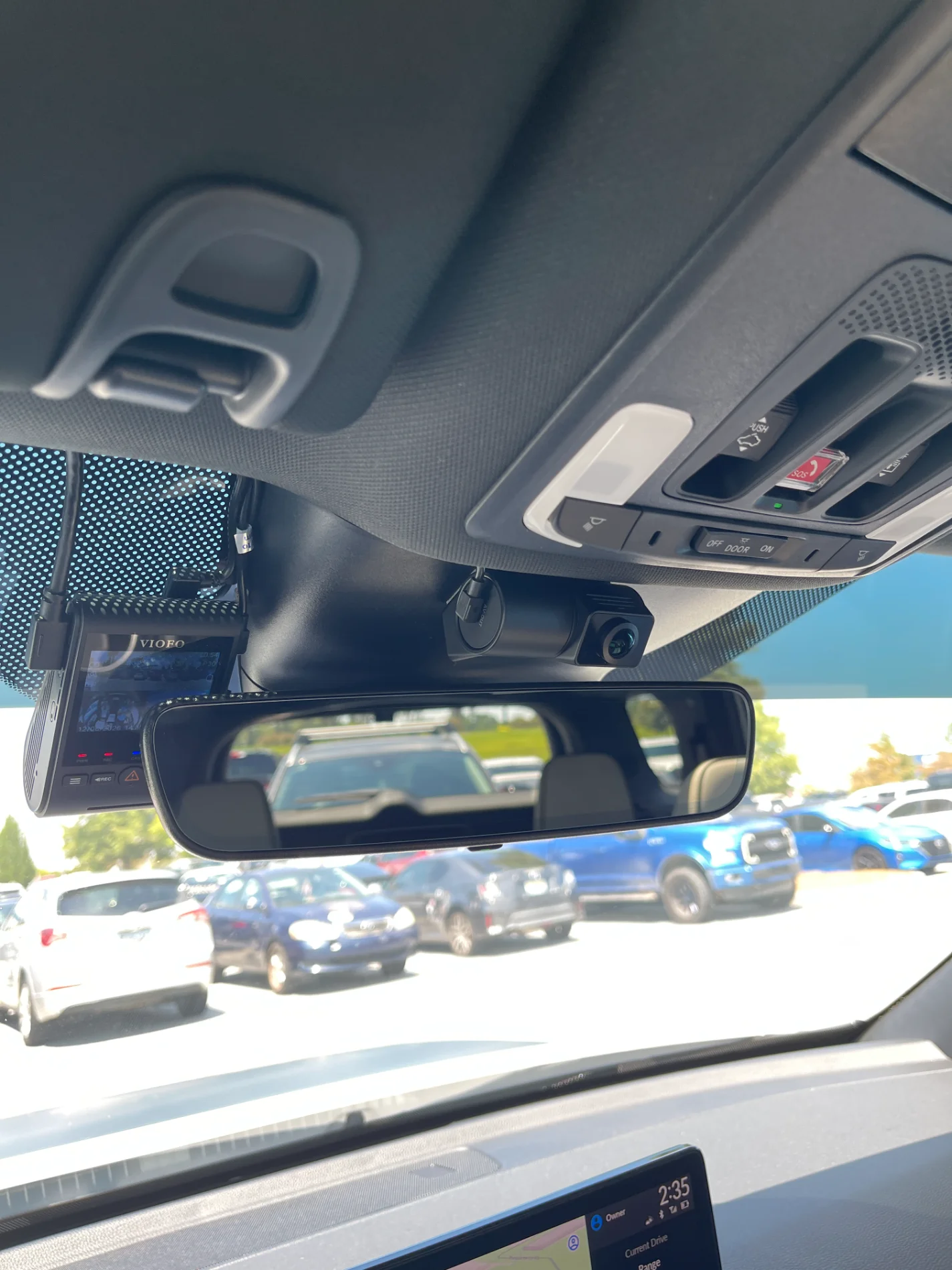

So I still haven't been able to get a good solution here, even after trying multiple different types of tape and adding a bunch of extra reinforcement tape around the mount. I've gotten tired of pushing the interior cam up at the start of every drive so that it's back in position for a few minutes before it falls again, so I've removed the interior cam altogether for the time being. I've still got the Vueroid S1 4K's interior cam running and it's been holding fine, mounted in the same area. It has a wider mounting base and more surface area, plus the mount is directly behind the cam, not off to the side like the A329S' so there's no weird leverage trying to pull the cam off the mount from one side.
