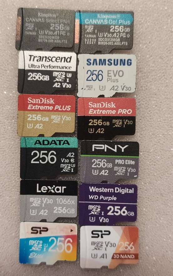

Okay that’s about it for memory card compatibility for the A810, a system i think is fair to say is NOT memory card fussy.
Tested with 14 cards, and found only one to not work.
A picture of most of the test sample collection, others in operation elsewhere.
Updated this in regard to memory card compatibility, i found my Samsung pro plus in the Vantrue N5 system, so far just tested in 1 chan mode, will of course test 2 chan mode too when the A510 have been thru the last memory card i just put in it.
PNY PRO Elite. - grey black - OK
Adata high endurance. - black red - OK
WD purple.( old non QD101 ) - OK
Kingston Canvas Go plus. - black blue - OK
PNY XLR8. white red - OK
Sandisk extreme plus. gold red - OK
Adata Premier pro. black green - OK
Trancend Ultra performance - black silver - OK
Samsung EVO plus. White - OK
Silicon Power elite. blue - yellow - red - OK ( old model no A rating U1 XC1 )
Lexar professiona. grey - Black - OK
Sandisk extreme pro. Black -red - OK
Kingston canvas select plus. Black - OK
Silicon Power 3D NAND. white - brown - NOT OK
Samsung Pro Plus - Blue - OK
