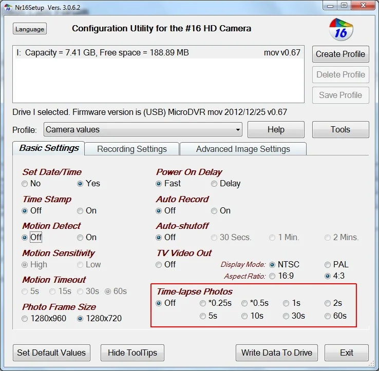

If you want another camera which is not a really dashcam you can use the mini camera 808 #16 which can be found on ebay for about $40 (the real one, not the fake).
Here is a screenshot from the setup program which is showing also the timelapse option.

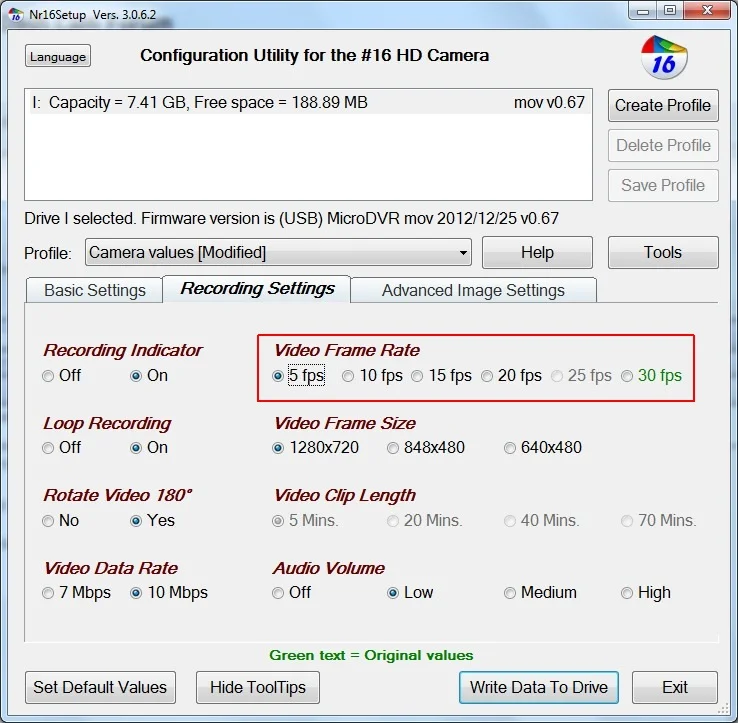

But also have a very interesting option of a recording at 5fps with a playback at 30fps so the video is speed up 6 times when viewing.
The only reason you cannot use 808 #16 as a dashcam is because it cannot start recording when starting the engine and you must to press the start and stop buttons to start/stop recording. But if you really want you can use the Motion Detect mode and keep it always on.
I was using it a lot in my cars.

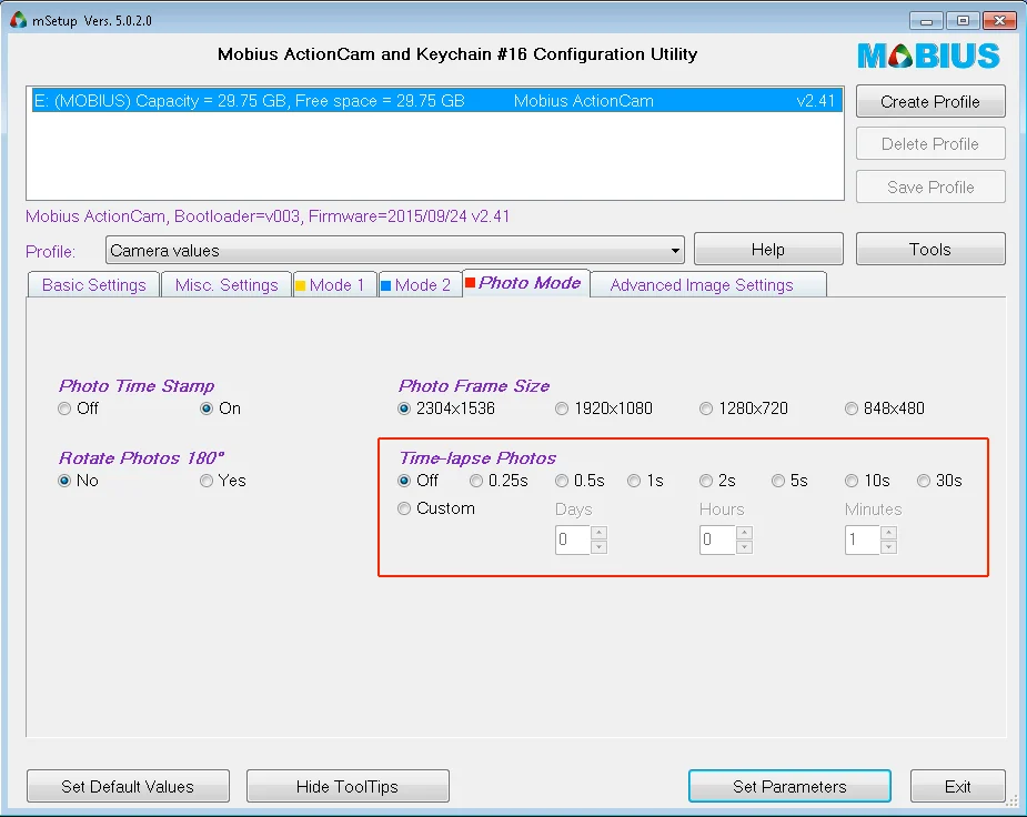

Even five years after its introduction in 2013, the Mobius (1), still offers the most customizable and fine grained or long duration time lapse control available to my knowledge.

it was a feature that was certainly more prevalent in the sport cam sector which is where the Mobius had it's bigger user base so that's a good side benefit I guess, timelapse video is reasonably common among the sport cams, the timelapse photos though is a step above that you don't often see, they were well ahead there, a good thing for a product like this where it's not really a single purpose device as it broadens the appeal

The ability to shoot one frame a day (or days) or one frame per hour (or hours) is highly unique in my experience, at least at this price range and size. This feature is great for wildlife observation for example when you only want to know when something occurred but don't necessarily need to record the event like the time frame when an egg hatched in a nest or a butterfly emerged from a cocoon. We've used the capability at the Environmental Center a few times. In the old days it would have to be done with an expensive device called an intervalometer which would be connected to an SLR with a motor drive.
