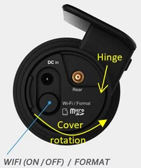

My only complaint there is having to unplug cables to get at the SD card.
Only the power cable, and that's because you do not want to be yanking the SD card out of it's slot with the power on. That'll get you corrupted files (or worse) pretty quickly. A power switch might have been nice, but that's one more thing to potentially go wrong. :-/
Then take the rubber cover off. You can then get the card out without removing the power and rear cam.
I would like to know how bpsmicro gets the card our without removing the rear cam connector to move the rubber cover out of the way.
But like he says, make sure the cam is off before removing/fitting it.

@bpsmicro I get where you're coming from and sure, maybe it's designed that way as a fail-safe... but take the Thinkware F800 Pro, for example, the sd card slot is right there - just reach up and push it in to get it out.
@M8TJT To be fair, he is correct. You don't need to unplug the rear cam cable to get the cover off, just the power cable.
But removing the cover altogether would be a simple fix, I may look into it and see if I can remove it while still being able to put it back on. - Thanks for the suggestion. (y)
I wouldn't remove the cover; the design is not just for aesthetics - it's clearly made to force you to unplug the power cable before you can access the SD card slot. As mentioned earlier, you should not be removing and installing an SD card into a powered camera. The side cover is notched in such a way that the rear camera cable can be left plugged in - which is good, as that coaxial cable does not do well when being constantly plugged and unplugged, unlike the power cable.
