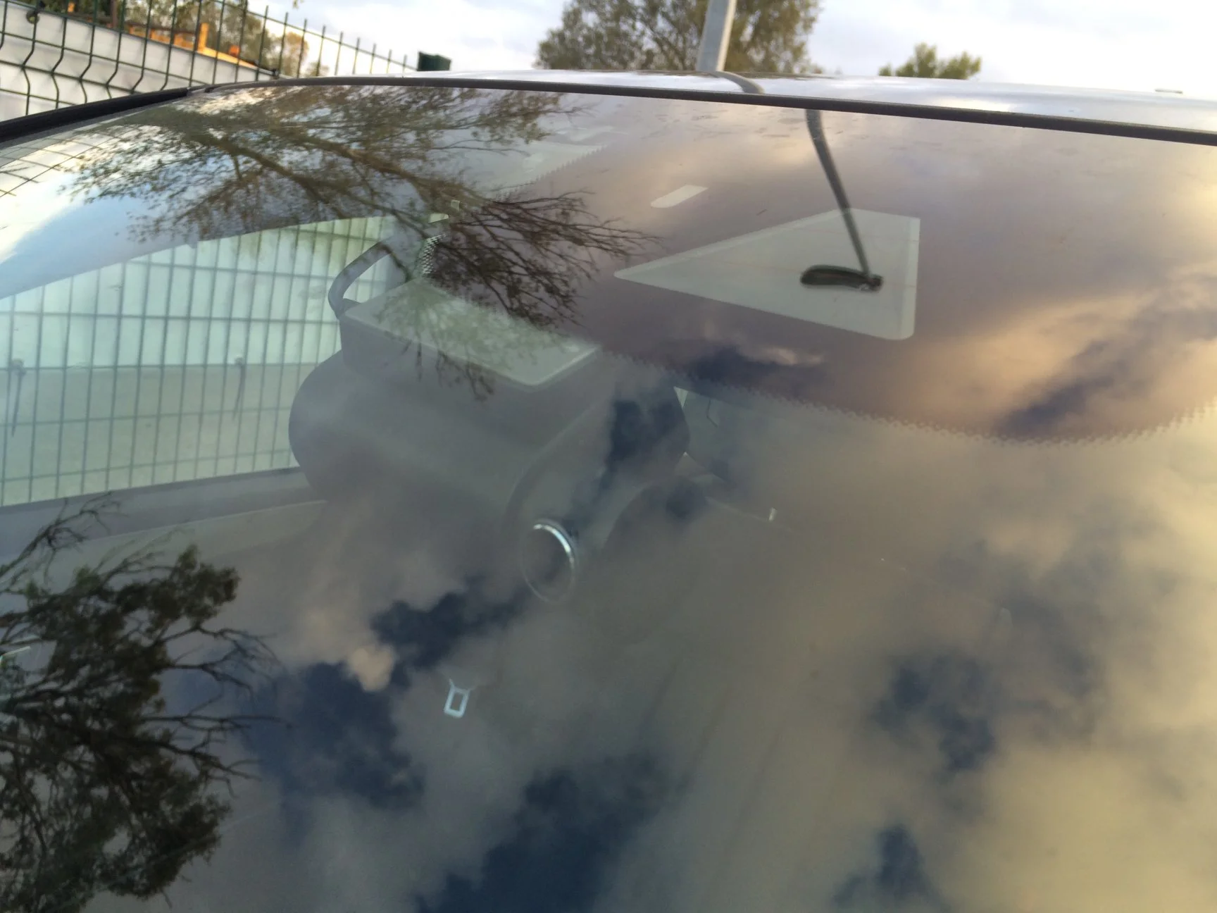

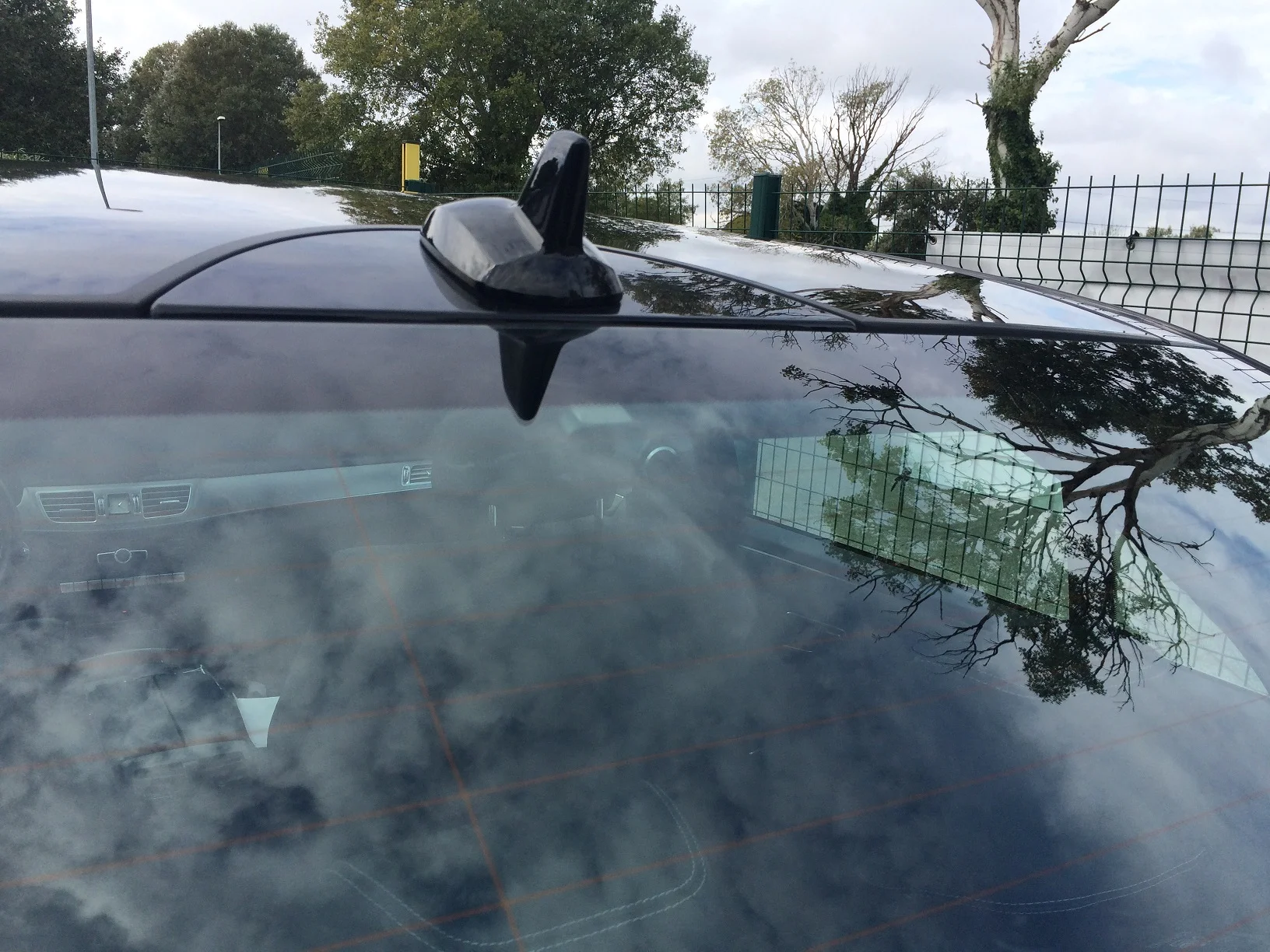

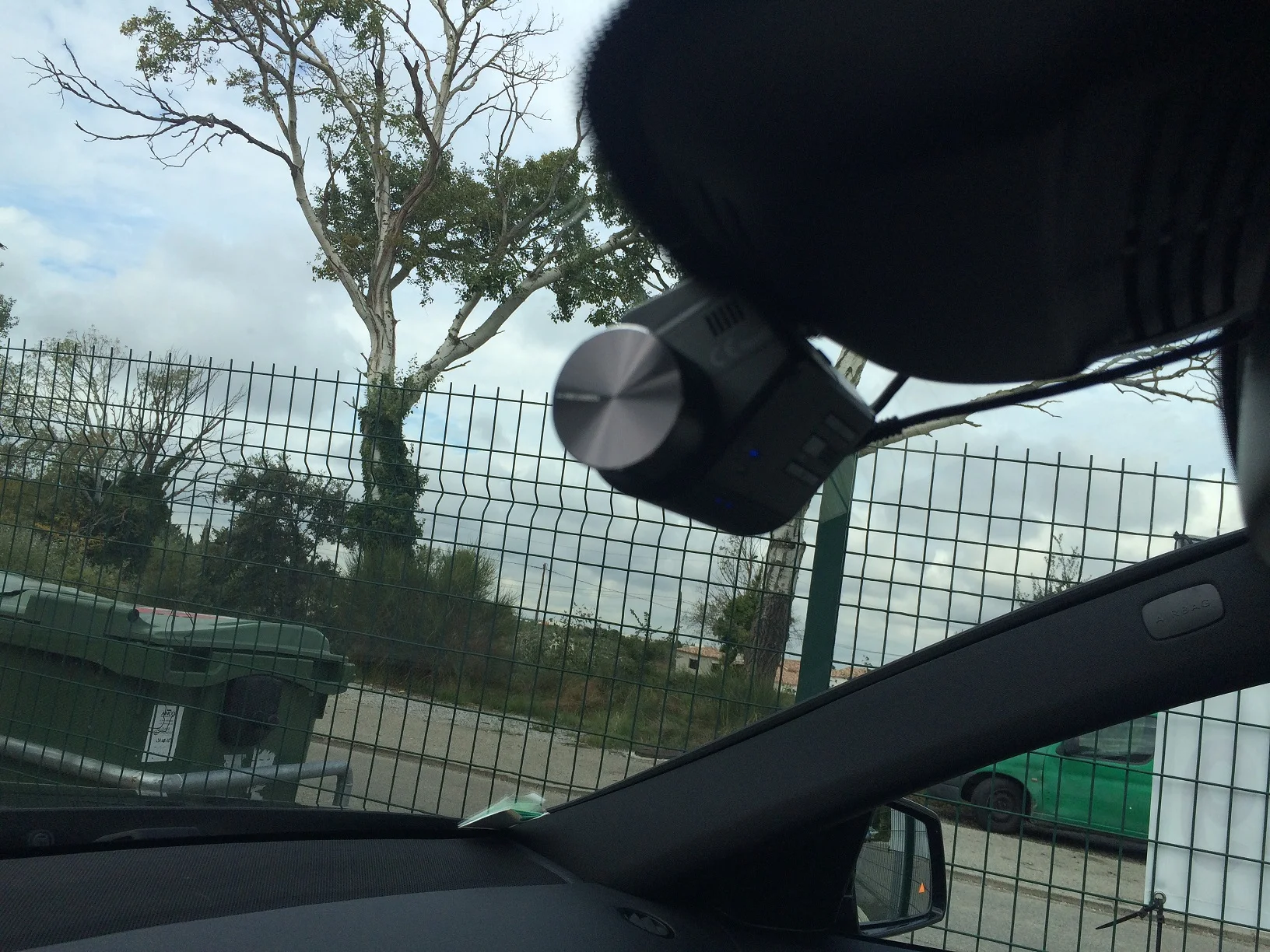

Finally got rid of my blackvue 550 dual (too many, mainly overheating related, problems),
and bough the F750 dual
Install was easy since the same as the BV, with the cables running under the door rubbers/trim
only difference is that my BV was hardwired in the trunk, but as the thinkware cable is pretty short,
I had to hook it up to the fusebox under the hood.
The cable is running from the under the hood, via the outside of the car (but under the body)
en enters on the drivers side (see pics).

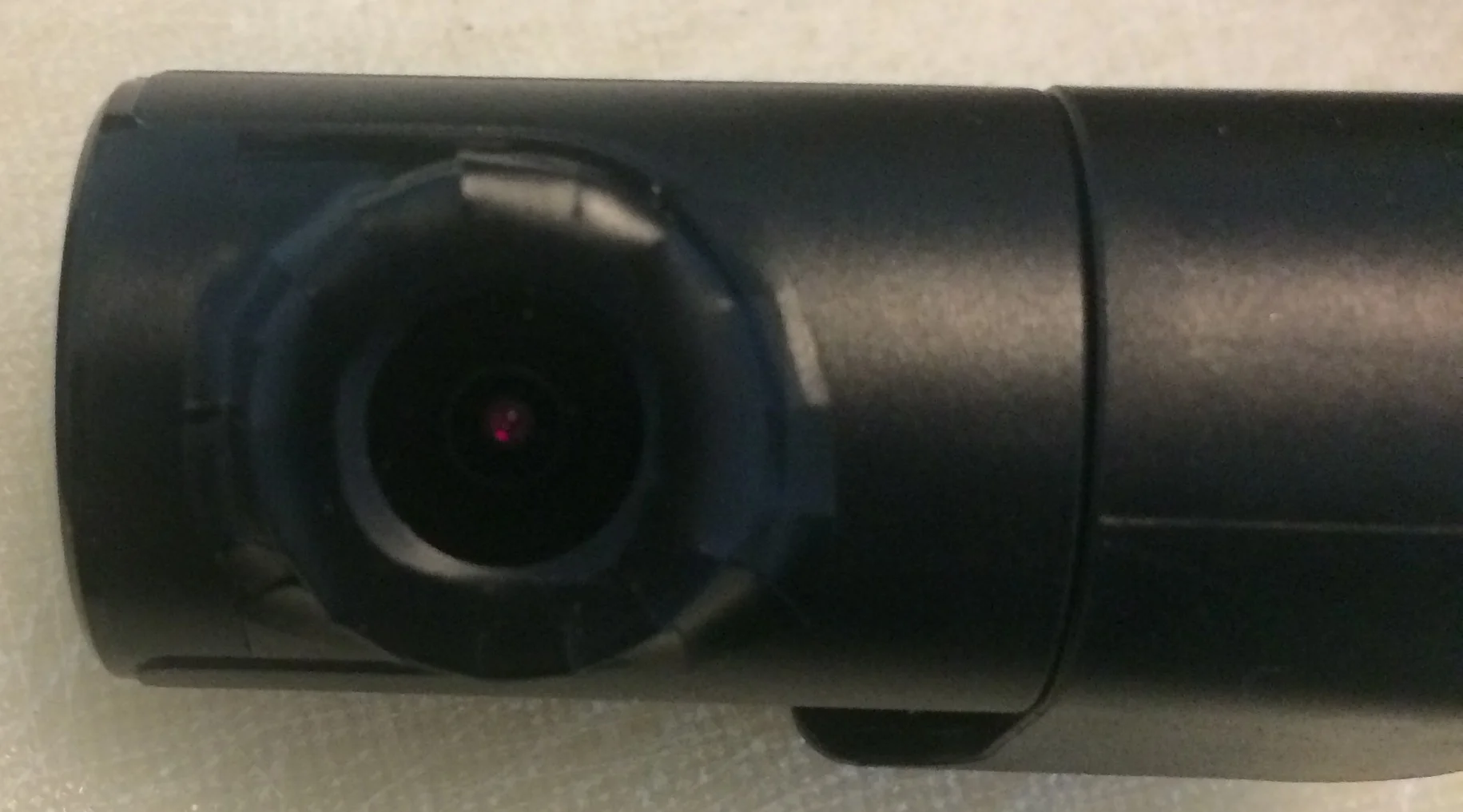

To make the camera less visible I'm gonna change the grey 3m tape with black
and i will put black sticky foil on the front camera.
I also bought a black adhesive sun visor, but not sure if this will really hide the camera.
(I'll try it when i have some more time, as it seems a b*tch to install)
So far the camera works very well, but then again i only have been using it for a day...
It will be interesting to see how it holds up next summer!
I actually thought it would be bigger than it is, but it's not bad compared to
the BV (see pic)

Blacked out the front camera (see pics), next step is to remount with the black tape
and to put some tape on the rear camera's blue led light.
And maybe try to find a solution for the silver ring around the lens...
I really like the camera so far, it seems very "solid".
(But the real test will be the summer, as that's when the problems usually start)

- impossible to switch the led lights off? even in parking mode there are 2 blue lights....
SOLVED THIS WITH THE STICKY TAPE
