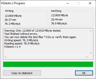

have just got a Sandisk Extreme Pro SDXC UHS-I 128GB SD Card and tested it, is this test result ok?? not a fake card??
Yes, it always reports 1 less.

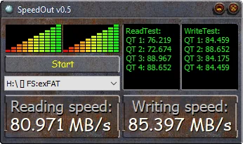

Now test the speed with Speedout 0.5
This is my Samsung Evo Plus 128Gb
Speed is fine so should be problem free. Anything under 50MB/s write speed can be too slow with the HD dashcams.

according to the specifications from the data sheet, the speed should be higher
Read Performance Up to 200MB/s
Write Performance Up to 90MB/s
I can't understand why there are such different results
