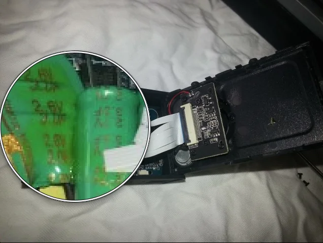

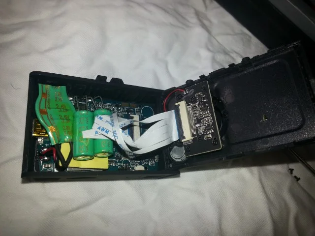

Can anyone tell me what is the component at the left of the capacitors (look at picture) ?
This is the first time I see this component in a dashcam.

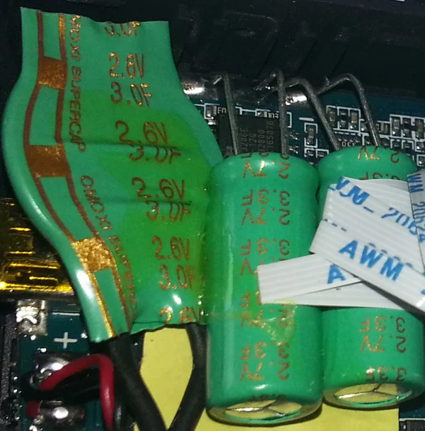

It looks for all the world like a squashed super-capacitor shell. If you look closely, it has the same designation on the side as the normal looking capacitors. - 2.6V 3.oF (or possibly 3.2F)
Yep it's a supercap.
But is it really necessary to add it ?
I guess it could be to save date & time, I think about my G1WCB which often lose date & time.
It appears to be the plastic shell that surrounds a capacitor, kind of a strange place for it to be unless they were looking for a cheap way to shield some part of the electronics for some reason. With out really knowing it is probably best to just leave it there:D You might want to contact the manufacture with the picture and ask him WTH is this in here for:confused::cool:. Actually it is a good quality shield of sorts:ROFLMAO:! Only concern you would have is the capacitors or rated for 2.7V and the shield only has a 2.6V rating:whistle::ROFLMAO:. Just joking with you, couldn't help it!:censored:
Maybe its the RTC battery in there ?
