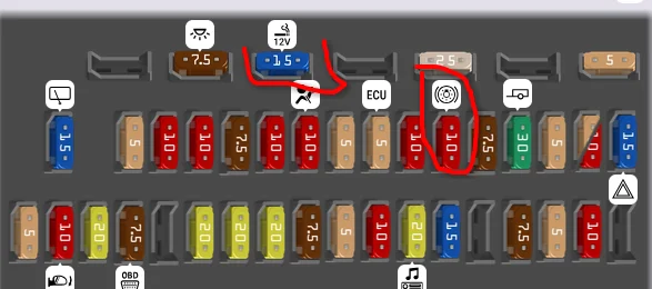

I have new Toyota Yaris hybrid and I need to hardwire Viofo a119 v3 with hk3 and fuse bypass.
I decided to use outlet for acc and stop lights for batterry. I have checked these fuses and it confirmed that stop is always powered and outlet only after car turned on. Everything looks good, but when car is turned off dashcam is still recording, despite switch into parking mode. I'm really confused. Did I use wrong fuses or dashcam screen doesn't show difference between parking mode and normal recording?
Has someone hardwired Yaris 2020-2026 or Yaris cross and can share knowledge how to hardwire it correctly?
Did you enable parking mode in the dash cam's settings?
