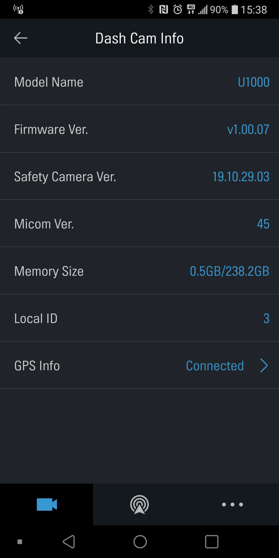

this is the frimware im running on my u1000,
dose this look right for uk so i can pick up speed cameras, πŸ€”πŸ€”πŸ€£
