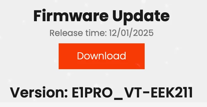

@hgj Just FYI, There is another later Firmware version available for the E1 Pro since your 10/21/25 update
  • Like
Reactions: hgj
I just upgraded the firmware to the most recent version today.
Easy peasy. Downloaded, and uploaded and installed without any issues.
