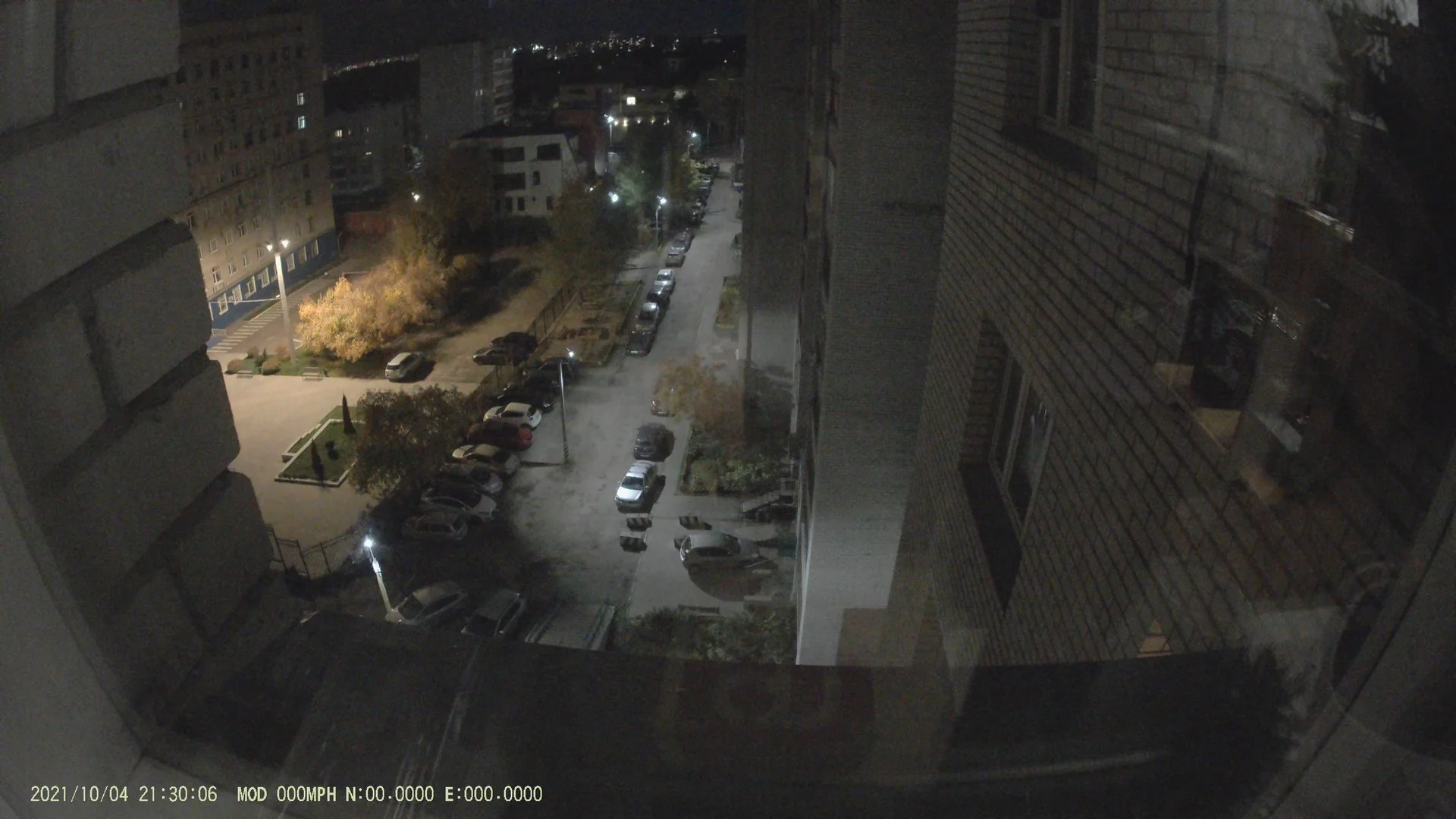

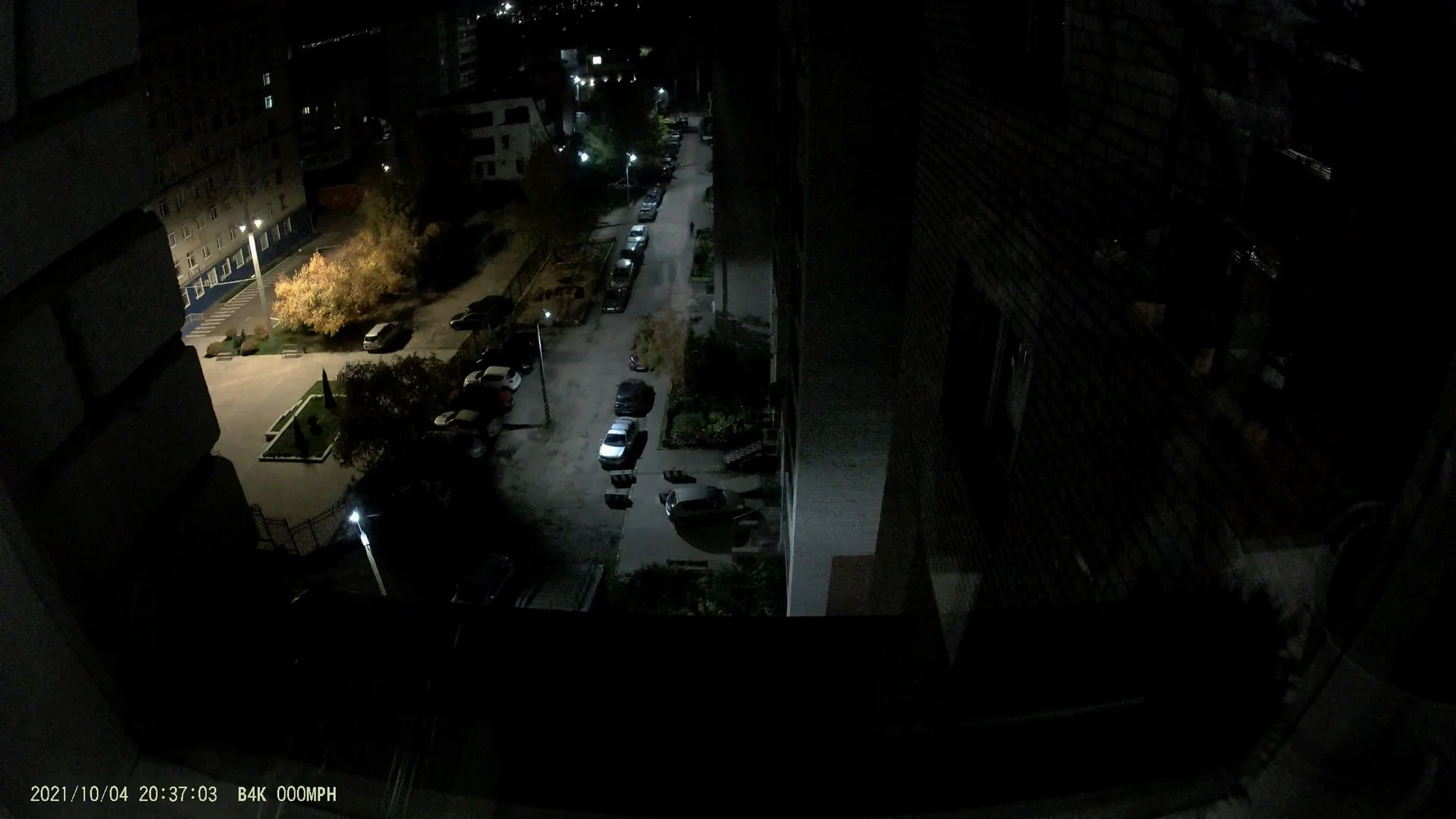

We started testing the modified version of the firmware...
Changes:
Code:
-bitrate
-contrast
-black level
-gamma
-noise suppression
-reduction of oversharp
-exposure metering
-other improvements...
I hope you haven't slowed the shutter speed to get that brighter darkness? It needed a faster shutter speed...
None of the exposure values were harmed...)
Along the way, you will also need to experiment with ISO.
And since I don't have this gadget, my friend, who lives 1500 kilometers from me, will check the firmware...)
Excellent, very interested to see the results, I think this camera does have good potential for improvement...
It would be good to increase the shutter speed a bit in darker daylight, and maybe also at night.
šŸ˜‰ Thanks for your efforts, we will try. A start has already been made and a good start.

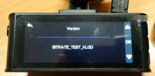

What I saw - so far only "on the table" in the laboratory, but I liked it! šŸ‘
Now I need to put in the car, check, compare.
Overall bit rate 3840x2160 : v009 - 27.1 Mbps, Mod - 42.1 Mbps
Here is information from Mediainfo - FirmWare v009 and Mod

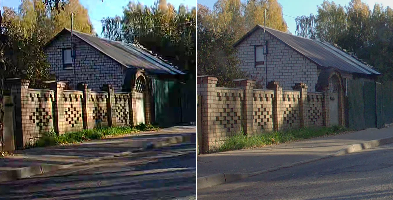

I prefer more sharpness at the darkness!
Excessive sharps are harmful, this has long been clear to everyone.
Here the question is in understanding this and the manufacturer's reaction to this porridge of pixels.
You look at miniatures or full sizes on a small screen and you can immediately see that
some screenshots are less sharp. But as soon as we scale up to 100%, then everything
falls into place. Less sharp screenshots show the maximum level
details, and those that seemed sharp are hopelessly spoiled by a sharpe and lost in detail.
This is what producers & managers do in advertising. In YouTube reviews, the picture appears sharp and
detailed, but as soon as you start to watch the originals in full size,
then you involuntarily think: "Excuse me, but where is the quality???"...
There are illustrative examples for understanding the situation:
https://videoregforum.ru/threads/datakam-6.1744/page-377#post-129802
1. Detail - the degree of elaboration (presence/absence) of the details themselves (not contours) in the picture.
That is, we see individual leaves - there is detail, we see a green mass instead of leaves - there is no detail.
2. Sharpness - the clarity of the outlines, the general perception of the degree of clarity/blur of the picture.
And in fact, the combination of both parameters is important, but the first is much more important ...
Good article on this topic: https://blog.andrewbondar.ru/rezkost-fotografii/
With all of the above, there are lovers of excessive sharpness...)

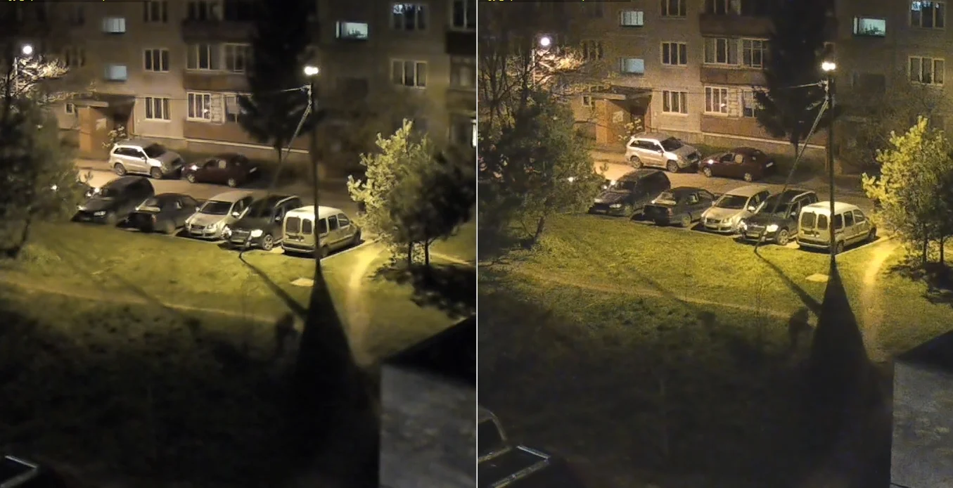

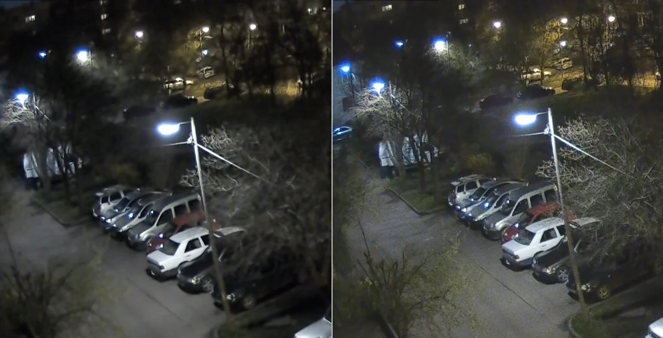

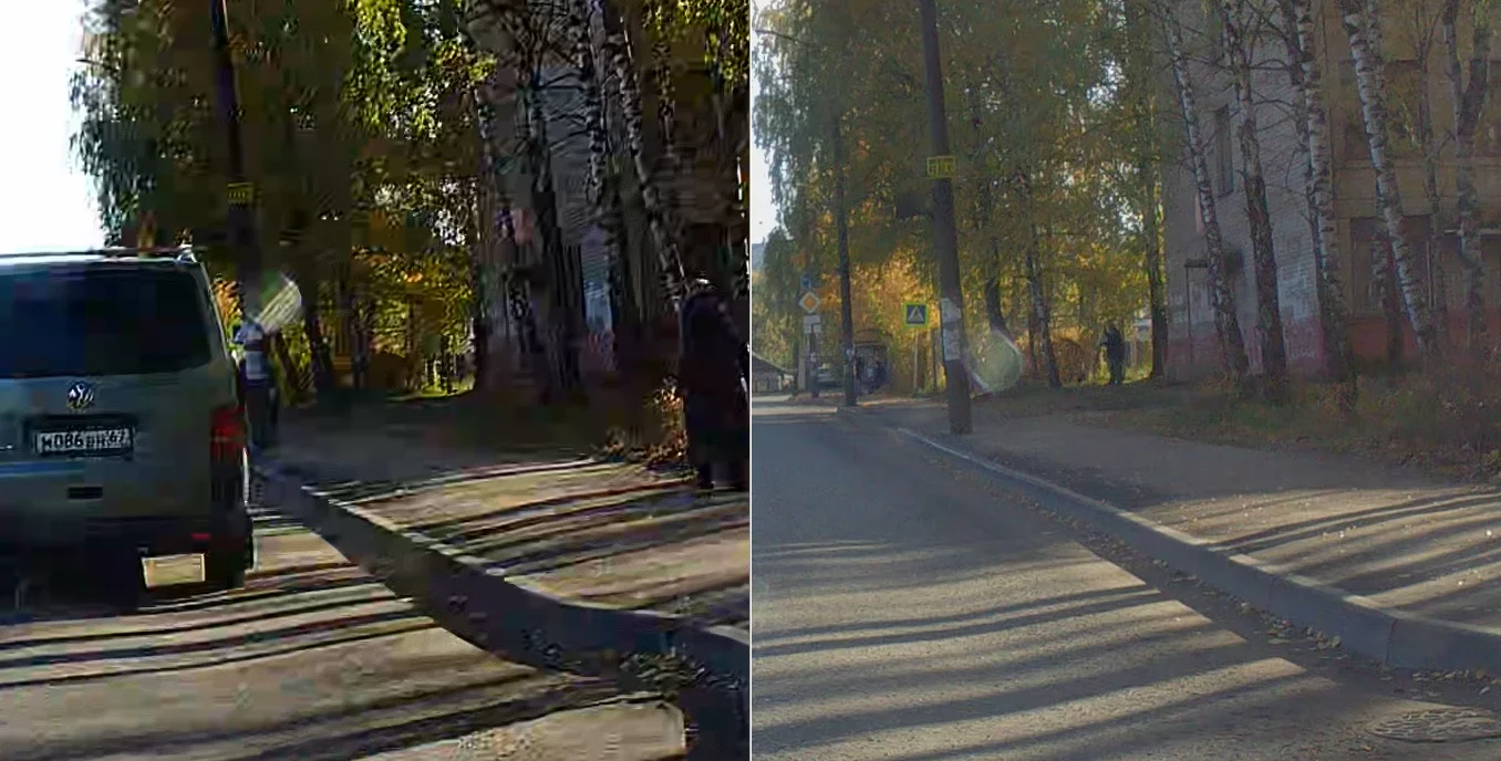

We have just started working on the firmware, so everything is still ahead of us...)
There is still work to be done on ISO and shutters. Also, more optimal
parameters of detail and noise reduction will be selected...
This is an example of how it was before and after the modification.
Do not forget to open pictures in full-size and original quality...
Crop scale 100%:
Sharpness look horrific compared with the mod footage, it is strange so many brands have this in their cameras, and even high end systems by famous brands.
As it can be seen it is indeed something the makers should focus on as there are huge gains to be made.
