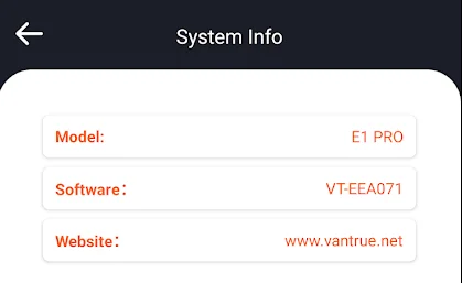

I updated to VT-EEB051, the camera displayed "update successful", but it still shows VT-EEA071 in the menu when I check the current FW.
Hi Tony, may I know if you update the firmware via the app or via the sd card?
SD Card. I did not see an option to update the FW via the app, just a link for where to find the FW.
VT-EEA071 is newer than the 051 version.
On the website the release date is 18.02.2025 for 071.
You should have the latest version.
Thanks. I'm not used to their naming structures.
That's the same version number that my E1 Pro is showing in the menu structure after the update. I am confused because the website indicates version VT-EEA071. Did we get the right version??
I would hazard a guess that it's internal testing perhaps or staged rollout of a stable firmware. Public website seems to be slow on rollouts. The E1 Pro isn't on sale yet is it
I received an update from Vantrue - VT-EEB211 is still undergoing internal testing
I was prompted in the app to update the firmware and it went perfectly without a hitch using the app. The key thing here is that once the update is available, the app needs to be started first while the phone still has a data connection. If you connect to the camera wifi first and then start the app, the app can't check the firmware. It may also be that the app needs to have connected to the camera at least once so that it knows which firmware to download as soon as the app has a data connection.
