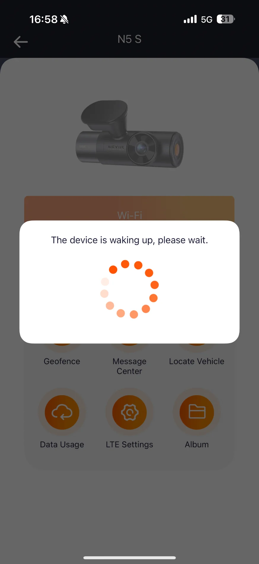

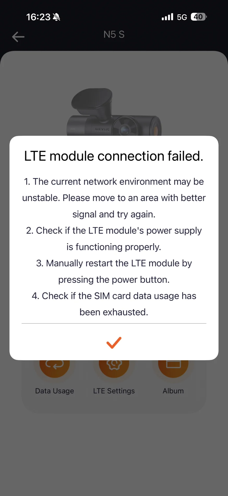

Hello,
I just purchased a vantrue LTE module. Tried to pair it with my n5s with a rogers sim card in Canada. The module got activated successfully but when I click on LTE its giving me error. I have internet through the module hotspot though. Getting the errors in the screenshot below. I tried using the Vantrue simcard and everything worked fine so its not even a firmware issue. APN setting is not an issue as well since I have internet through the hotspot. Anyone facing similar issue? Thanks
Sorry for the inconvenience. I’ve just sent you the latest LTE module firmware and please try updating to the latest version first.
After the update, insert the Rogers SIM back into the LTE module and check if it fixs the issue.
If not, please check:
Whether all three LED indicators on the LTE module light up normally
Whether your phone can connect to the LTE module’s Wi-Fi and browse the internet normally
Let me know the results and we’ll continue to investigate if needed.
