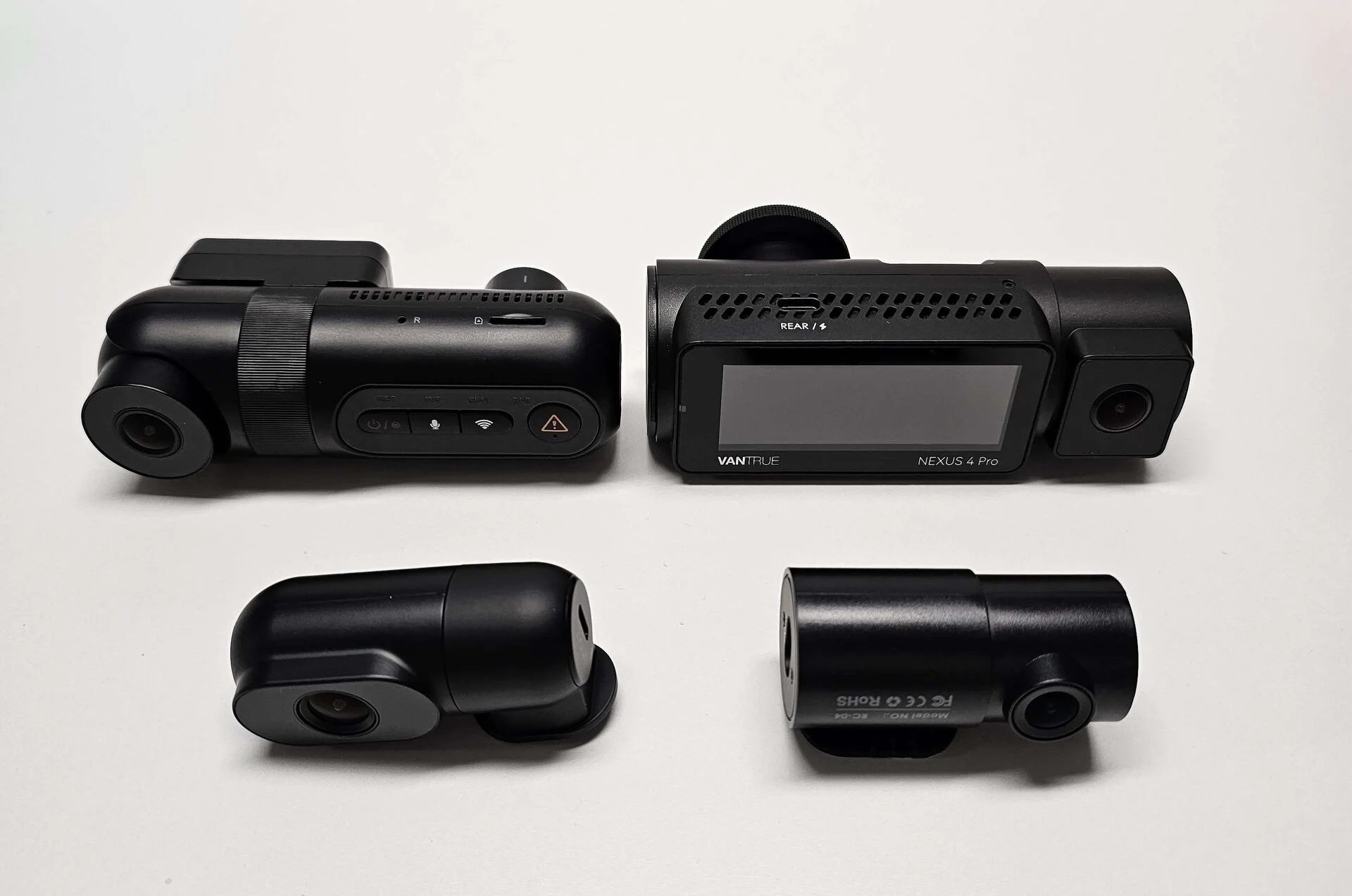

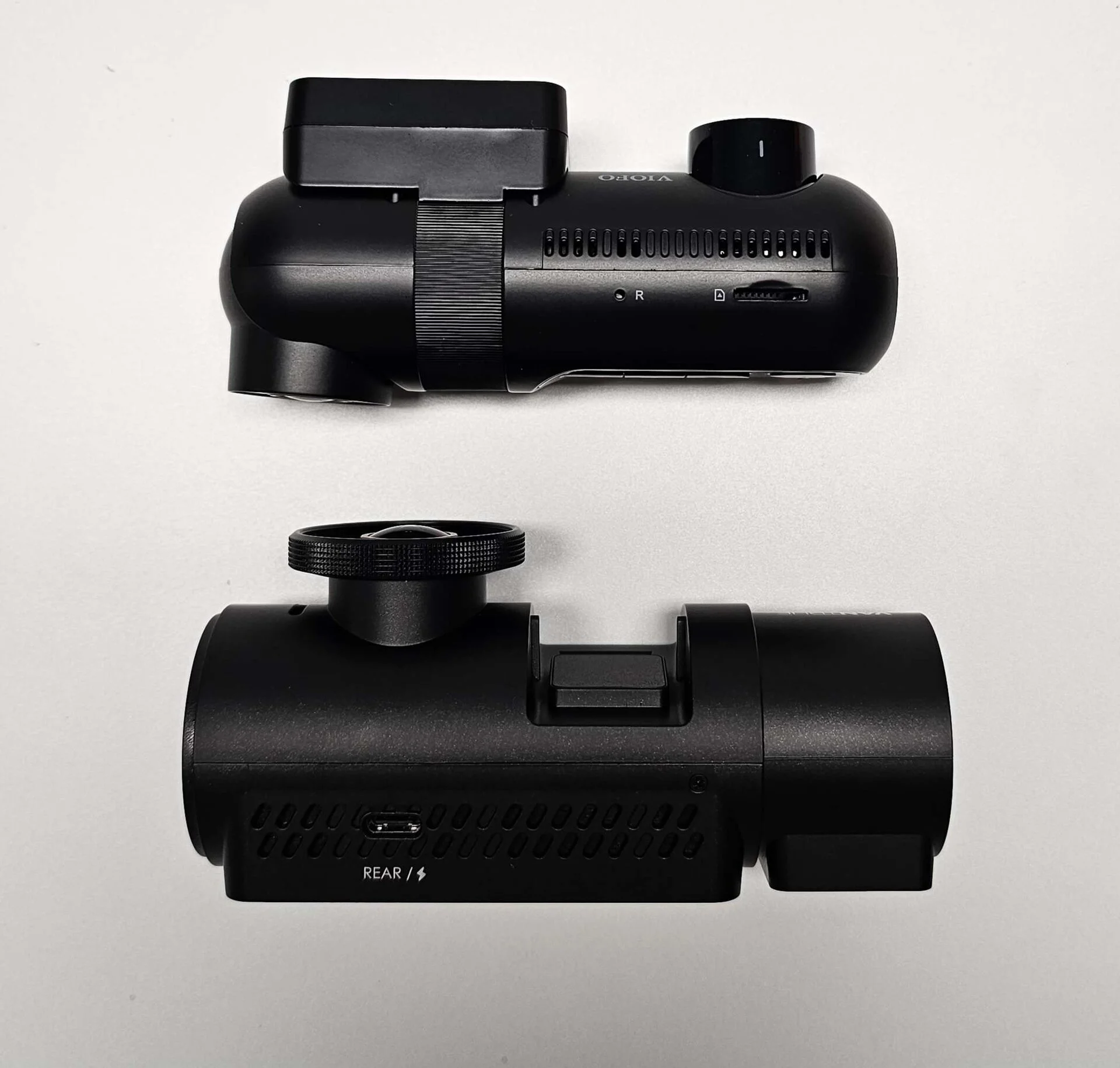

And some pictures compared with the Viofo T130:
The main unit feels very solid and the build quality seems good. The area around the lens could be a bit smaller to make the dashcam less noticeable in the car. But this is a design choice by the manufacturer.
The rear camera sadly doesn't give me the same feeling, the main unit does. The plastic feels less solid, the T130 rear camera has a better finish in my opinion. But the finish doesn't matter if the video quality is good.
On the rear camera of the N4 Pro, there is a small green LED that is constantly lit when the camera is turned on. You can't disable it in the settings. But the brightness is even at night low enough, that it shouldn't bother anyone.
The excluded CPL isn't simply pushed on but screwed onto the lens. This has a very nice haptic feeling. After being attached to the lens, the CPL can be rotated. There are two protective films on the CPL, don't forget to remove them.

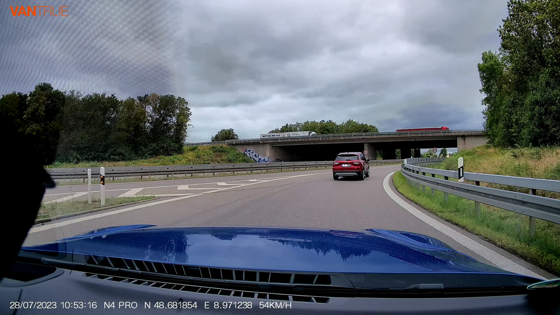

Here is a raw video straight from the camera. The settings are how the camera came, the firmware was updated to the newest version (N4P_VT-ECF211). No CPL was installed.
The sharpness at the edges is very good with my unit. No focus issues at all.
Here are some screenshots. All screenshots are unedited in sharpness, color, exposure, etc.
And a crop of the car. The plate is clearly visible.

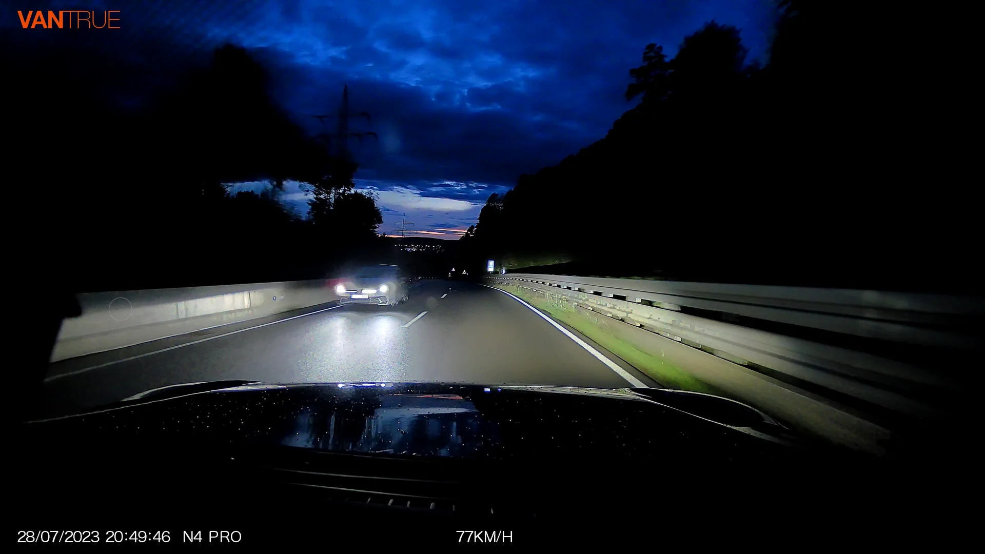

Here are two screenshots at night. Half of the plate is blurred by me to comply with German laws.:censored: It is fully readable when not edited.
Most of the plates at night are readable.
So far I am very impressed with the performance of the N4 Pro.
In my case, it is able to capture more plates than another Starvis 2 4K dashcam.

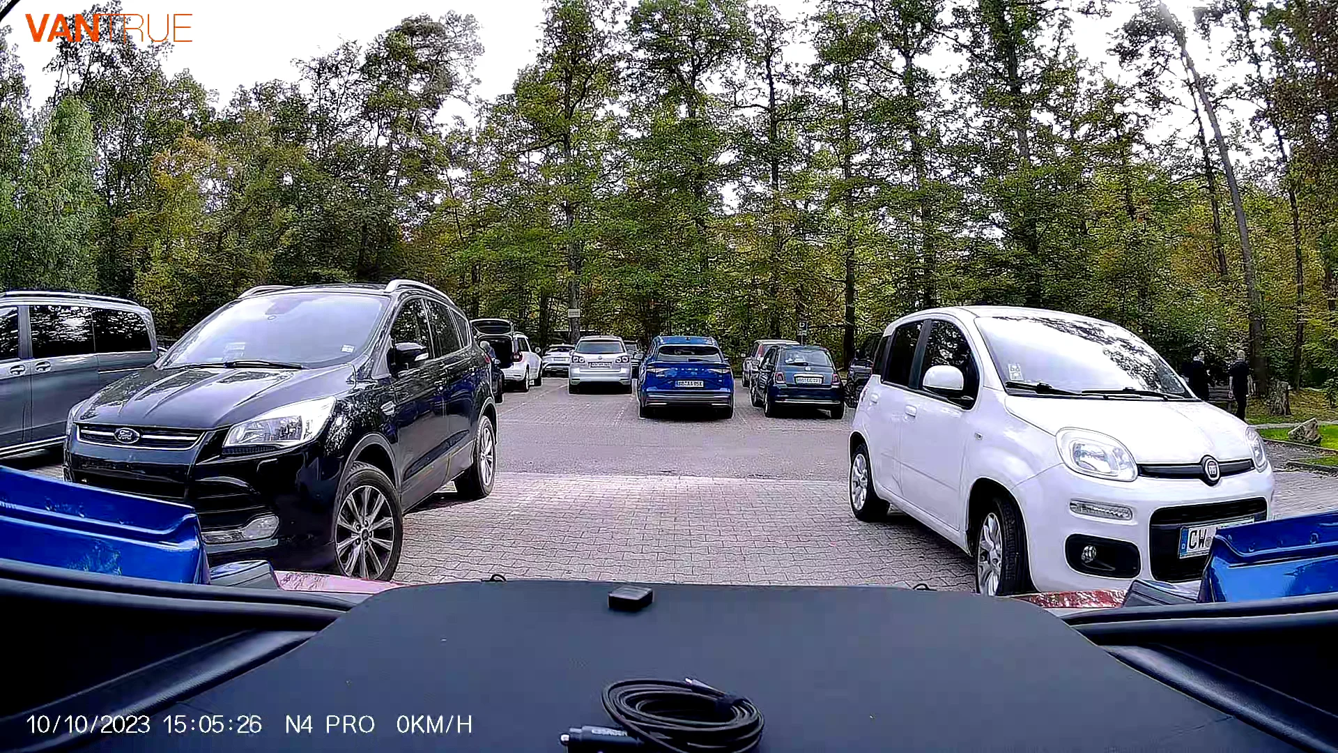

I compared the rear camera from the N4 Pro and the E3 since the N4 Pro has focus issues.
I took the same picture within a minute of each other.
I purposely placed a charging cable and the Vantrue remote in the camera's view to see how sharp it is.
The results can be seen below.
Here is the N4 Pro rear camera:
The focus is only usable within 2-4m. After this distance, it's not really useable.

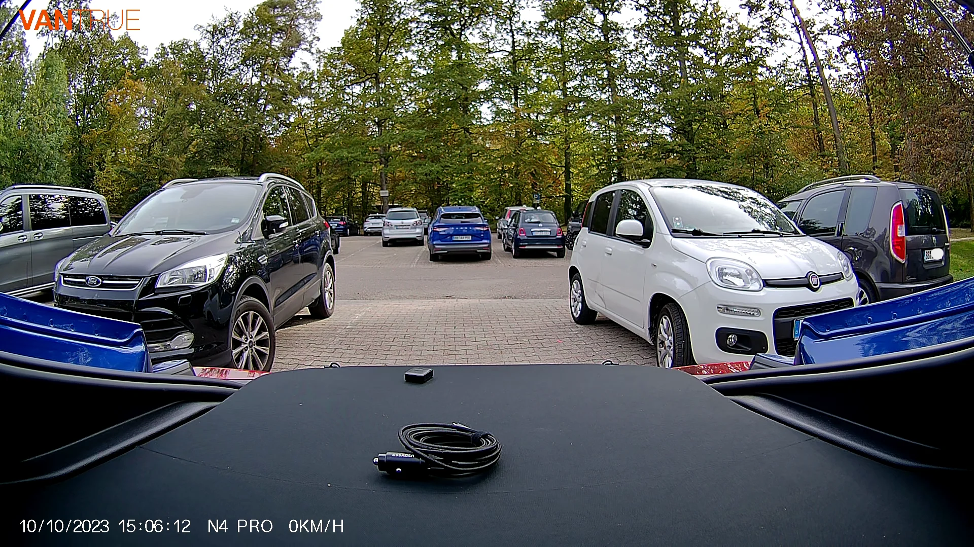

Here is the picture from the E3 rear camera connected to the N4 Pro.
The image seems sharper than the first one but after 10m it's not that good either.
I have contacted Jeff about the focus issue but haven't gotten a reply for several weeks. I don't know what happened to him.
Maybe will open the camera up and see if I can improve the focus.

It is telling isn't it. I still have my N4 Pro rear camera up in my car but the focus issue is glaringly obvious to all that see.
Looks like a bunch of us got defective units. Not sure where Jeff is these days either :(
