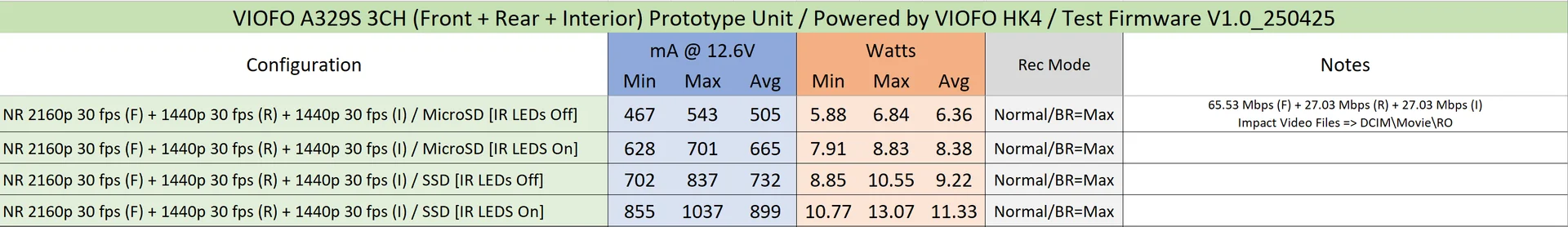

According to this chart I stole from you know who A119 Mini 2 max power consumption is around 3.5 Watts.
A329S 3CH max power consumption is closer to 15 Watts.
That’s almost 4 times the current / amperage.
The included power plug for the cam says its outputs 5V/3A. So that is max 15 watts then looks like.
