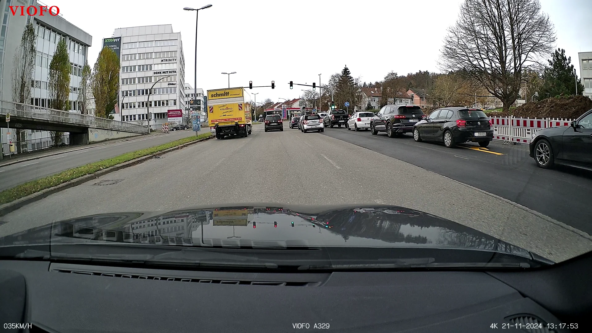

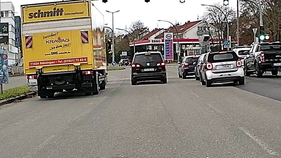

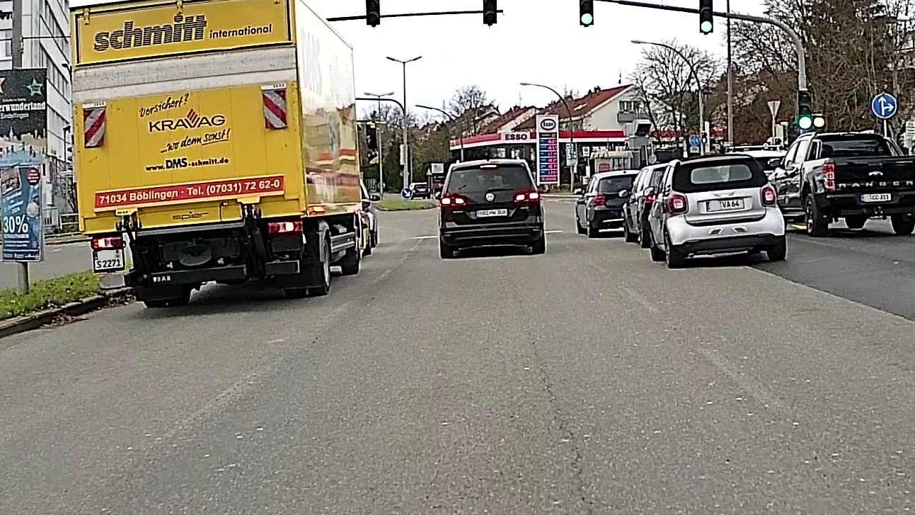

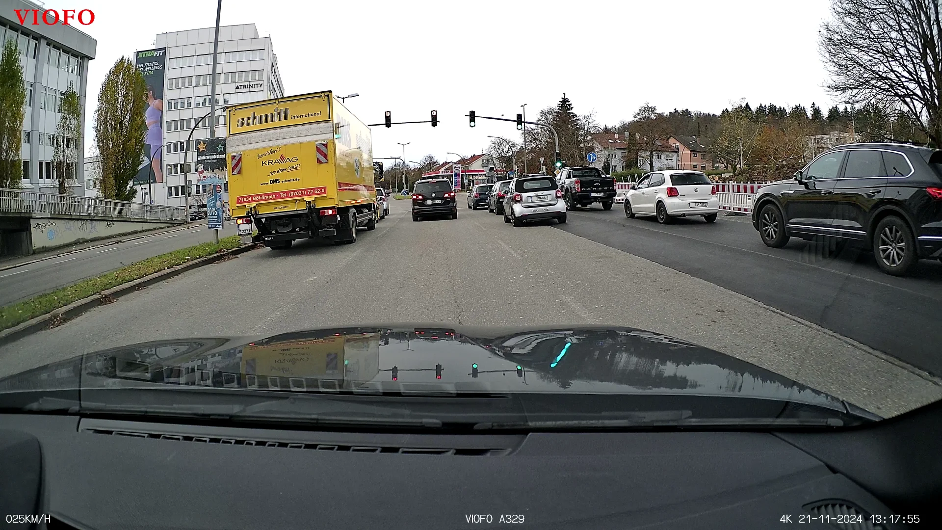

I gathered some more footage the last few days.
With the following clip I was wondering how far the A329 is able to read German plates.
A329: front: 4k30, HDR off, CPL on, highest bitrate, Firmware: V1.0_241009
The plate of the yellow truck and the Smart next to it can be identified with just around 22m distance.
The black car in the middle with about 28m distance can not be identified

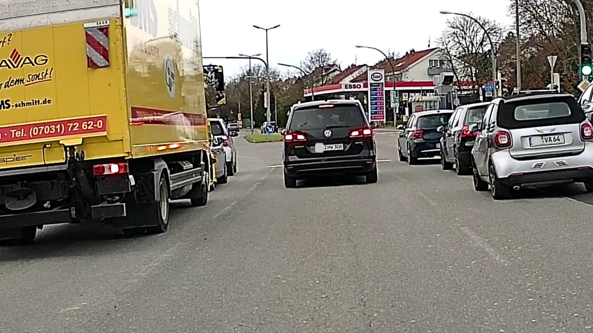

Now about 12m to the truck and the Smart. Both plates are 100% readable.
The black car still isn't readable at around 18m distance.
At 14m the plate of the black car is visible.
I am pretty satisfied with the results, even considering the not perfect weather conditions.

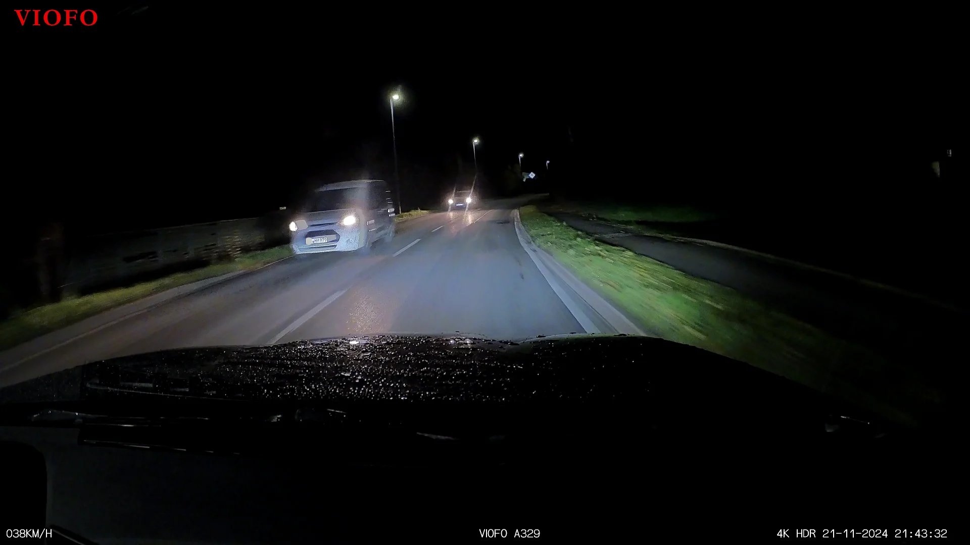

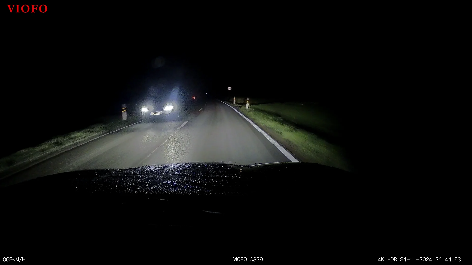

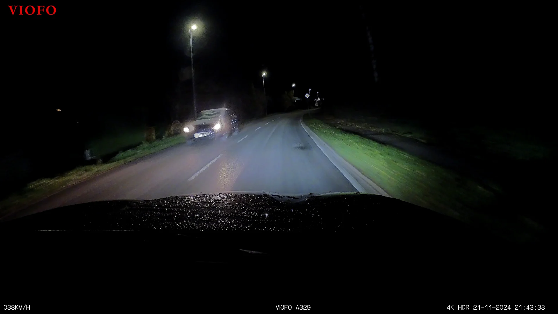

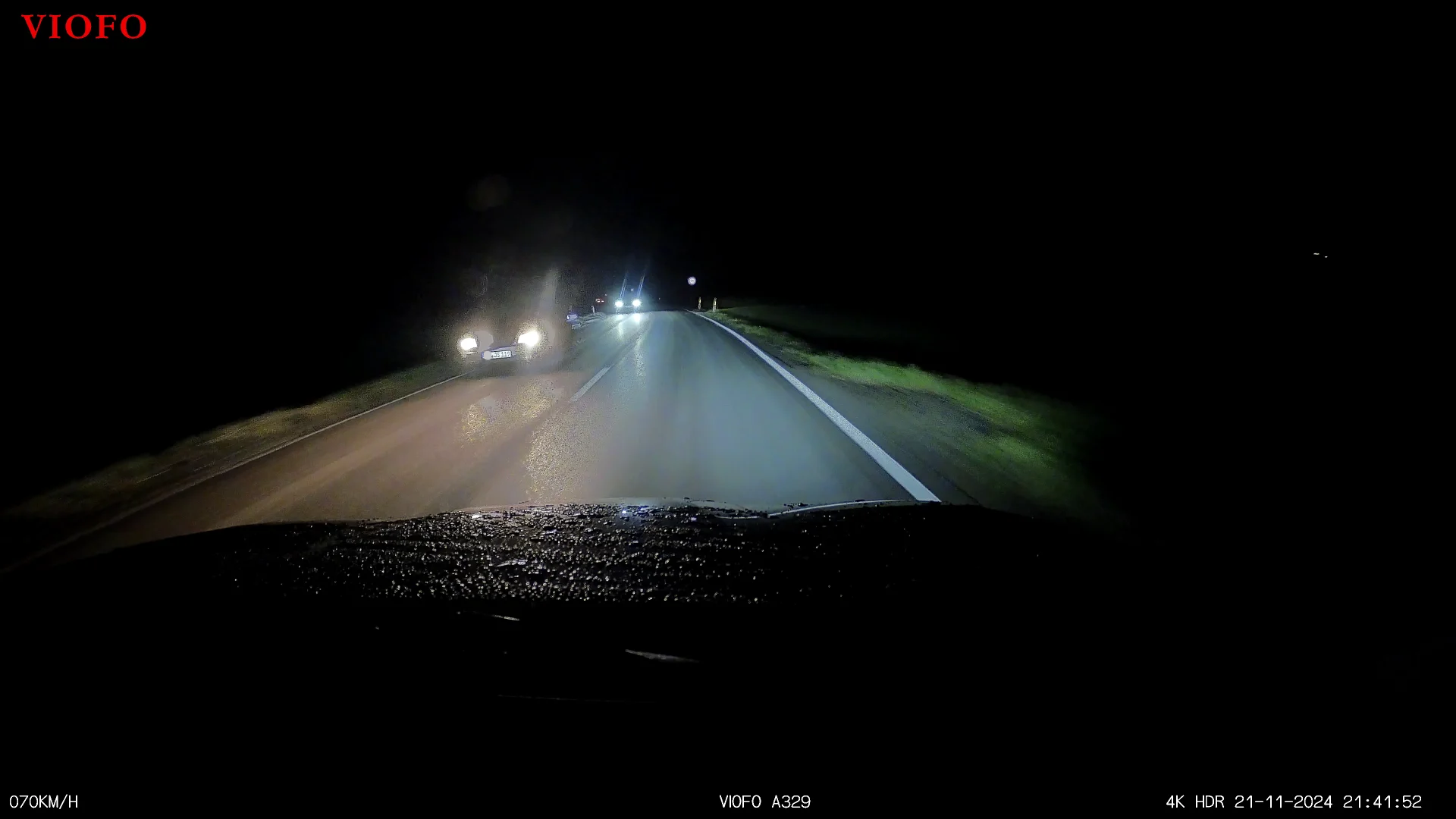

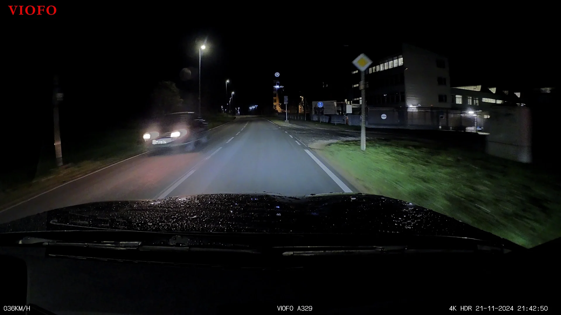

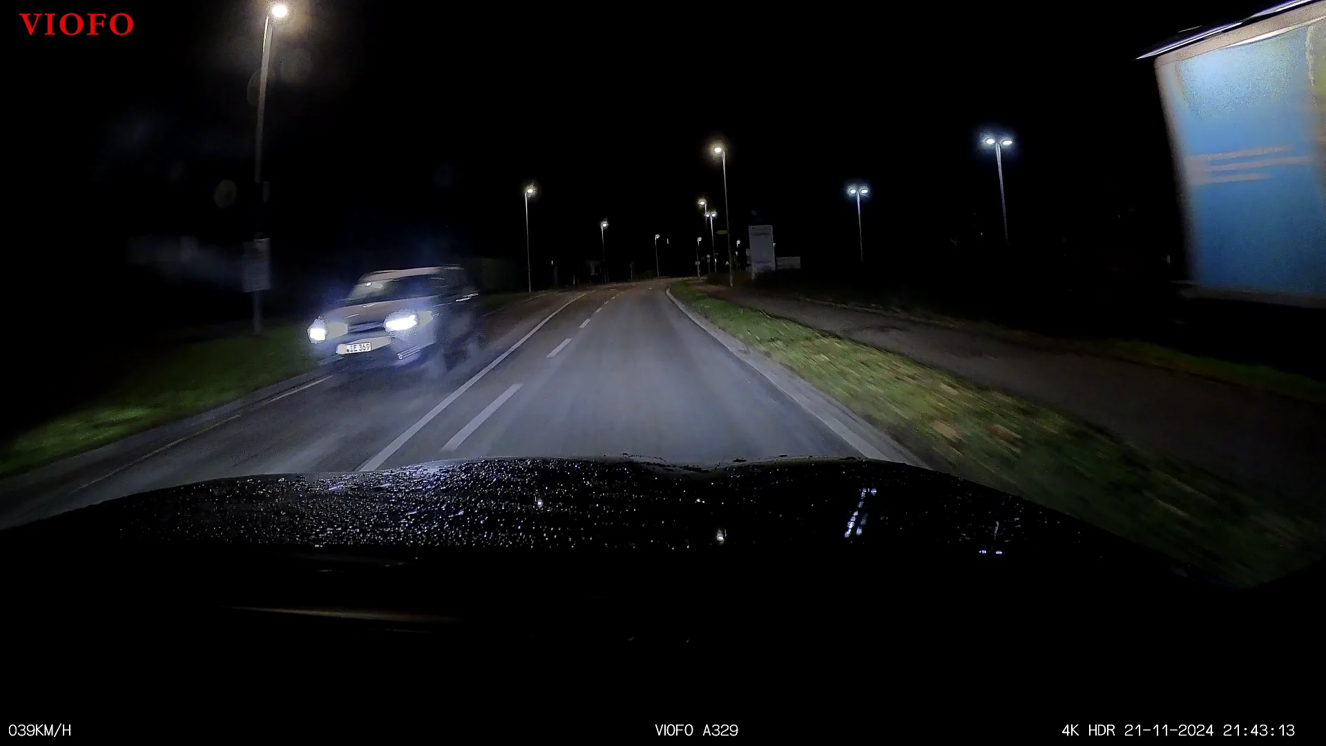

Night time screenshots with slightly dirty windshield.
A329: front: 4k30, HDR on, CPL on, highest bitrate, Firmware: V1.0_241009
The A329 was able to capture every plate of the oncoming traffic.
Plates are getting too easy, next challenge for dashcams is to capture the driver's faces in enough detail to recognise them!

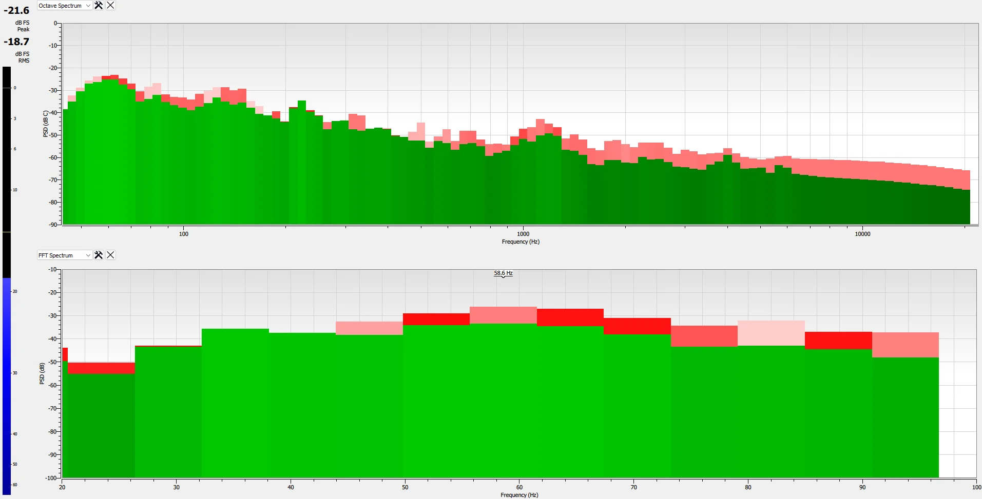

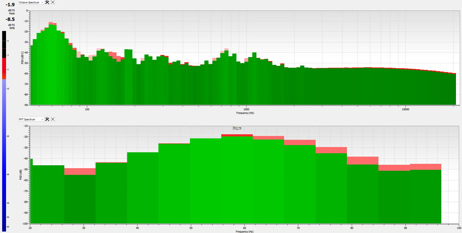

The latest firmware FWA329_V1.1_241227, did improve the audio quality with low frequencies. The distortion was improved. However, with some songs, I was still able to get some distortion.
The A329 volume is still lower than the audio from the A229 Pro.
The A329 does overall sound better than the A229 Pro. When directly compared, the A229 Pro sounds muffled.
A229 Pro V1.3.1_241206
A329 V1.1_241227
As seen above the whole volume level of the A329 is more than 10db quieter.
