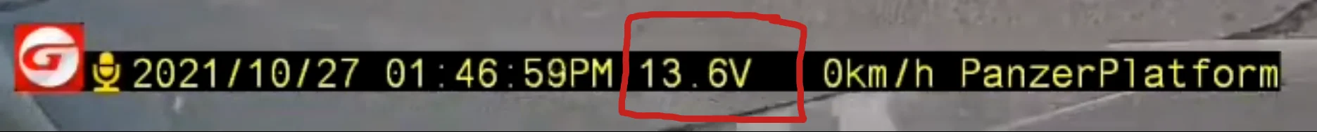

With new hardwire kit will be possible to display input system voltage in Text Stamp like Thinkware, BlackVue, Vueroid, GNET, etc?
Would this help diagnose power starvation malfunctions?
Interesting question.
Viofo has given you a thumbs up, so maybe it will, but a lot of the "power starvation malfunctions" are due to low voltage on the 5V, not the 13.6V that you are showing. The 13.6V is useful for watching the battery state of charge, a low voltage there is not a malfunction, it is simply an empty battery, or your alternator not working, which would be a malfunction!
I’m so dumb. lol
I meant to say parking mode malfunctions, (like shutting down prematurely).
It will be nice to see the input system voltage steadily drop on the recorded footage to confirm the camera is shutting down correctly based on the desired low voltage cutoff when connected to the vehicle’s starter battery.
Or when the low voltage cutoff is disabled when connected to a dash cam battery pack.
I’m so dumb. lol
It will also be interesting to see why Viofo has decided to add a voltage monitor to their hardwire kit, I don't expect the main reason to be so that you can watch the display... assuming that the thumbs up is actually an acknowledgment of course!
