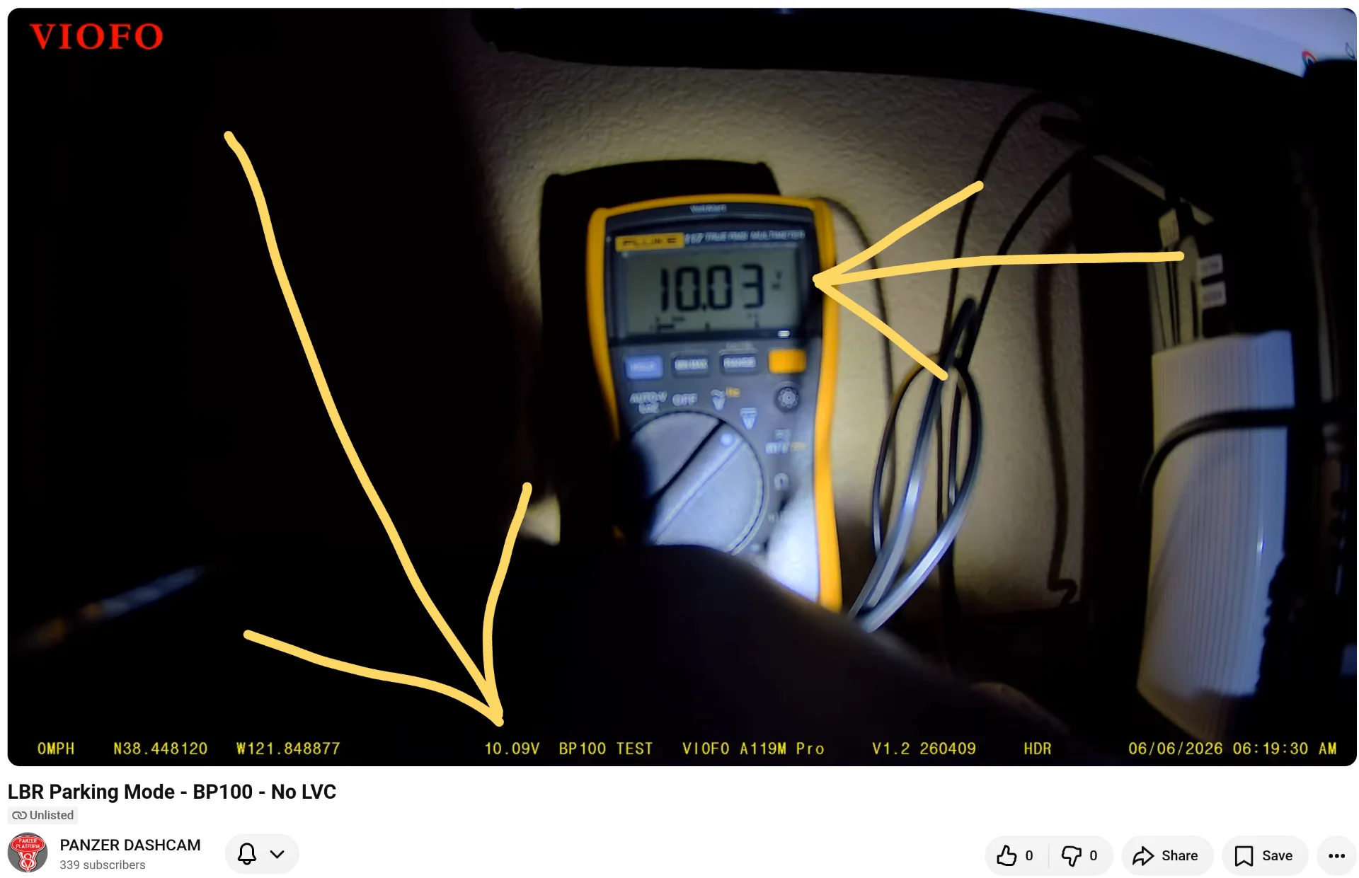

I love this.
Here's what it looks like @joysleep

So what's this actually showing?
I fully discharged BP100 with A119M Pro in Low Bitrate Parking Mode with modified HK6, (No Low Voltage Cutoff).
12.4V setting = No LVC
It shows BP100 delivered power down to 10.02V (Fluke 117) or 10.09V (HK6).
If a “standard” HK6 was used, power to the camera would have shut off when BP100 falls to 11.8V, (when selected).
This shows why you may want to use modified HK6 to fully utilize BP100’s capacity.
11.8V down to 10.02V is approximately 4% of BP100's 98Wh capacity or 4Wh.
4Wh may not sound like a lot, but now that we have LPID that means approximately 8 additional hours of “stand by” in LPID.
4Wh ÷ 0.5W = 8 Hours.
Since I was there it was obvious to me, but now I realize it’s confusing without a proper explanation.
Sorry for the confusion.
Oh right
No apologies I'm the one who's confused.
